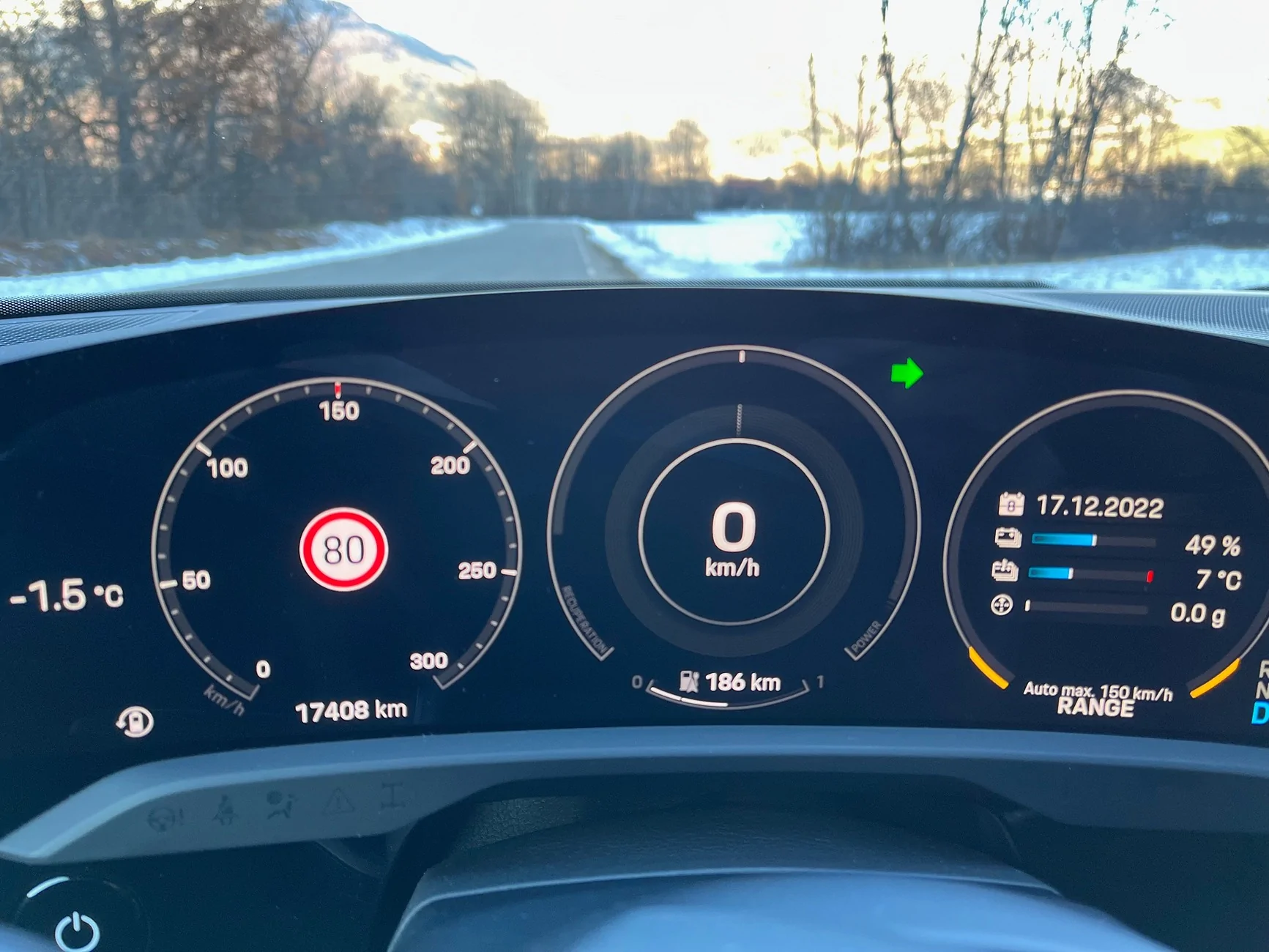

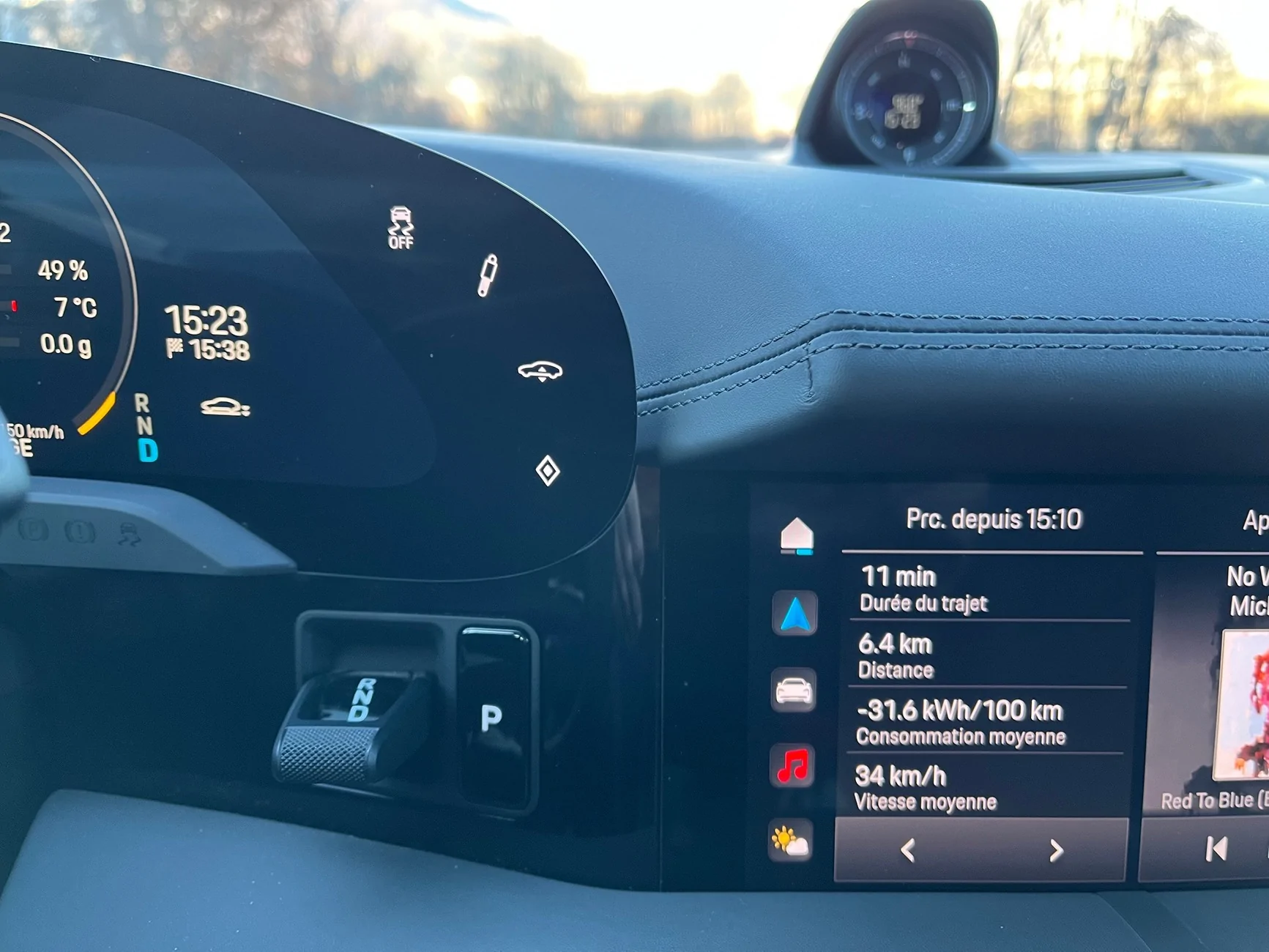

Yes , the SOC display can change with regen.
As said @Jasper4S , the displayed SoC is calculated with margins but if the descent is step and more than 500 m, the displayed SOC will change.
For my J1 Taycan the gain was about 1% for 300 m of descent.
Porsche Taycan Does regen change battery SoC %? Downhill Ceuze Ski Resort 550 m
Here is a screen shot of the regen energy after a 550 m descent at low speed (because of corners, winter and snow) , even with low temperature.
Unfortunately, I didn't take a photo of the SOC before the descent, but the display had increased.
The calculation shows a gain of 2 kWh.

Porsche Taycan Does regen change battery SoC %? IMG_6213
