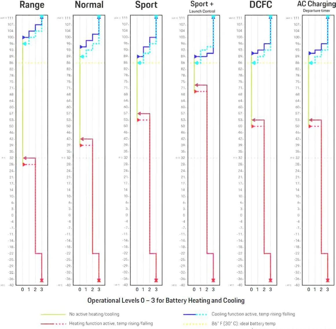

It is activated when the battery temperature falls below 50F while charging, higher level of heating kicks in at -22F.
The DCFC chart seems to imply that cooling starts when battery temp is above 86 - 90F. Why then does preconditioning often raise battery temp above 95 F or higher? Over heat it, then spend energy cooling it?

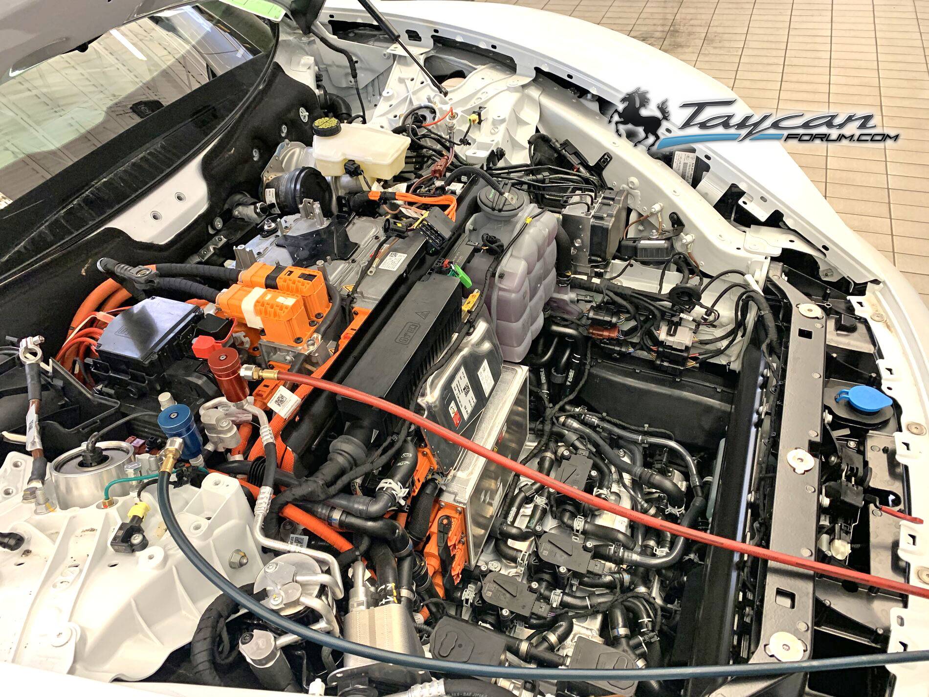

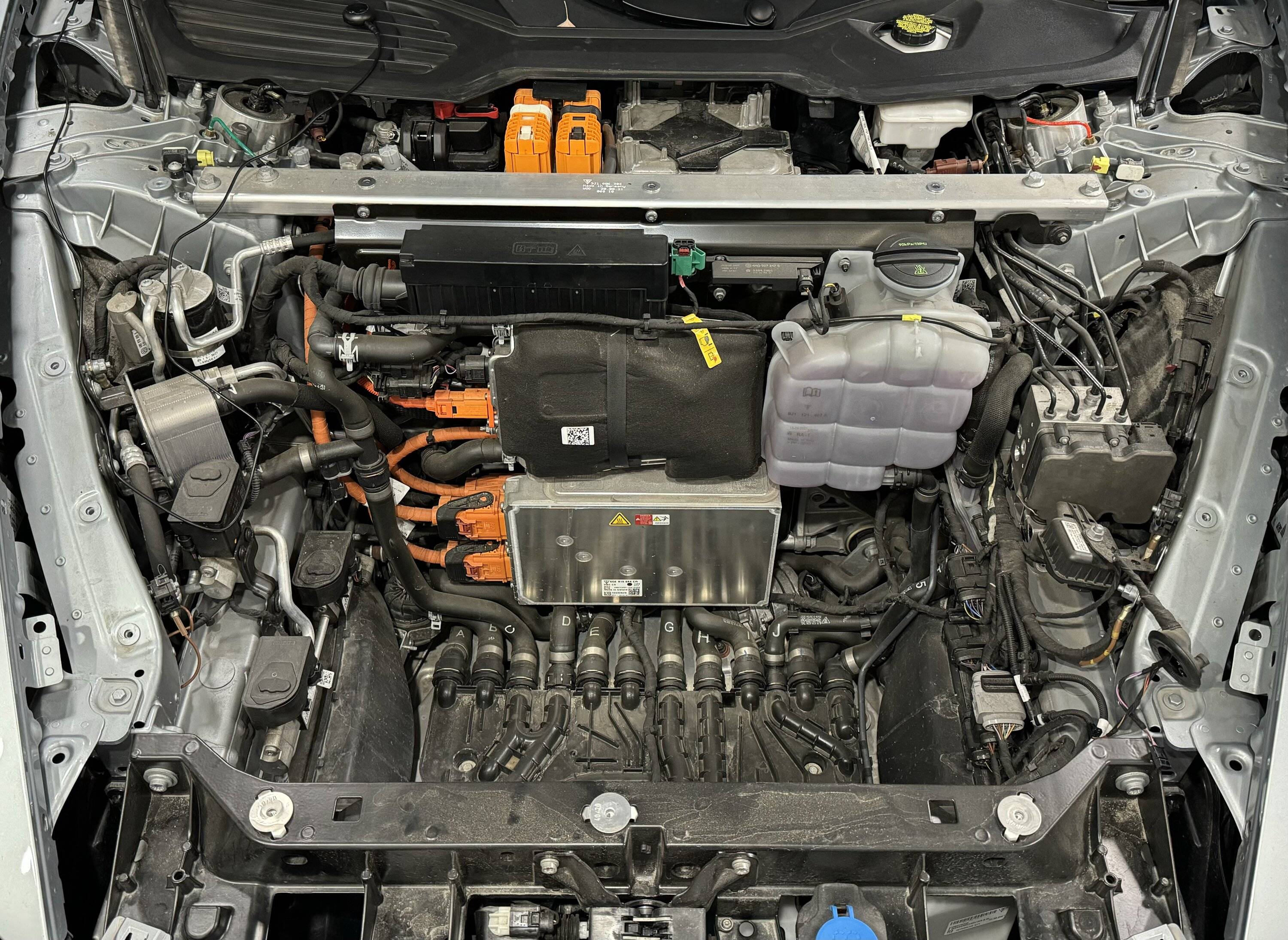

Never ceases to amaze me how much technical information is out there for our car. Here’s a picture of the coolant manifold if anyone wants to match the diagram to the physical parts.
They weren't always so neat. The first two years of Taycan, they looked like this – which was nicknamed the "rats nest" by the designers.
Discrete valves to a monoblock design. When did they change that in production?
Dare I say it out load, is this Porsche’s take on the Tesla octovalve?!
My understanding was for MY22.
This chart is for 2020 Taycan Turbo(S). They might have adjusted the threshold since, especially given a new battery chemistry in 2021. However, is is also possible that the car preheats the battery to 95F, then starts cooling it as soon as fast DC charging starts in anticipation of fast charging dumping a whole lot of heat into the battery fast.

DCFC = DC Fast Charging - Either pre-con (en route) or during the actual fast charging session - battery is heated up to around 34-36C (whatever that is in Fahrenheit) before full DC power is allowed to be unleashed.
whitex's chart above and my own experience is that the Webasto heater heats to your number 36C ( 97F) pre-con, en route, or even a bit hotter (I've seen it go to 38C (101F)). But if you plug into a DCFC with a cold battery, the Webasto will heat it only if it is below 10C (50F) and kick off if it gets above 12C (53F) and let resistance heating take it from there.
Launch control isn't "always on" for any Taycan variant. The battery needs to be 'goldilocks' warm to discharge effectively at high rates as well as recharge at high rates. It's just the way it is with lithium chemistry.
My mistake. I see now that the "launch control" in whitex's Sport+ column is only a note, it is the "+" in Sport+ that triggers battery heating. I guess that means for my base Taycan I would have less ability to heat the battery to prep for my lauch control because I don't have Sport+.
It seems they have increased this preheating temperature with the last big uPdate, when the changed the icons etc.
I regularly see the battery temperature raise to 40 C on a long trip, prior to Ultra fast charging. If that comes from the heater or just reduced cooling of the battery, I have no idea, but should be visible with CarScanner? And my car is 2020 so only SW change since new.

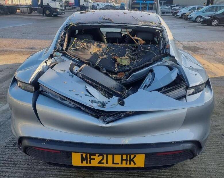

Complete tangent, but the car from this listing seems to have some unusual damage - hit from above in the rear. Parked under a construction crane? Lose load from a braking truck behind? Crazy ex-wife in a forklift? The heater should be all good though.
Looks like something drop from the space to the rear.o_O
