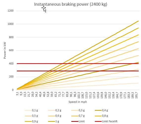

It's just a bit of physics and math:
Porsche Taycan Why doesn't regen damage the battery? 1000076172
Porsche says they recuperate up to 0.4 g. You'd hit the power limit when doing that kind of braking only at 130 mph.
The power requirement for normal braking at normal speeds is not an issue for the battery.
If it were, the system will limit the regenerative braking to acceptable limits and apply the normal brakes instead.

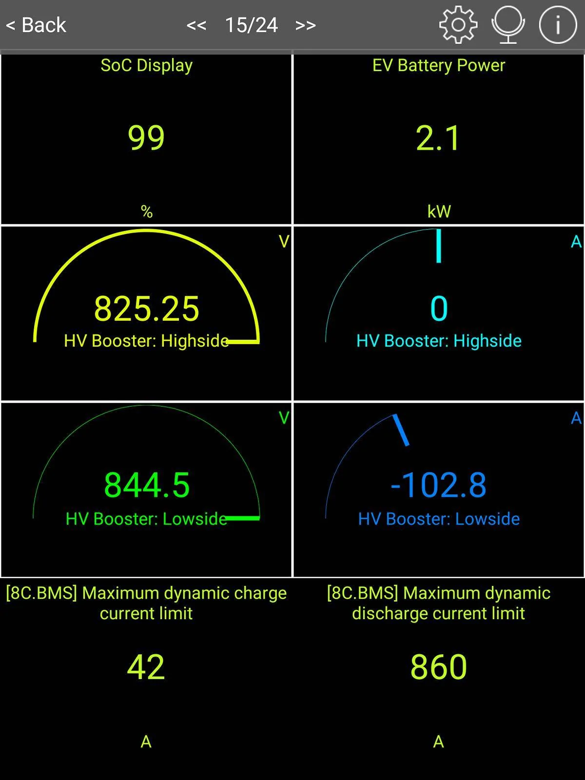

I read that Taycans can regen as much as 290kW. If the battery isn't preconditioned and warm, why is this power level not damaging it?
Can regen up to 290, doesn't always regen at 290 kW. If you look at the power meter on the dash, you can see the limits displayed there graphically. If you use an ODB dongle and the car scanner app you can see the maximums numerically. If the battery is very cold or very near full charge you can see the reduction in maximum regenerative braking.
Porsche Taycan Why doesn't regen damage the battery? 1718914095533-dk
As for the heater, it draws 10 kW. It's not doing much to absorb power during braking.
