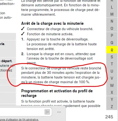

Charging doesn't stop to the 80% limit set.

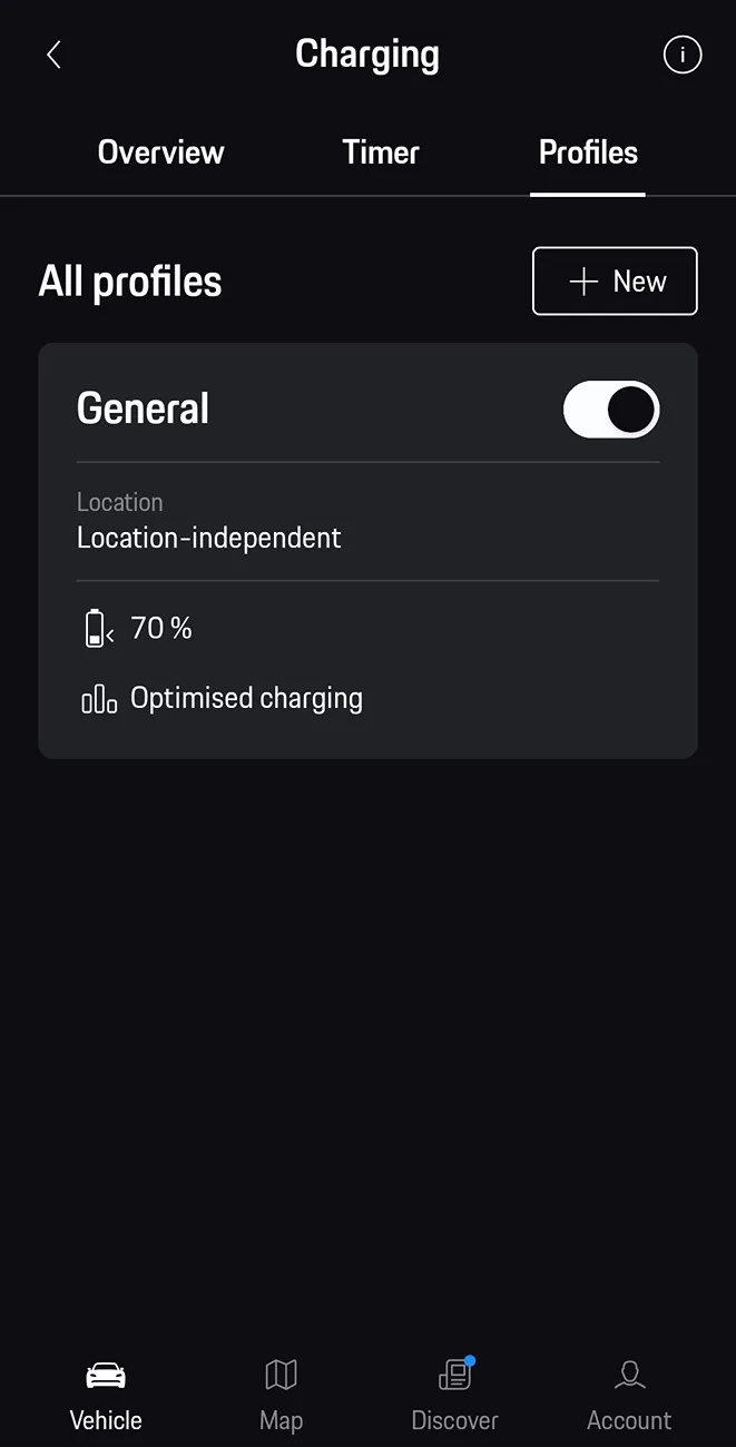

For future readers, the easiest way to charge to 80% max is to:
1. Have no timer set
2. Set the general profile to 80÷ "minimum" charge, location independent, and use the option optimised charging. This will charge up to 80% when plugging in. It will still charge to 100% at fast charge stations or if you click "direct charging" when charging.
note 1: Why does this work? The optimised charging setting will communicate with a "smart" charger to only charge during certain times. Since 99% of all EVSE chargers are "dumb" this will only charge to the 80% "minimum" and then stop (as the charger will not give any "charge" commands).
note 2: If you still like to only charge during certain times of the day, then, in my opinion, it is easiest to set up a time schedule on your EVSE charger instead (that is, if your charger supports that). This will still respect the 80% max and the car just only gets electricity during the time schedule set on the EVSE. I use this charger for example.
