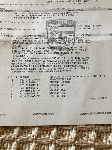

I have a 2020 4 S that suffered sudden range loss in one week with no error messages. I brought it to the dealer and while they troubleshot the HV battery died. They told me because it was a 2020 I would be getting a re-manufactured battery purportedly of 2023 design. The whole thing took about a month.
That's great news! You have a fully updated battery/cells. They are trying to keep mine a mix
Tried to get a replacement for mine but they just swapped 13 cell modules. With that it’s almost been a year and the battery hasn’t had any problems.

I have just experienced range loss with my remanufactured battery that was installed in July. My dealer is recommending the battery be removed and sent to the Oklahoma facility for repair of the offending cells. 3-4 weeks estimated repair time. This is apparently being done under one of the cell recalls. Stay tuned.
