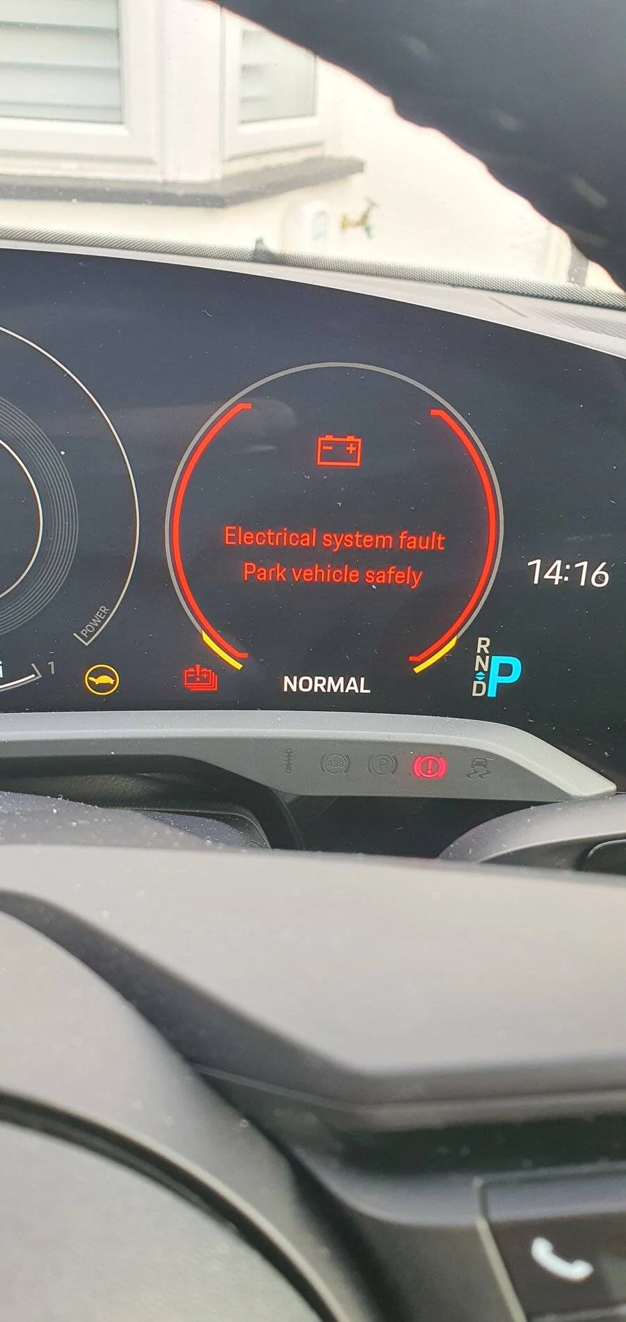

Hi Guys,
My Taycan 4s done around 2000 miles and received the Red Electrical System Fault Error around 3 weeks back. The issue occurred after my car was left overnight on AC charge. When I came to drive the car it wouldn't start. Porsche have had the car for the last two weeks and delivered my car back to me a few days back. The advised they had done a battery calibration and advised the 12v battery had drained causing the issue.
I didn't drive it but when they delivered it back, when I tried to drive the car a day later the same warning light appeared and the car wouldn't start.
It's now gone back to Porsche and they have now advised they need to change the main HIGH VOLTAGE BATTERY and not the 12v battery as you all have suggested. Service advisor indicated that one of the cells within the battery maybe defective as it wont calibrate again. Ive now been without my car coming up to 4 weeks, i'm currently waiting for a new battery to be delivered from Germany and the car needs to go to be towed to another dealership that has the capabilities of removing the main HIGH VOLTAGE BATTERY. ( with a double bay service area and two fork lifts) Service advisor has also mentioned he has had another Taycan with the same issue and Porsche replaced the main HIGH VOLTAGE BATTERY.
Ill keep you guys informed but thought ill share this with you all as it maybe a new advisory from head office.
Cheers Guys
Regards
Alex
