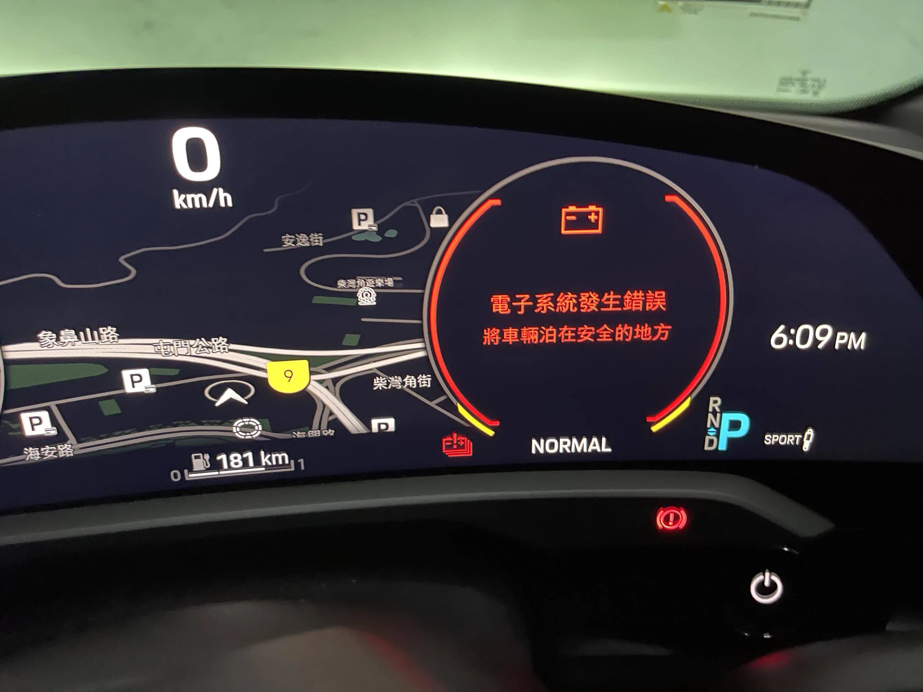

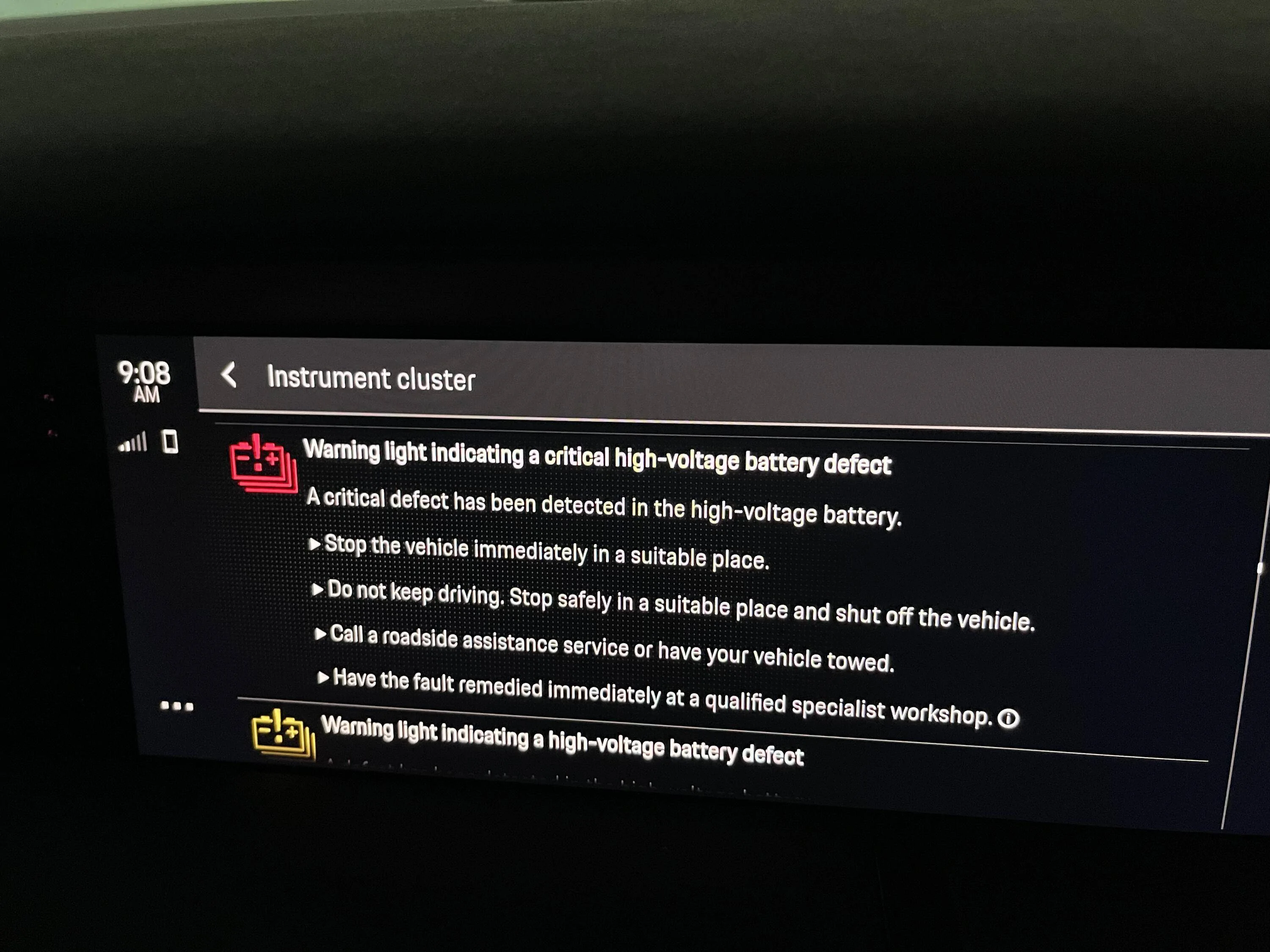

I had exactly the same problem like yours. I was lucky that the car is park in my garage in the morning and try to use it after work then it show the red warning “first time I saw” then it is not moveable and not charge as well. I have no choice but just call the service to tow it away next day.
My Taycan was preordered in Hong Kong and received it in Nov 2020, since then the car has a lot of big and small issues. The most frustration problem should be this one “Warning light indicating a high-voltage battery defect”. I recall the first time it pop up is during mid of 2021 which is only yellow warning light and the car is still move like normal. I immediately contact Porsche service but their reply is “That’s normal system upgrade message and nothing to worry about and no need to return for service”. The warning signal then turn off next time I drove the car since then this signal pop up once or twice a month all in yellow colour until 2022 July I decided to have a complete check up again. After it back to service I haven’t heard from them for more than two weeks, then I decide to call and find out there are at least 5 other Taycan has same issue. I asked for solution but the Porsche service reply “This is a very new car and we don’t know how to fix it! And need further instruction from Germany.” Oh my god, I paid an expensive price for a car they don’t know how to fix it and have to sit in the service centre indefinitely that’s the basic idea I received from the technician. So I request to have my car back as the service centre said the Taycan is safe to drive anyway that just a warning signal. I had it back for three weeks with the yellow warning signal always on this time until two days ago it show red signal and completely dead. Now the service centre told me the car warranty is about to expired…. WTF they talk about the car is on and off in service centre for almost two months with issue they don’t know how to fix. And the first thing they told me is the warranty about to gone?! That’s the Porsche after sales and service in Hong Kong, anyone considering or already preorder Taycan think twice don’t buy!

Thanks for your reply, do you have the global CEO of Porsche contact?

I am sorry to read that you have the same issue. To my knowledge the high voltage battery has a much longer warranty.

Yes but that's only for the battery and seem like the service center in Hong Kong has absolutely no idea what's wrong with my car although it said clearly it is the high voltage battery defect. It might related to the cost so they don't want to fix it.
