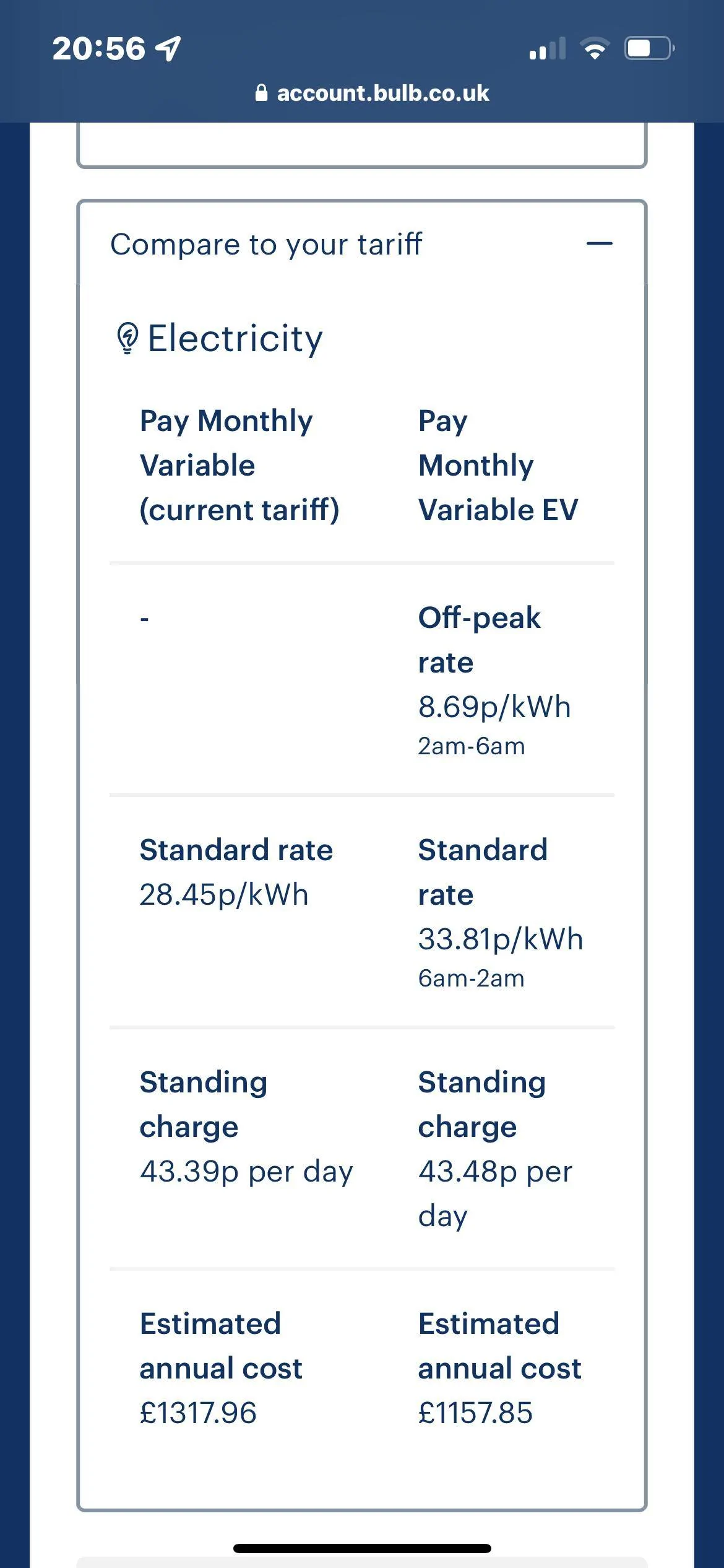

I’m with Bulb on their variable tariff. They estimate this is what I’d pay annually if I switched to their EV tariff. Their assumption is that I’d use 37% of my electricity between 2am-6am which is odd given that’s only 17% of the day? Anyhow, I need to do the maths as I’m obviously using electricity from 2-6 and when I do start charging the car on top…(expecting delivery in September).

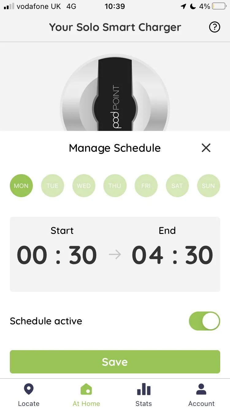

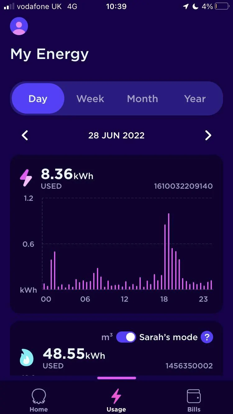

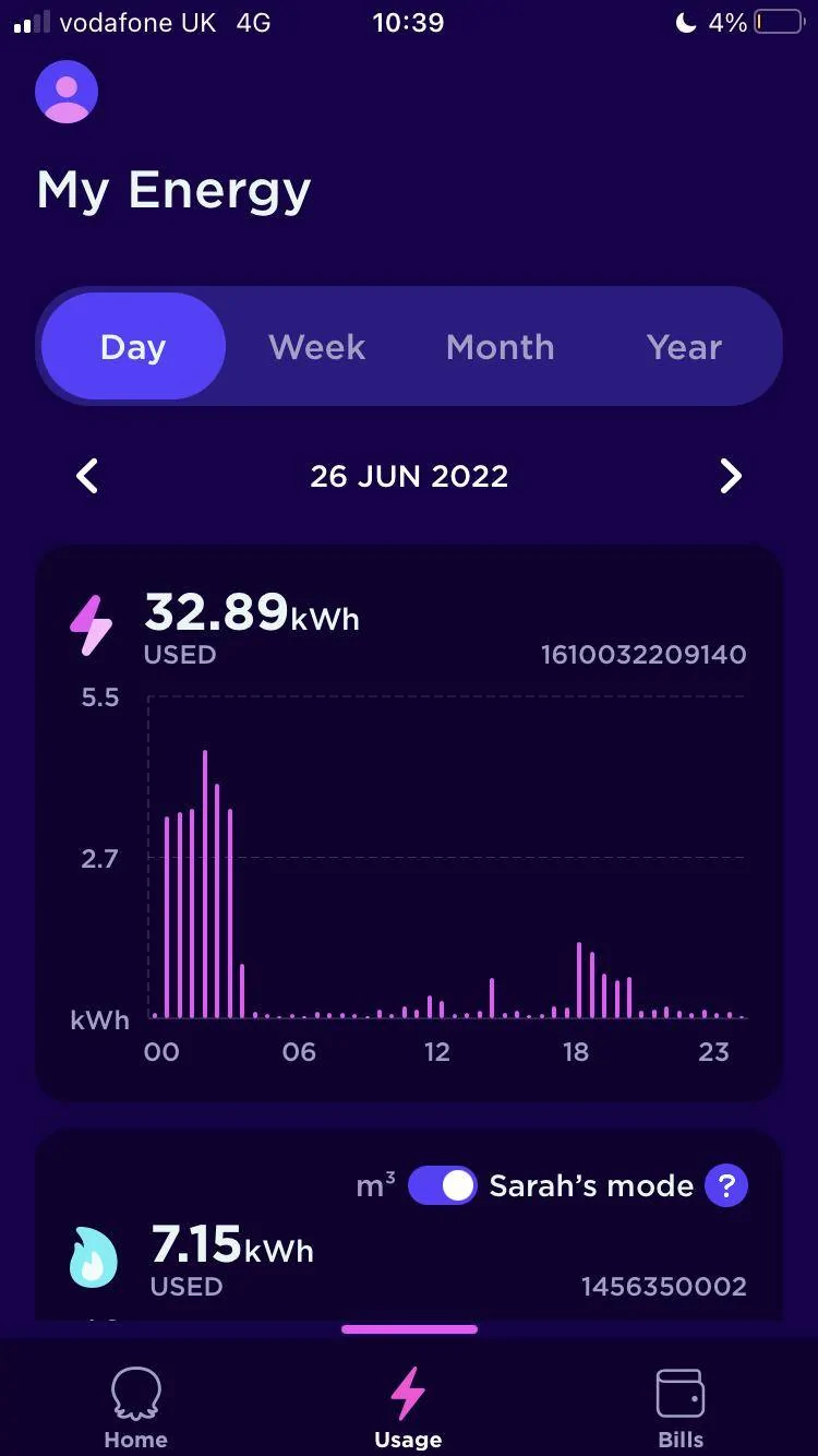

‘Always be charging’ should be
‘Always be charging between 00.30 and 04.30’
Octopus Go is a massive saving over regular tariff.
I have been Go customer for 2 years.
I have Taycan and Etron.
Combined 15,000 miles a year.
95% charging cheap rate at home.
I am still on 5p/15p at the moment. Going to 7.5p/34p soon.
My cars are ‘dumb’
Podpoint charger only allows charge at cheap rate.
I consistently use 8kw a day expensive rate. That will cost me 50p more a day over a 28p standard tariff.
When I use 30kw at night charging cars and using washing machines I save £6.
I charge my cars much more often than every 12 days so the savings are huge!

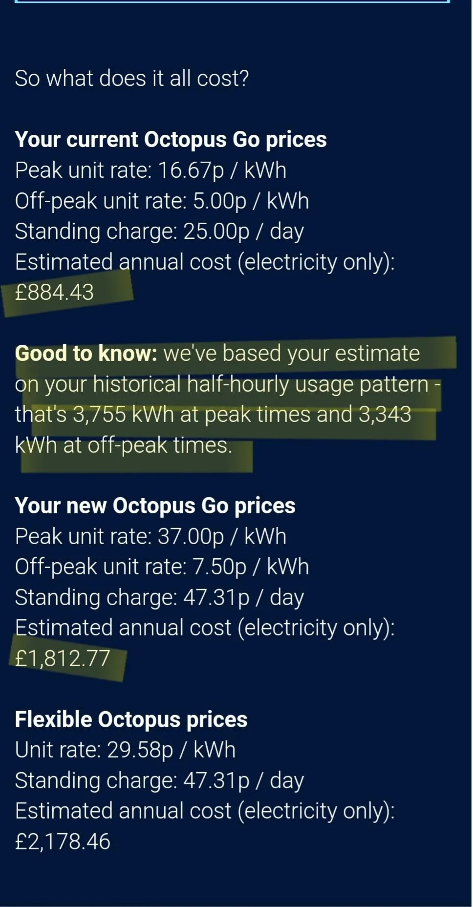

I actually switched to Octopus Go exactly when I got the car and its due for renewal on 8th August (attached).
Gas is a separate contract.
The interesting thing is that charging the Taycan is nearly half our annual electricity usage!

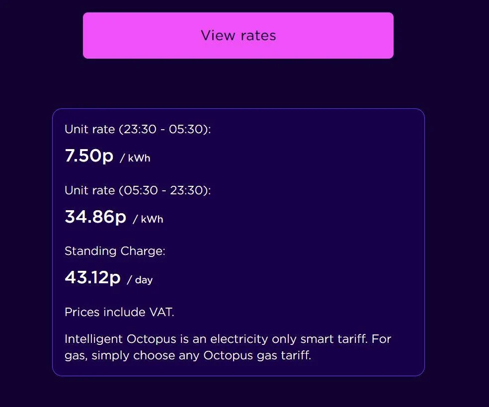

So I switched to Octopus Intelligent a few days ago after doing the maths, here's some observations;
1) An overnight charge of 69kWh cost £28.68 on the 33p previous tariff, after the switch the next charge was a 92kWh charge for a long trip that cost £9.21
2) The Ohme app does the management, so it tried to fully charge between 11:30pm and 5:30am but knew it wouldn't hit the target SoC so used the higher rate of 41p before and after the 10p 6 hour period.
3) You need to set a timer in the Ohme app to manage it, I'm not sure it really checks the SoC with the Taycan as the API isn't currently supported - going to try an 85% charge tonight and see. Taycan is set to Direct charge but maybe an 85% profile might switch off the charging?
4) You can only get this rate from Octopus if you have an EV, Smart Meter and up to date mobile device. They do a test charge after the switching process has started to ensure you have all the required components then they settle your existing electric bill and switch you to the new rate.
5) Adding a battery as part of a solar install would enable you to fill the battery at 10p rates and use it during the day, of course you don't need solar, and the ROI might still be a few years...
6) Still worthwhile to set timers for washing machines etc to run after 11:30, this does requires some careful dialogue with the person in charge of the domestic processes as they apparently have existing routines...
7) It's still in Beta, they use some back end control software (Kracken?) and don't have many APIs currently, also limited charger support.
Time will tell if this was a good choice or not, regardless my experiences with Octopus have been great, they are such a contrast to the way utility providers behaved before. I have also had a quote for solar and battery from them which seems reasonable (£10k)
