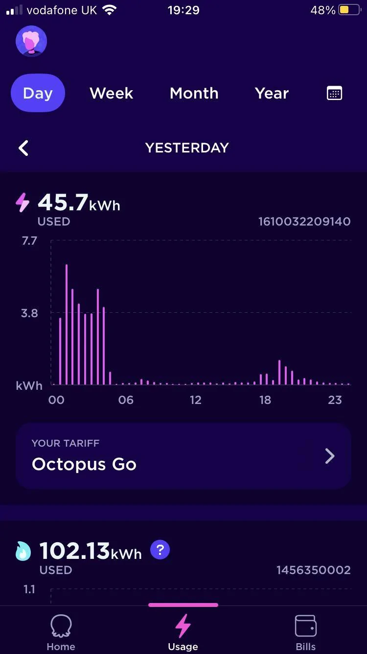

I am 100% happy with Octopus Go but that is because my average mileage is much less than the 60 miles a day that I need 25kw a night in my 4 cheap hours.
I also run underfloor heating, washing machine and dishwasher and charge all devices between 00.30 and 04.30.
I use up to 40kw at 7.5p and as little as 5kw during the day.
The screenshot is yesterday, Monday 20th March.
Don’t write off Octopus Go. Focus yr mind on using electricity in the cheap 4 hours. I NEVER charge my car outside these hours and never wash bedding at high temperature or run a dryer.
So 7.5p night rate compensates +++ for the 34p day rate +++ for me.
I have read that the OVO cheap rate can be as little as 10p but it seems a bit flexi/random.
What is the higher rate with OVO?
How much less than 34p is it?
Cheers
