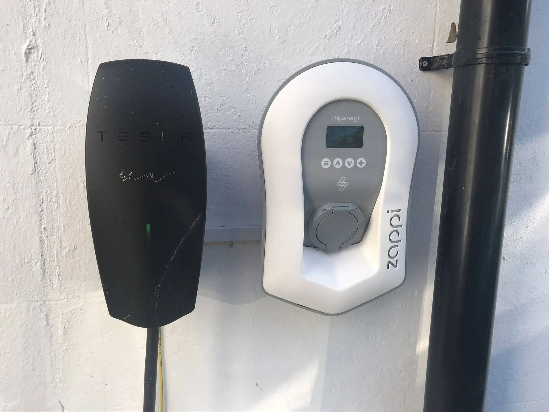

Basically, you can fit anything. With my new house, I got the electrician to fit a Tesla Wall Connector (free referral) and a Zappi. If you have a company EV like me, you can charge the cost of the units and the installation to the company. Most EV chargers do require a separate earth rod but the Zappi 2 does not.
