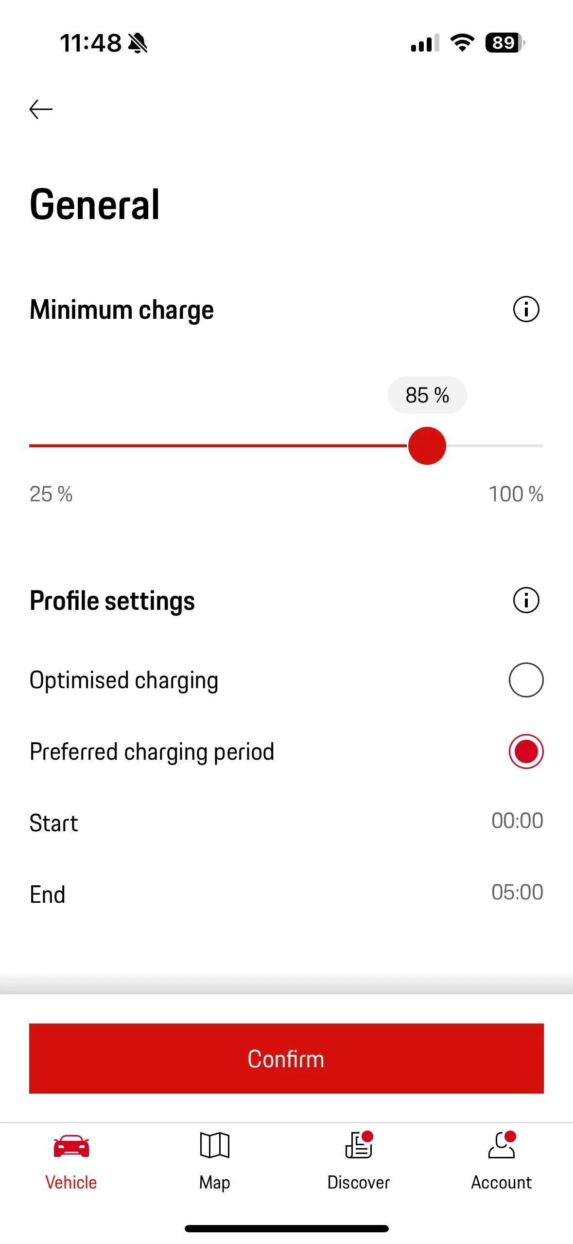

I'm in the UK and have just had my charger fitted. Its the OHME Home Pro.
I am on the British gas ev tariff where I get cheap leccy between 12am and 5am. Here's what I want to do:
  1. Get home from work and plug the car in.
  2. The charger will start magically at 12am and charge to a max of 85%
    • If 5am arrives and I have not got 85% it will stop
    • If I get to 85% before 5am it will also stop.
I will generally use less in a day than I can charge in the five hour window so if I do a long run I can top it back up to 85% over a number of nights within my cheap charge period.
What is the best way of achieving this? I cant seem to find a simple 'profile' settings to do this in the app?
Can I set 'minimum charge' to 85% and preferred charging period to 00:00 / 05:00? Or as this is a minimum it will continue to charge past 5am to get to 85%?

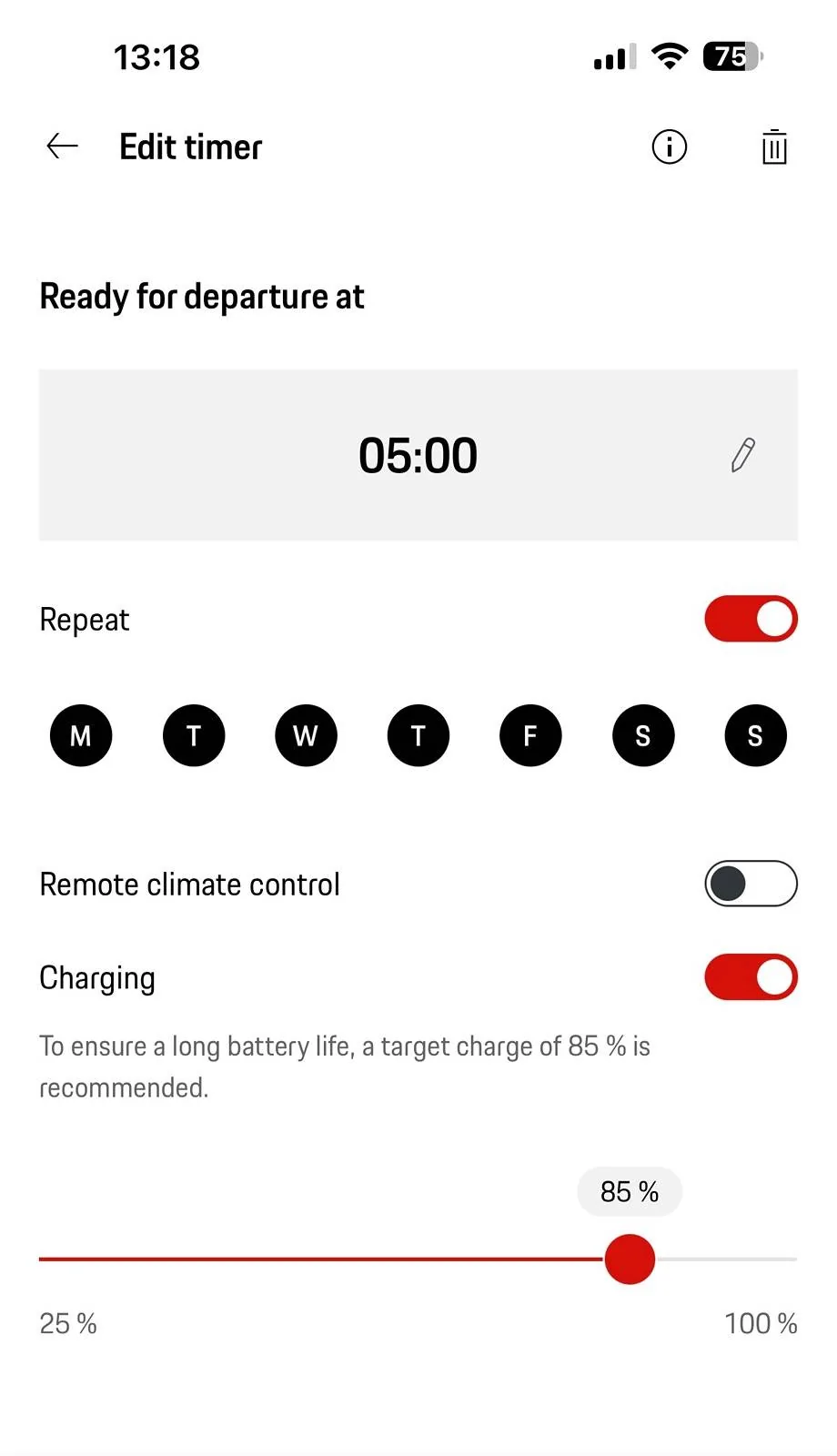

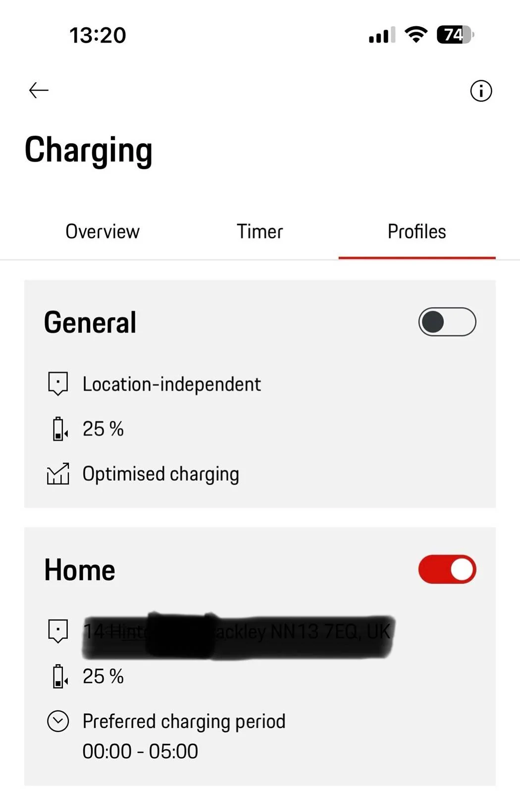

This profile …
and this timer …
should do what you want.
The timer will do the same thing by itself. The profile is not doing anything in this setup.
Then what would prevent the car charging at peak rate outside the 00:00 - 05:00 window?
Jhenson29
Jeremy
Feb 9, 2021
3,015
4,651
St. Louis, MO
2022 Macan S; 2021 Taycan 4S
It’s not prevented now. Those are “preferred” times. They are not strictly enforced. The timer will charge outside of them if it needs to based on starting charge, available time to departure, available power, and target charge.
Preferred times could help if the departure time was different, like 9am. Then it would try to use the preferred times to reach the charge, but it would still charge outside of those times if it needed to based on the timer’s needs.
