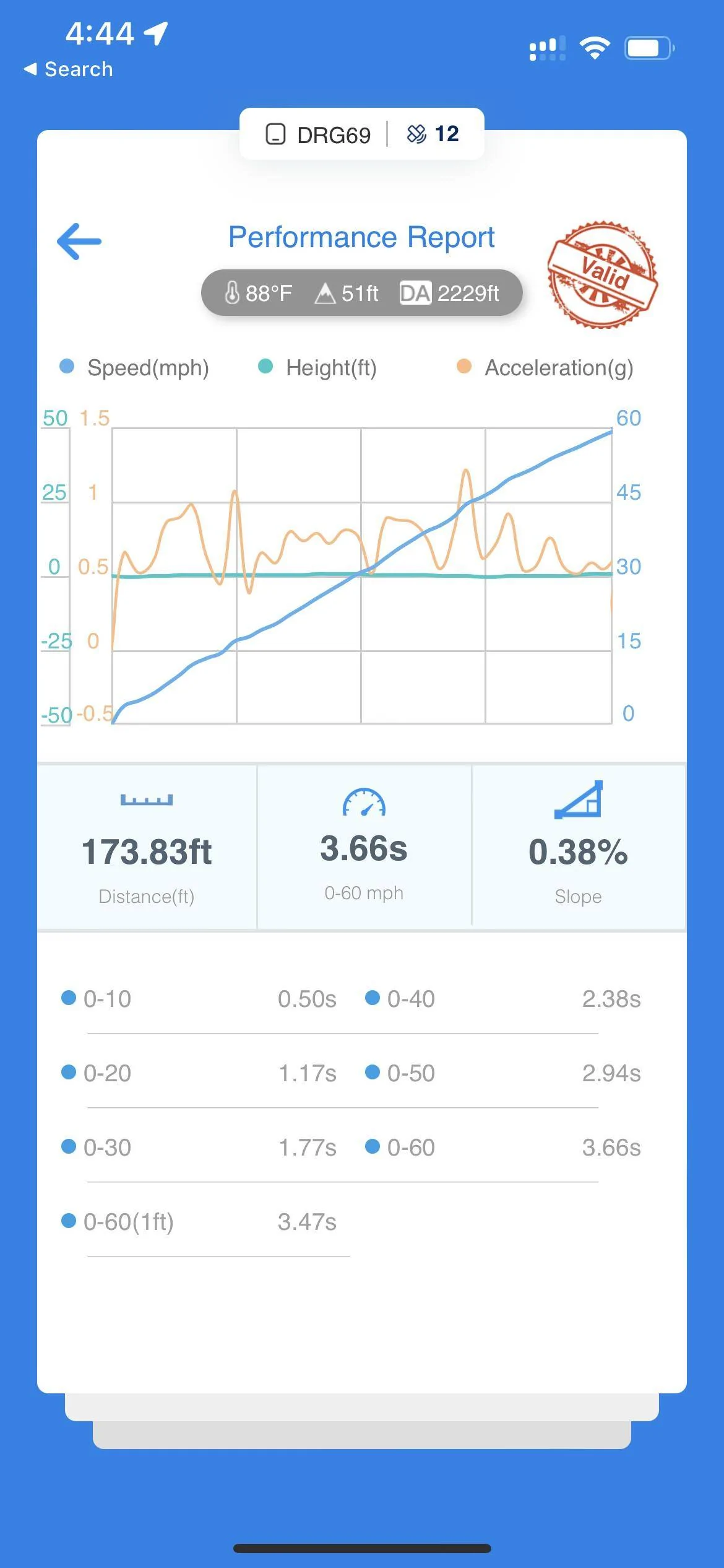

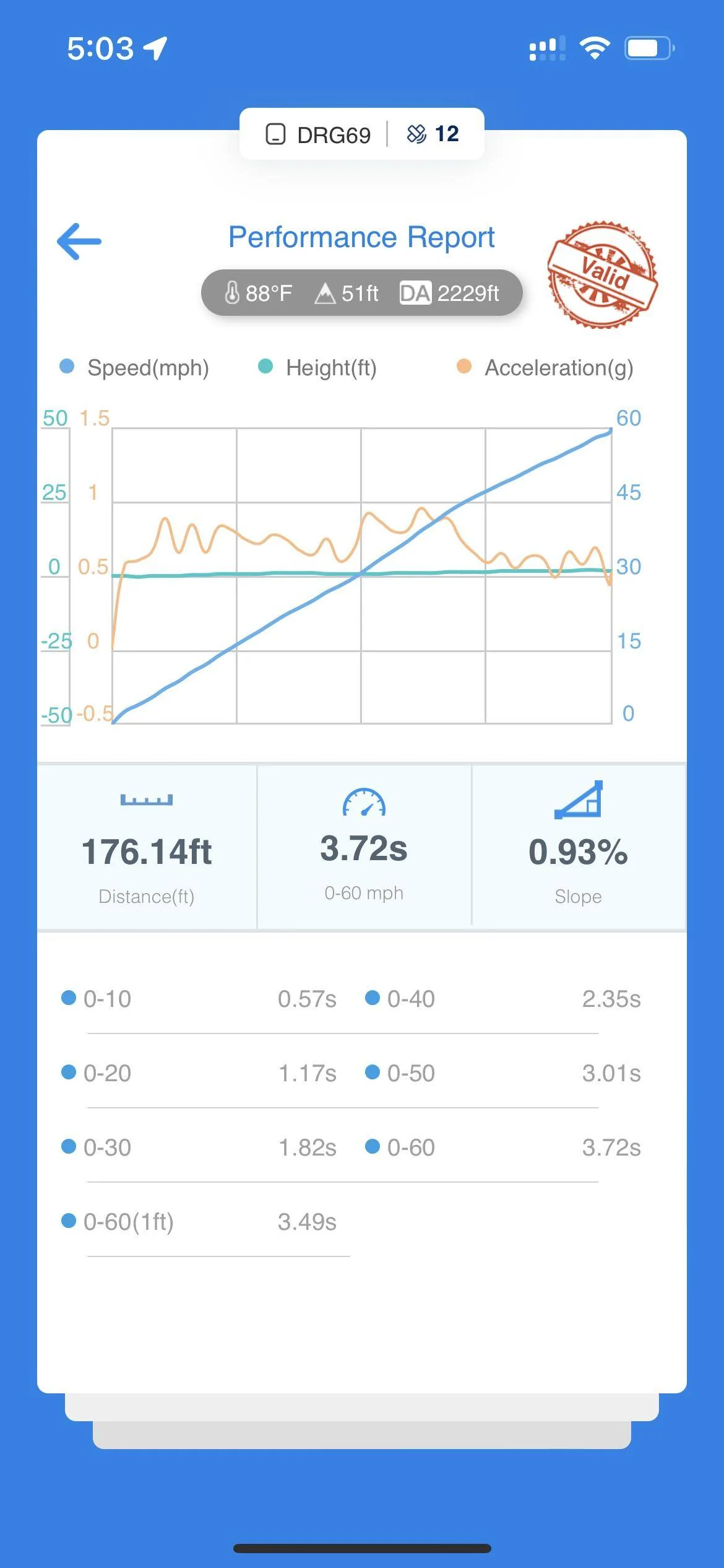

Unscientific but I have observed the same. Fastest 0-60 is in Sport, not Sport Plus. However, the road wasn’t drag strip smooth and I noticed it fighting for grip in sport plus more than sport on the upshift which I chalk up to shock damping. You can see that’s where acceleration dropped on the Sport Plus run.
Didn’t have time to run more, not on a closed course.
SPORT

SPORT PLUS
Porsche Taycan Better acceleration in Sport Mode (vs Sport Plus) ? IMG_0619
