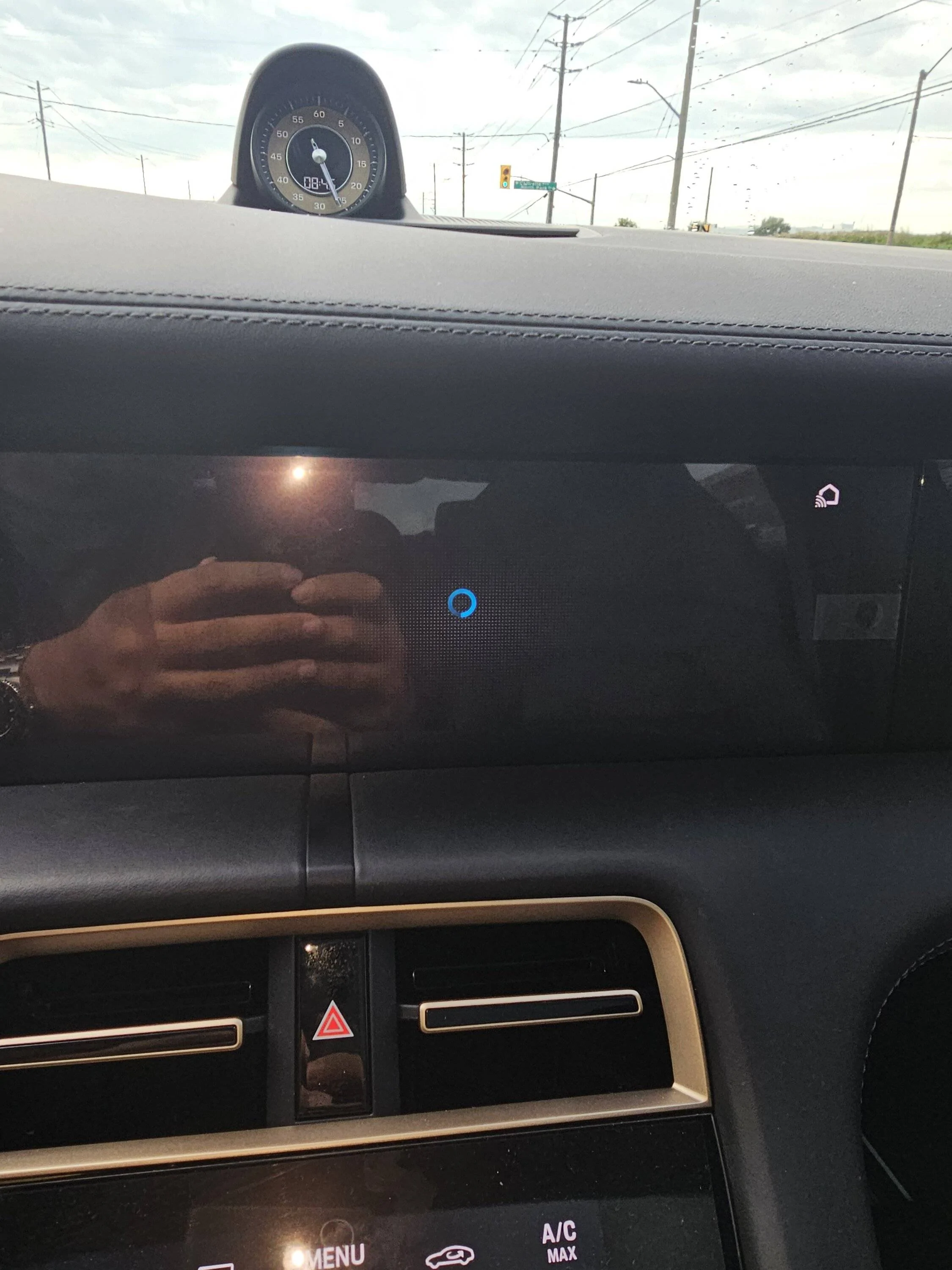

This won't go away. My screen won't display.
Tried restarting the car several times. Anyone have a solution?
TIA

It will fix itself after you lock the car and keep the key fob away for 15 - 30 minutes.

Thanks. I'm realizing this coincides with the OTA update that I thought wasn't installed (got an error message the first time I tried to do it), but maybe is now installed.
I'm going to try the 2 finger reset as soon as I figure out how exactly to do that lol.

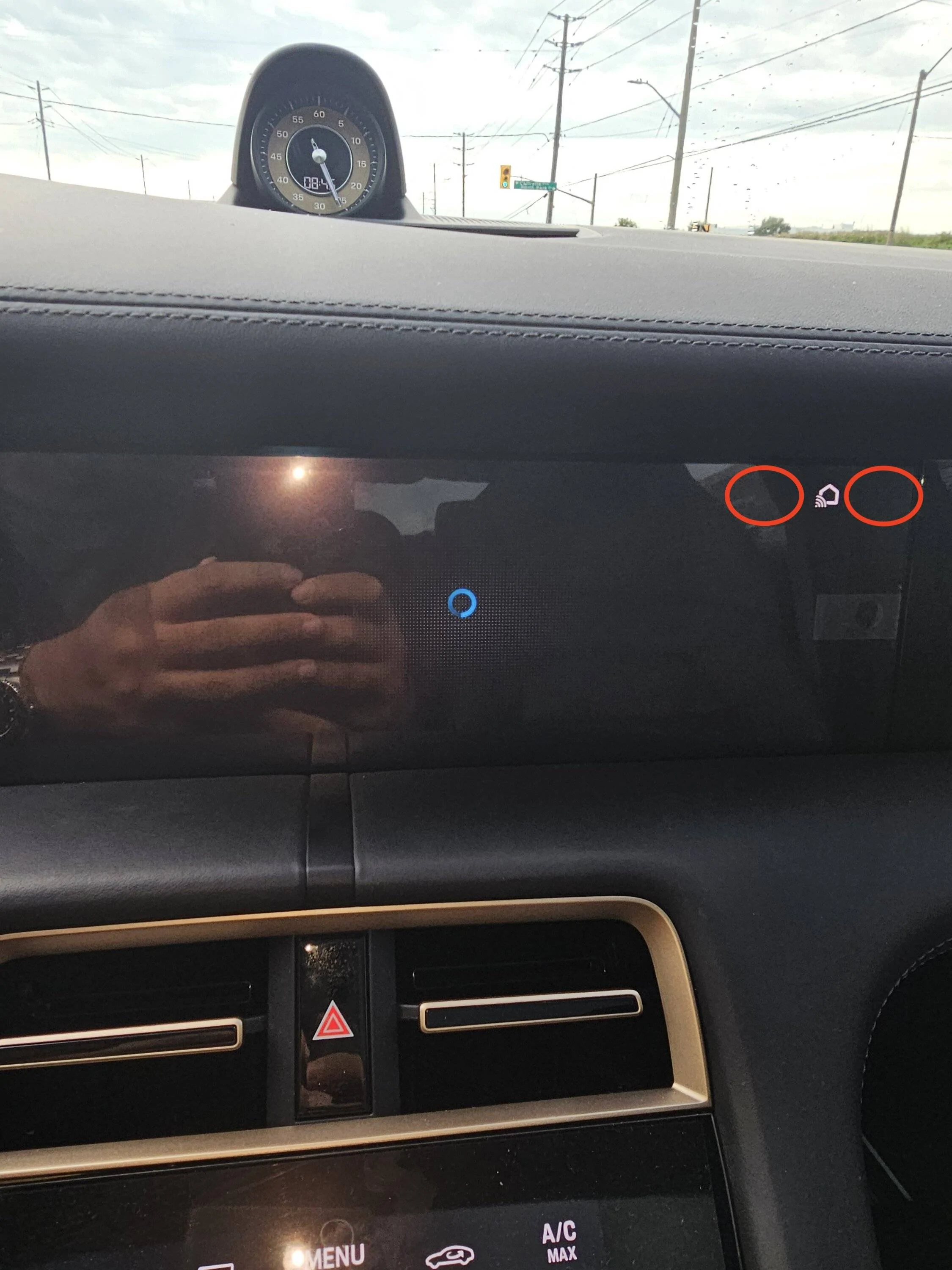

2 finger reset usually doesn't work for this issue. To do that reset you just push and hold with 2 fingers about 1 finger width apart from each other in the top right corner of the display. If you do it right, the screen will go blank and then boot into engineering mode. You choose the option to exit and it will reboot as normal.
I've added red ovals to the areas where you can try to press to get the reboot to work. It should work within 5 seconds if you get the right spot.

Thank you for this!!!
