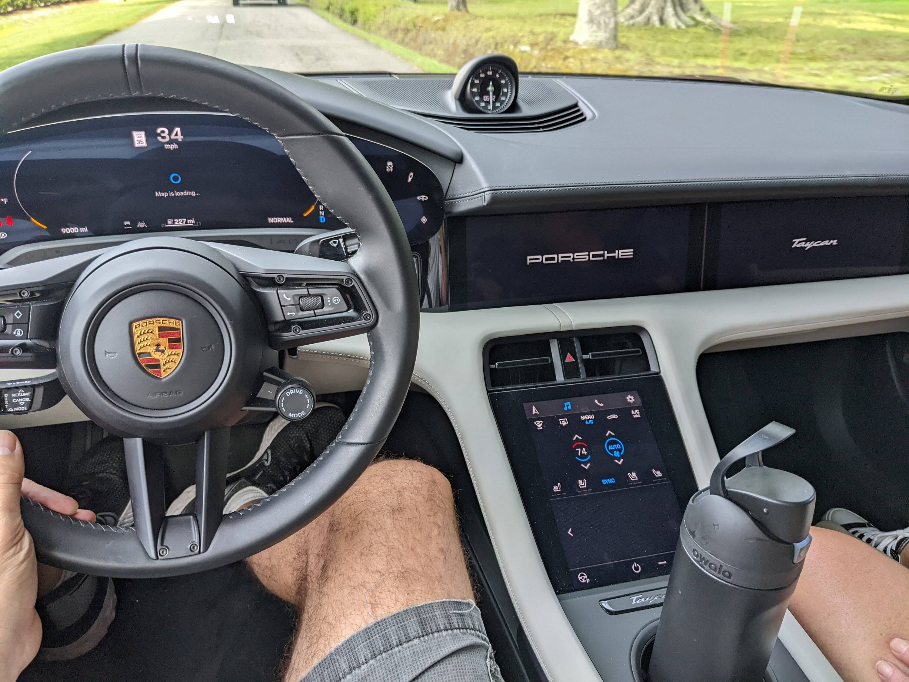

See the picture. How many times are you guys seeing this? This is about the 4th time I've had this happen and it's frustrating when it does. You power on the car and none of the screens show anything. The only thing you get is the speedometer and the "Porsche" and (if you have the passenger screen) "Taycan" logos. This usually happens after a charging event.
To solve the problem, I've tried
  1. turning off the car and re-starting
  2. turning off the car, exiting, re-entering and re-starting
  3. turning off the car, exiting, locking, unlocking, entering and re-starting
Nothing works. I know that if I turn it off, lock it up and come back after an hour or so, everything comes back on just fine. Is there a faster solution?

Try the PCM reboot?

ANA6?
https://static.nhtsa.gov/odi/rcl/2022/RCLRPT-22V404-5920.PDF
"On some of the affected vehicles, a software error in the control unit of the central computer (PCM) could cause the following error symptoms: 1) the center screen (including rearview camera image) and the touch control panel remain black directly after the ignition is activated "
Yours has the 'Porsche' logo so I'm not sure if this is the same 'bug'.

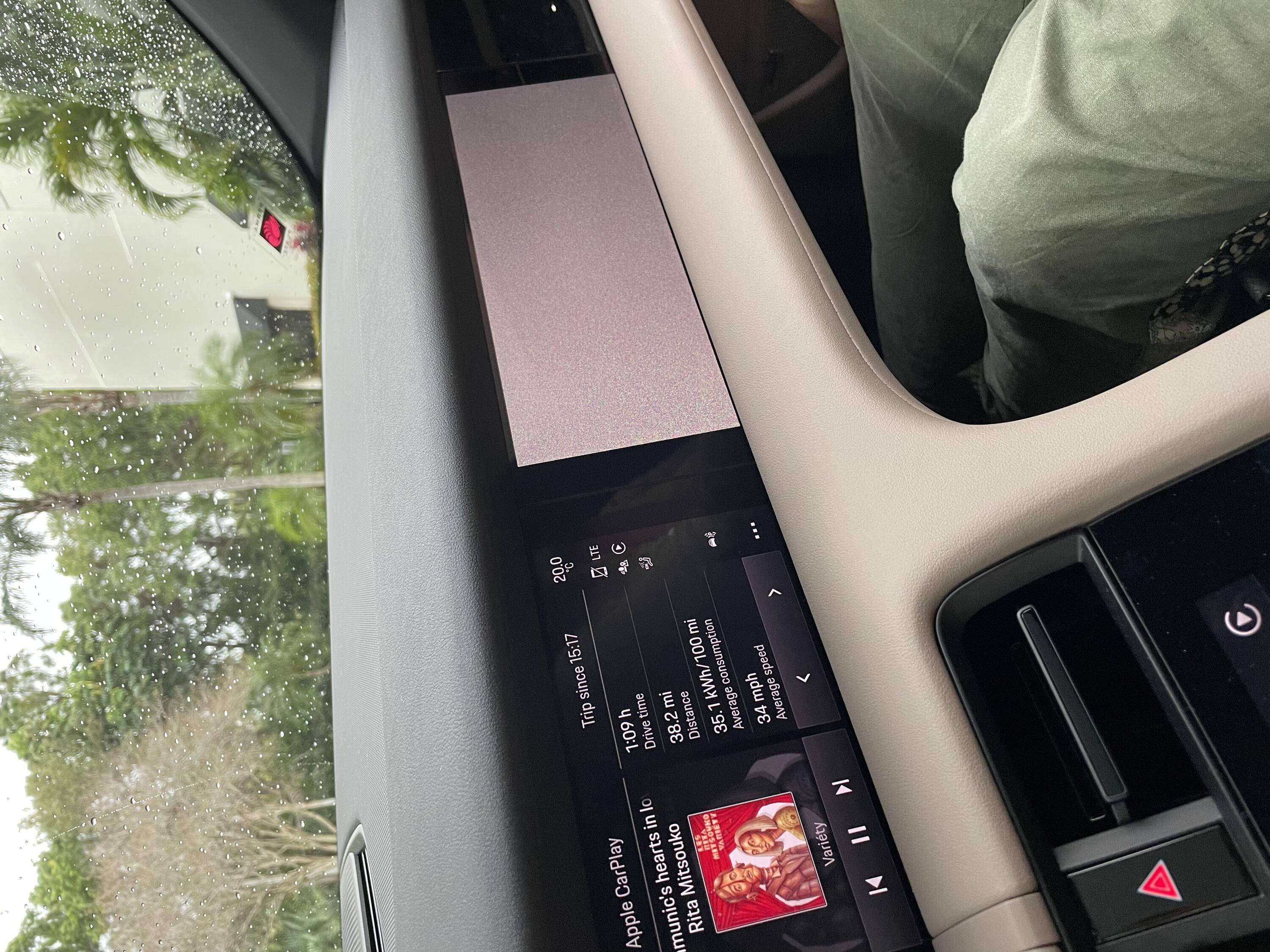

From time to time I get that, passenger screen flickering showing snow.... Reset solve it.
Not even bother to tell the dealer....
If at some point you update to ANA6, this should get fixed so you wont need to reset.
I saw this problem once in the 6+ months I've had my Taycan, so I don't consider this a major problem. Also, I had a blank screen once in my Tesla Y, but this occurred while driving so it was a bit more serious.

same it happened maybe couple of time, since I did terminal 20 few month ago - no issues Cross finger - I have very little hope with ANA6 will fix at the margin what is absolutely needed as per regulation, for the rest hope does not cost much - right!
car is great and at the end I have no issues since the alarm is finally quiet.
