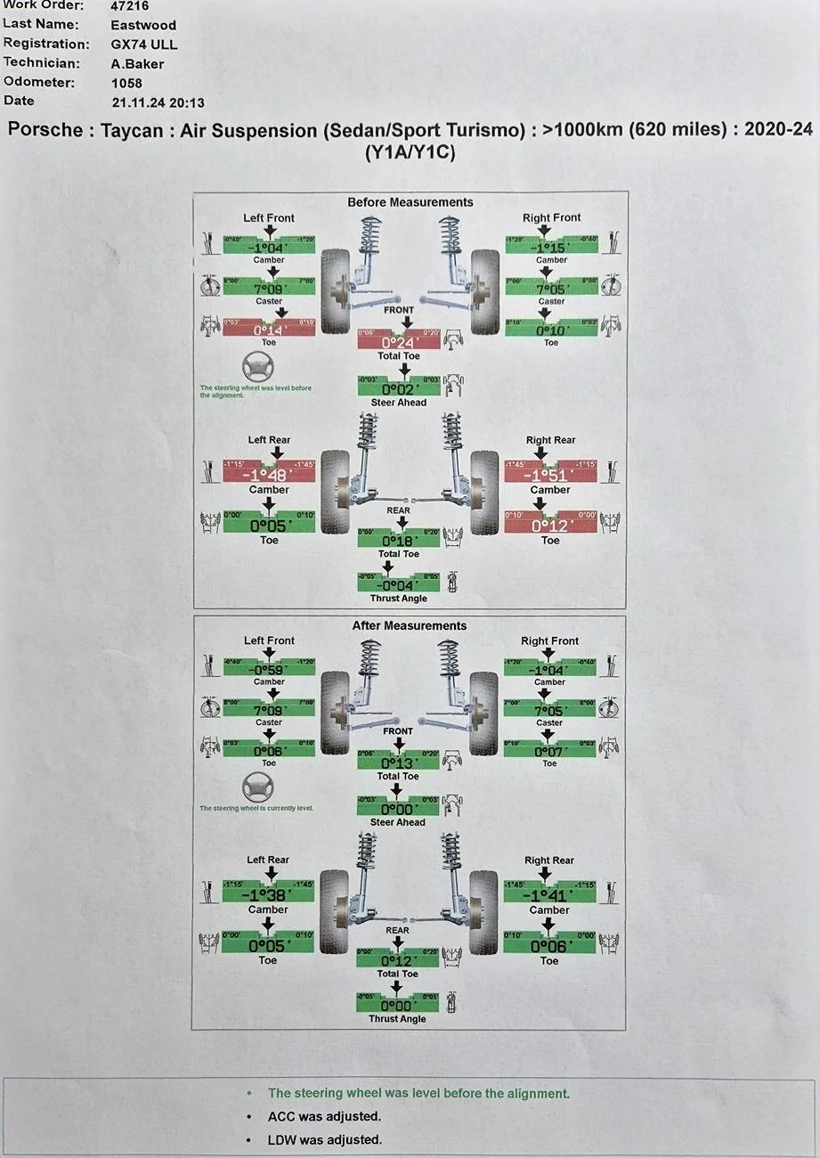

£750 just for the alignment? Have you got the print out of before and after?
Unless they changed the front camber angle that is outrageous. Tyres and wheel alignment are much better done at a local tyre centre. Tyres need to be NFO or NF1 fitment but generally about £100 cheaper at a tyre centre. 4 wheel tracking is around £100 at a good tyre centre. Generally it is only the toe angles which need adjusting. If the front camber angle needs adjusting the front bumper has to come off and hence why OPCs can charge £600 to £1000. I got Sytner to do my foc before I picked it up. Details attached

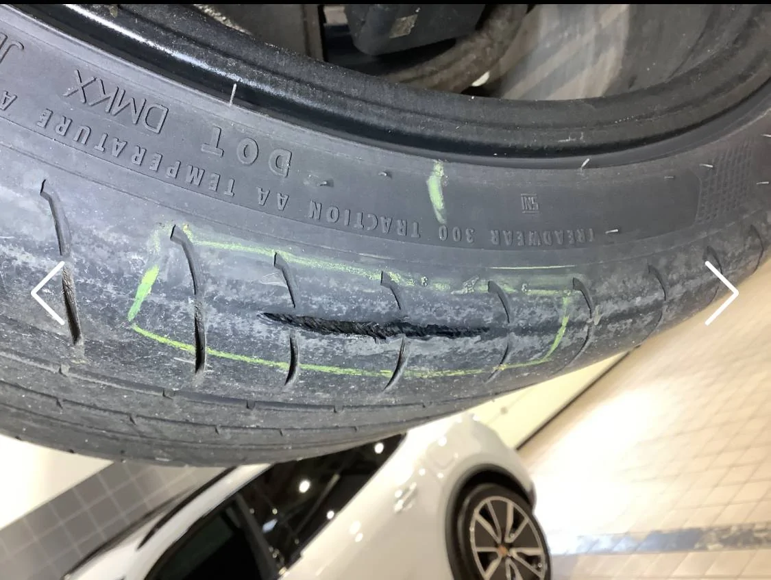

The rear tyre worn to the cords btw looks like not to be camber issue. Where it is I think I must of caught it on something. I thinking inner edge of a pot hole maybe? But this is what trigger the need for alignment.

Rear tyres, MOT & alignment all done. They did some tweaks to the toe all round and some small changes to the camber. This was done and normal and sport+ height to ensure always in tolerance. Cruise control etc recalibrated too. Total cost was £1,665.
