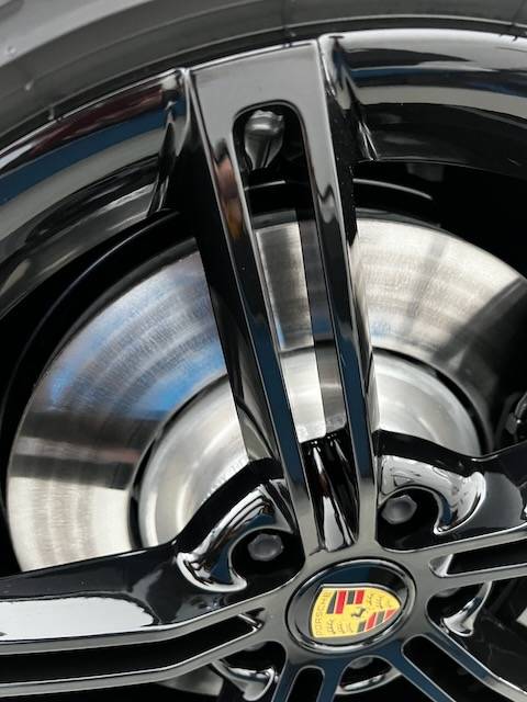

Strange outcome. Did they provide details of the defect?
They did not. It was something along the lines of, "We consulted with Porsche NA and they said to replace front rotors and pads."
I bought the car used with about 1800 miles, so I have no idea how the owner drove the car. But I don't think the PSCBs should look like this with such low mileage.
Perhaps a lot of time spent at the track?
