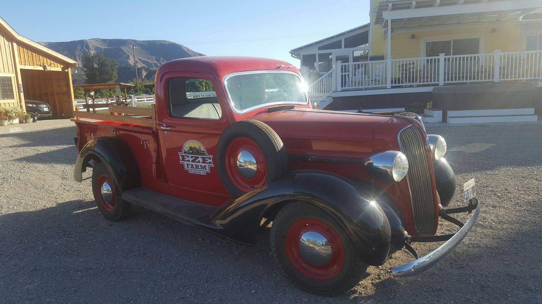

I have an old 1937 Plymouth pick-up truck and while it's fairly rare it's not considered a classic but instead an antique, it's perhaps worth about $24k so we're not talking about something fancy. I use it at a farm/ranch I own. Here's a pic:
Porsche Taycan Can I get an opinion on a project EV Plymouth
It looks a bit funny but you get the idea. Now here's the thing; EVERY time I drive it somewhere I have to hope/pray that it'll start-up again and get me home. The carb is rebuilt, the fuel tank was flushed, they've gone through the ignition, replaced the points but for whatever reason, once the engine is hot (and sits for more than 7-10 minutes) it often doesn't want to start. Point is, my sense of confidence and reliability is deeply compromised which cripples my wanting to use it.
I'm VERY much wanting to convert this to an EV.....but I'm catching a LOT of flack from people who say I'd be destroying a piece of history, ruining it, etc. Fact is, I own it so it's my call but I'd like to ask what you would do. Let me list a few other reasons that should be a factor:
That sounds familiar (I have a 996 ?), so here's another/a different take: check the cables - battery to alternator or starter, or any other cable in the ignition path. Corrosion on terminals reduces the effective area, to which electrical resistance is inversely proportional. When the engine is hot, the draw on battery (if it's the starter) or the charging (if it's the alternator) is adversely affected, and that results in difficulty in cranking/starting. (psychic question) Does the situation appear to fix itself after things are cooling off a bit?
This is, of course, completely orthogonal to the EVization aspect, to which the fix is not necessarily mutually exclusive.
