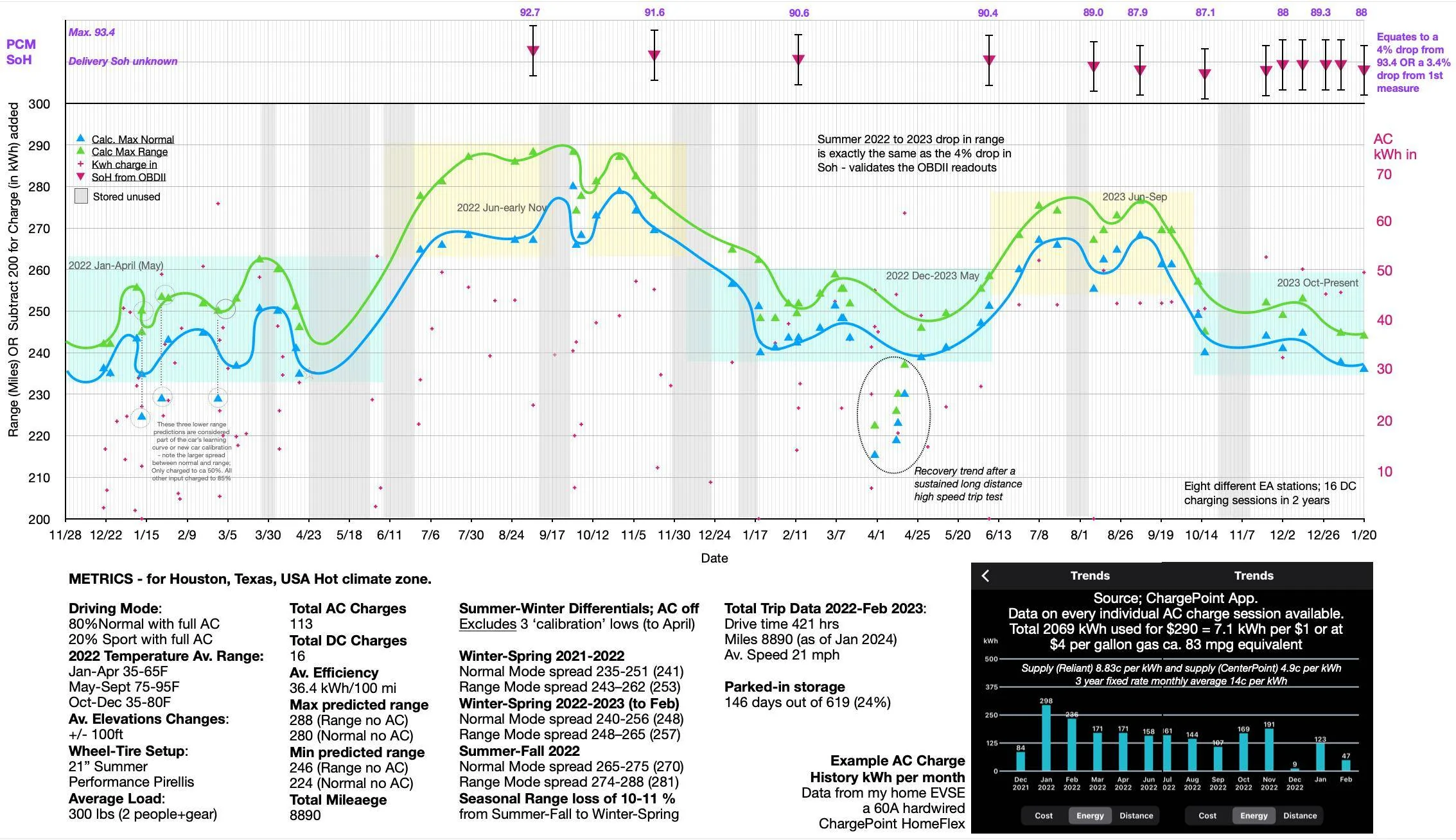

Forgot to add that your metrics do confirm you have the battery + :)!
Also be aware that 'flash' Soh readouts are typically +/- 1% and known to vary as much as +/-2%.
Your last app BE readout at 80% SoC differed only by 0.7% to the calculated value above - so again well within error ranges.

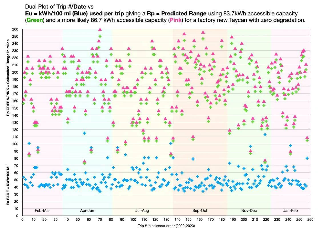

While I'm at it - here is some more info as a 'go-by' in respect how variable the consumptive record can look like (kWh per 100 miles here) and my GoM range prediction variations which clearly are very effected by our 2-season climate here in Houston! :) More variation expected in proper 4 season northern Europe.
Porsche Taycan Did I get a bad car? Screenshot 2024-01-24 at 9.45.15 AM
Porsche Taycan Did I get a bad car? Screenshot 2024-01-24 at 9.41.48 AM
This chart uses reported kWh/100mi or energy used (Eu) in blue per recorded trip for a PB+ to calculate a predicted 100% SoC range (Rp) using both the published 83.7 kWh (green) and what is considered the actual usable capacity of 86.7 kWh (pink) i.e. of course this assumes constant level of efficient/inefficient energy draw from the battery:
So Rp = (83.7/Eu) x 100 or (86.7/Eu) x 100
e.g. an Eu of 37.7kWh would give a calculated range of 222 or 229 mile range. This is 23.6 kWh per 100 km. a 60 kWh draw would give a range of 139 miles or in metric 37.5 kWh per 100 km.
This method of calculating the range is of course biased towards extremely inefficient short trip data (based both on driving style and on my trip length-duration data). The predicted range data (Rp) calculated from the recorded per trip kWh’s used (Eu) go from as low as 70 to a high of 250 miles with the bulk of the data between 160-220 miles. The longer range predictions here (230-250 miles) are clearly tied to the 10 or so longer (over 75 miles), more efficient trips and the chart just re-emphasizes that trip length and driving style have a fundamental control on any ‘predicted’ ranges whether based on the PCM post-charging calculation or as in this case derived from kWh per trip data and remaining capacity of the available kWh of the battery’s capacity.
The bulk of the ‘predicted’ ranges here are very low but these data must again be regarded as a more pessimistic use scenario i.e. they are based on scenarios which assume I would continue to drive very short distance/duration trips at low average speeds in Normal Mode with full AC for a full 83.7 or 86.7 kWh usage. The key point here being that you should not consider short trip derived range predictions as any useful indicator of your car’s ability to do far better during long range driving.
I can fairly confidently state that in my usage case that the combination of trip length and driving style are the principle variables controlling my range predictions vs impact of weather, terrain, load etc., as I have driven the car near 100% of the time with other parameters essentially fixed - they being:

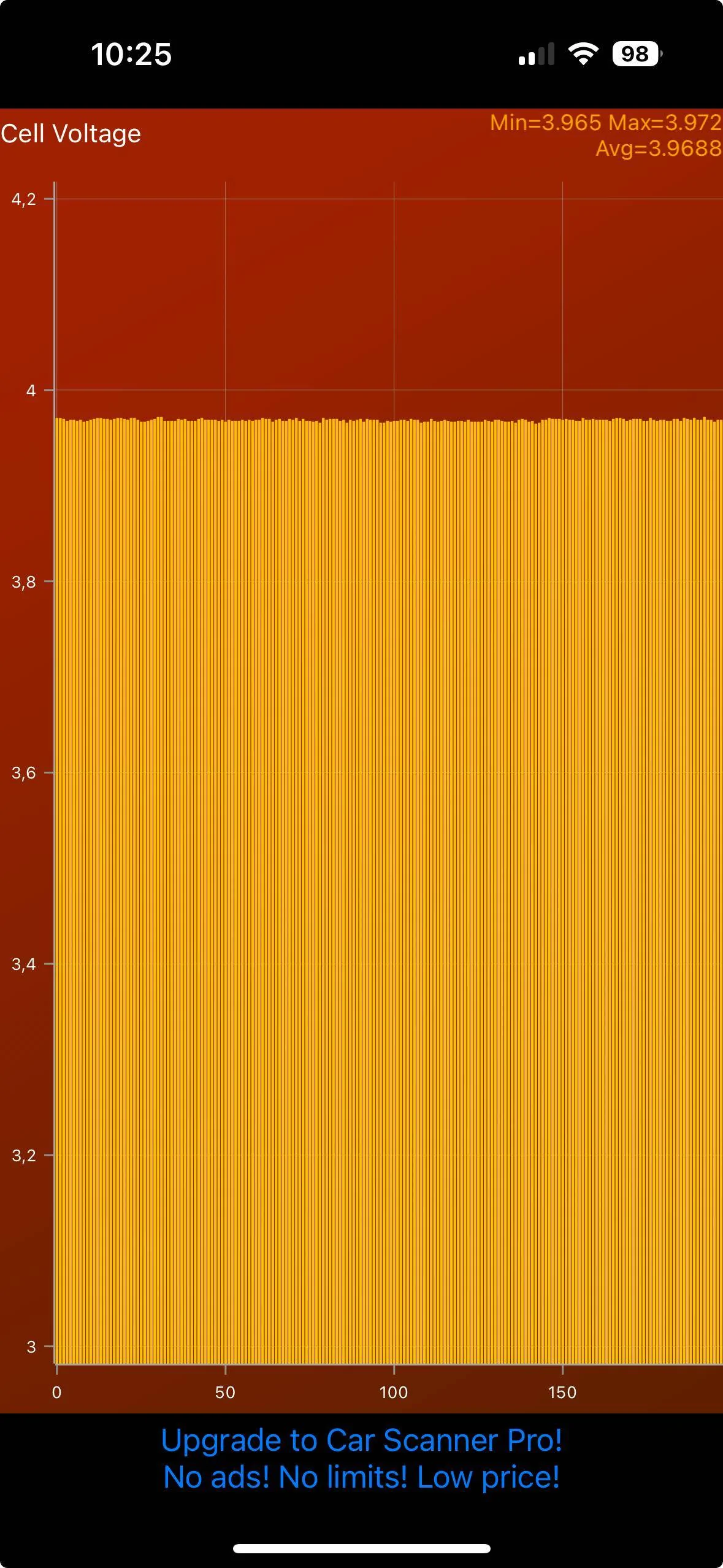

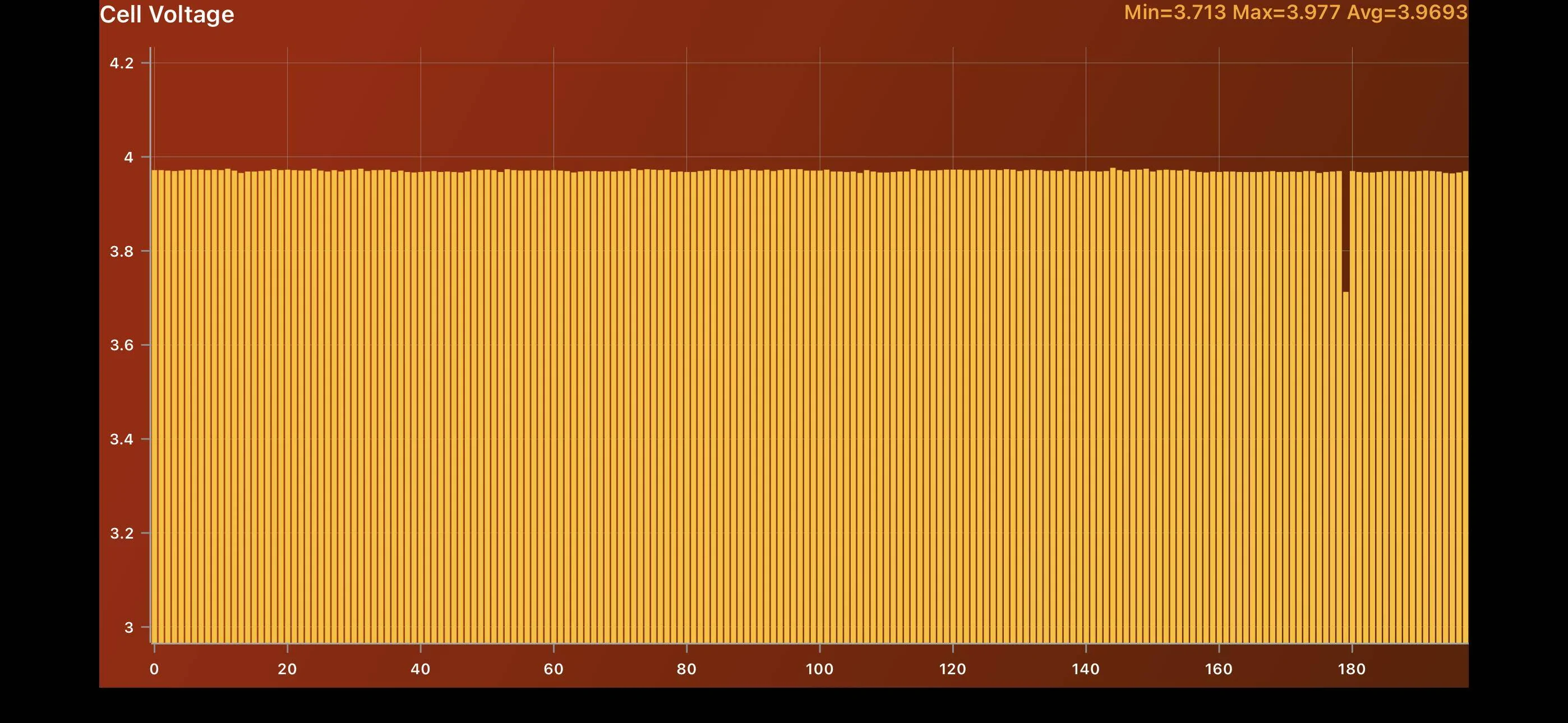

@ciaranob, your extremely helpful mega-thread on this topic, now with over 600 posts, includes some discussion about bad cell maps. I and others have had an overall SoH considered low, but not low enough given the mileage to trigger Porsche warranty service, which turned out to be mostly due to a small number of bad cells that could be seen in the Car Scanner cell map. Those bad cells soon led to the dreaded red electrical system failure requiring battery replacement or rework. So I am surprised you are advising @faithnomore to exclusively look at where his overall SoH fits on your data point distributions. What if his otherwise “normal” SoH degradation is largely driven by a couple of bad cells that will soon leave him stranded as happened to me? Again, thank you for your enormous contribution to the forum on the topic of SoH. For those interested, here’s a detailed account of my experience, posted to @ciaranob ’s mega-thread.:

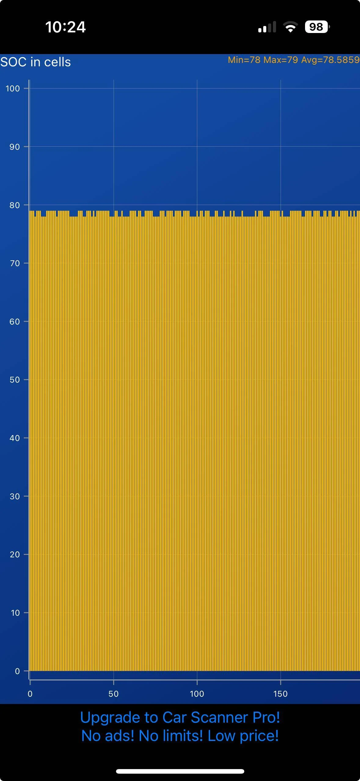

When I reviewed your posts I didn’t see where you mentioned the results of the cell maps in the Car Scanner app. So your cells with the highest and lowest voltages very close to the average cell voltage?
I only checked after your comment - they seem almost identical to me
