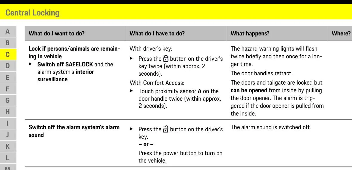

Is it possible to set alarm and not have the dogs in the back set it off? I thought pushing lock button twice on remote did this. Left dogs in car to go into shop last night and only got inside store before a call from Vodafone assist re alarm going off. Can’t find any old posts although I’m certain I read about this last year.
I found your answer from manual
Porsche Taycan Can you set alarm without inside movement? IMG_5713

I did hit the button twice but suspect the delay between both pushes must have been more than 2 seconds.
