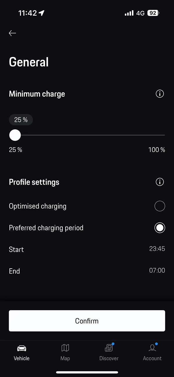

Got another question: I set up a profile to with the minimum charge at 85%. I woke up this morning to a fully-charged battery. How do I stop it at 85%?
By design (let me narrow this down to US only) if built-in General Profile configured as Enabled, Location independent, with Optimized selected and set to 85%, the car will start charging right away and will stop at 85%. This assumes Direct Charging is not checked. App and Car charging settings are fully in sync and match.
Double check the above and if not sure what that means, post pictures of the settings from the App and we can troubleshoot from there.
I beg others not to jump in with exception theories as we are helping someone new to the Taycan and starting what we know works by design. However, if this does not work as designed, then we will get into workarounds.

I definitely did not have "optimized" selected.
That would explain it - not going to go into the details why, but I know why.
Please do more tests with lower SoC (for testing purposes) than 85% to verify that when the Profile is set as I described, the charging stops at the level set and does not go to 100%.

It doesn't surpass the 85% threshold. It works perfectly. So much to learn... ?
You are welcome. We can share a lot more when you are ready, such as a benefit of using a Timer function. Please enjoy your new Taycan and come back for any more questions.
