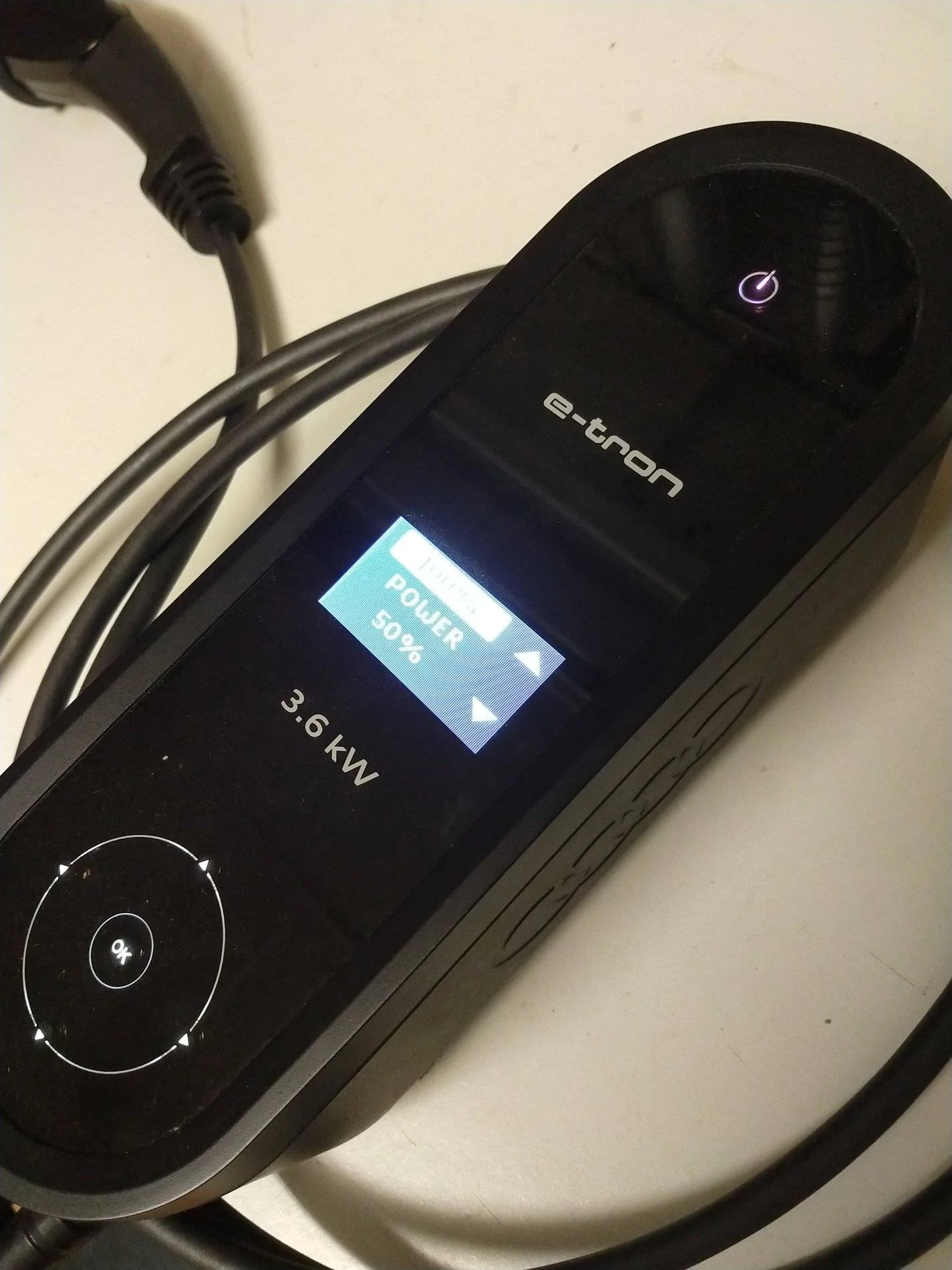

My Audi E-tron charger can switch to 50% and it looks exactly like the Mobile Charger Connect of Porsche (manufacturer Heidelberg GmbH).
The Taycan charger is much more advanced. You can connect it to your Wi-Fi Network and you can change the Charge power in 1 Ampere steps..

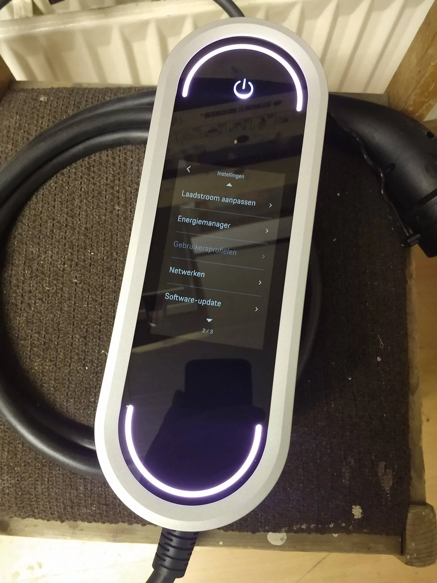

Yes, here in the Netherlands you can select 6-10A, 230V.
I assume if you have a industrial cord attached , it'll be between 10-30+A.
It also has WiFi to check for latest software, very nice and solid device.

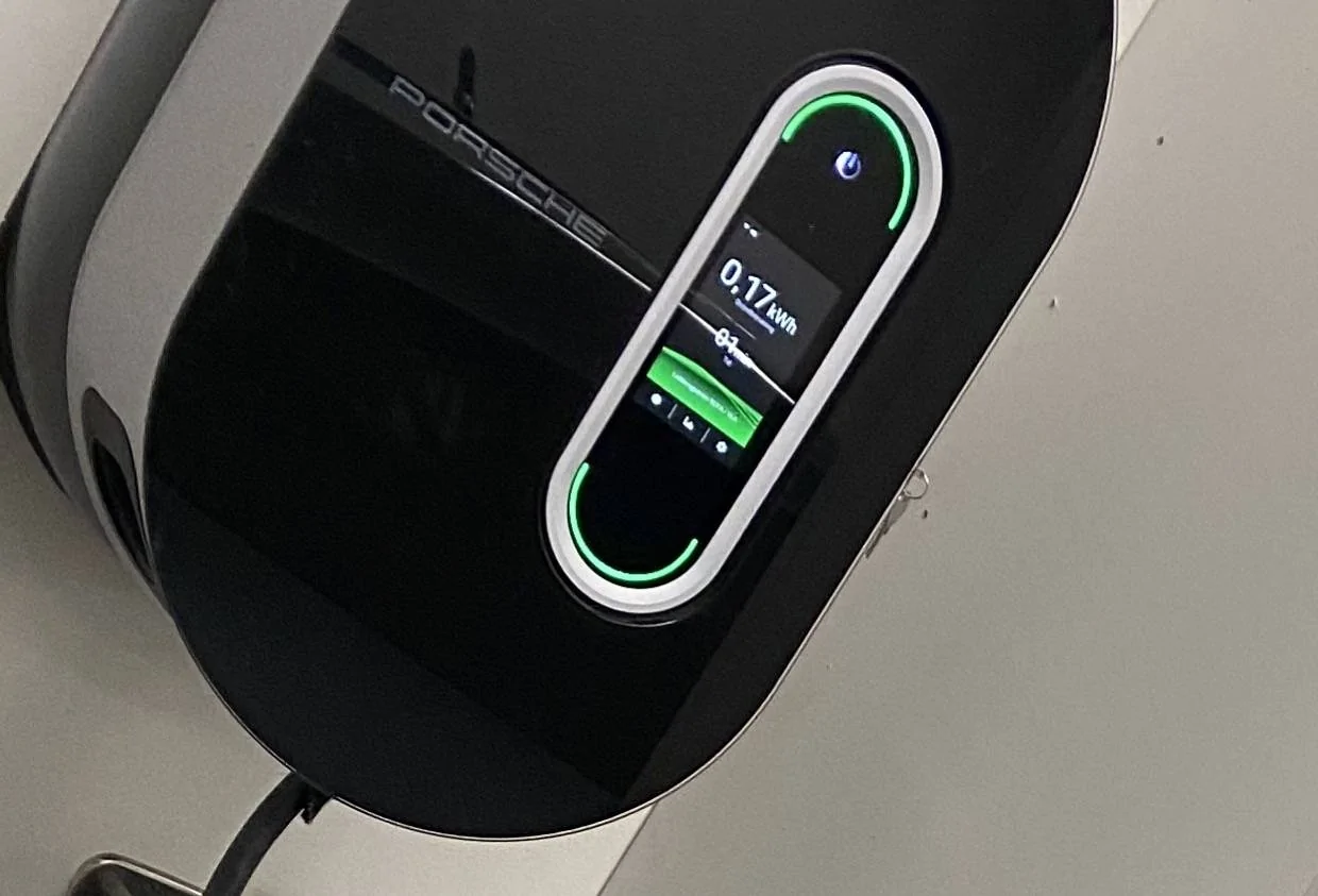

Porsche mobile charger connect, can you check and see if you can change the charging current limiting rate, looking at this for a dryer connection, be nice to know so I don't Trip a breaker, thanks
Yes. Connect the PMCC to your home network or enable the hotspot and connect directly via your mobile.
Use your browser and go to the PMCC Web Connect portal on the PMCC. Login using the password you got in the white envelope and navigate to the charging / setup menu.
