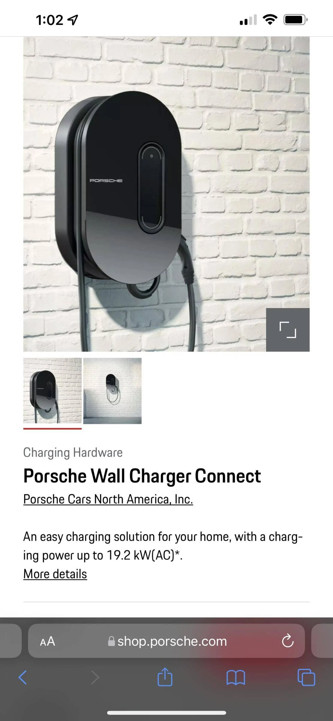

In the US, the newest Porsche charger capable of 19.2 kW speeds (80amp, 240V) is called “Porsche Wall Charger Connect” and you don’t pick the cable length (from EVSE to car)—it’s standard at 14.8 feet or 4.5 m.
Porsche Taycan Porsche Mobile Charger Connect vs Mobile Charger Plus 9343E477-4507-4FD9-B0DA-B7BAC0A3DCDF
