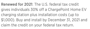

Just to add - the ChargePoint HomeFLex is a full WiFi home charger with variable charge up to 50A that comes with a 23' charging cable all for $700. You also get 30% this year off the cost of this unit and any associated installation costs involved (Nema sockets). So even with the 25' cable for free the PMCC is still way overpriced.

Yes, but the point is you don't need to deviate from the std PMC+
PMC+ can also be added to your network via a PLC connection (it has an ethernet interface built in) - so not having WiFi is not a strong argument against either.
What maximum supply does 50A support in US?
