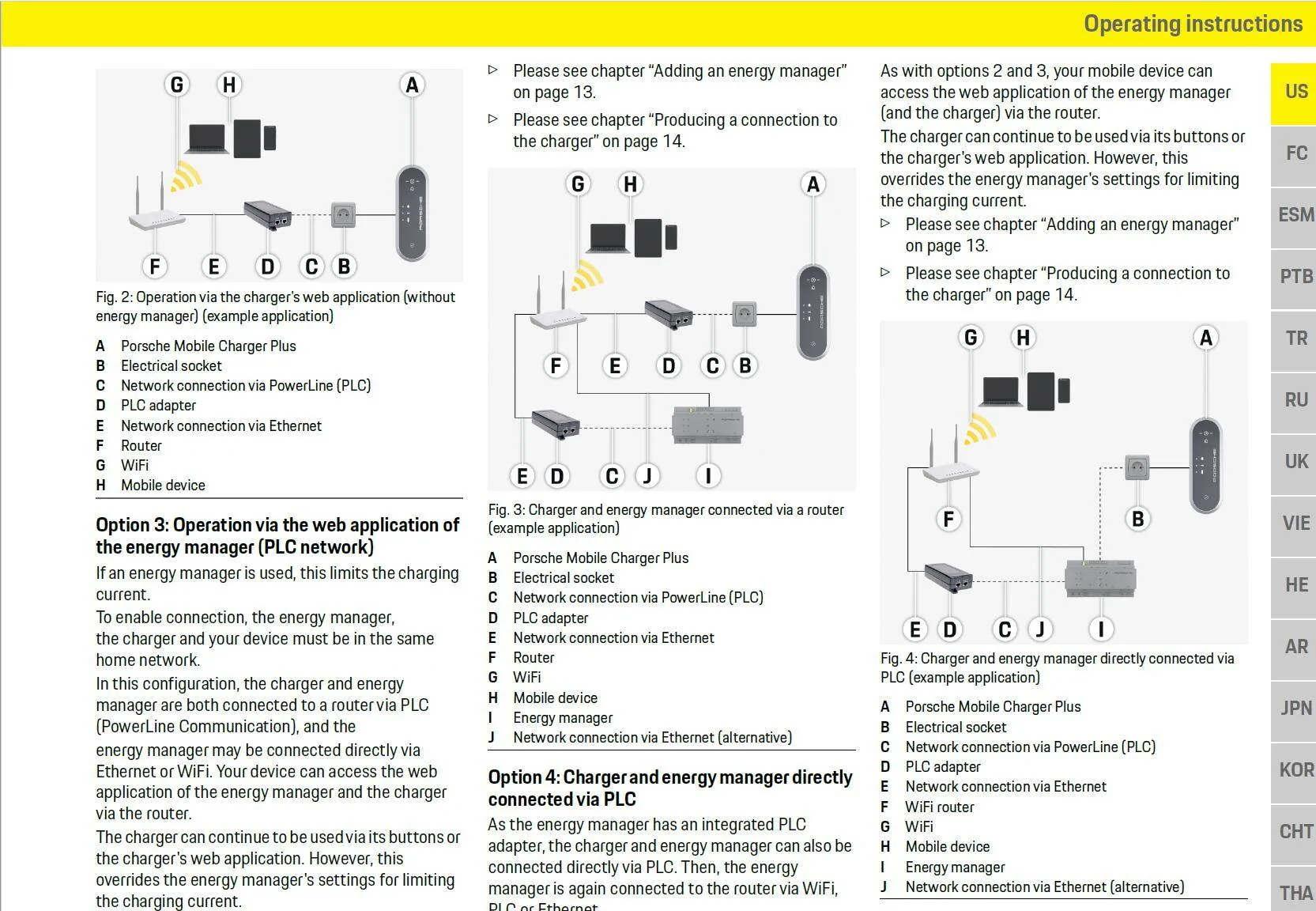

I'm guessing you realise that you can add your PMC+ to your home wifi with a PLC (Powerline Communication) adapter?
Once hooked up you can then use the PMC+ web interface (warning: be prepared to be underwhelmed). There is rarely a need to access either the PMC+ or PMCC so you aren't missing out here really.

Thank You Adrian for your help…. One silly question please & I’m sorry for not being computer savvy, but the PLC plugs directly into the charger? Thanks in Avance, Manny.
11,078
6,858
No problem.
The PLC adapter plugs into a power socket. You will need 2. One near the PMC+ and one near your WiFi router. Both must be installed on the same electrical ring. You then attach the PLC adapter to your router and PMC+ with an ethernet cable.
There are many choices for PLCs - https://www.amazon.com/powerline-adapter/s?k=powerline+adapter - but remember you need 2 (or 1 pack of 2) and 2 ethernet cables which the may / may not be supplied with the adapters.
Once connected then follow the guidance to 'pair' both PLCs to each other so that communication can pass down the wires. There will be some setup to do on your PMC+ but if it all gets too technical perhaps ask someone to assist - it would be worthwhile and good education too (something new to learn).
The white envelope you got with the PMC+ contains important information such as username and password so don't lose it!.

I'm confused with the Power line converter (PLC) setup. The PMC+ in my garage is sending PLC data so I need a receiver/transmitter somewhere in my house.
- I'm on a 240v line which has two 120v legs. Which 'leg' does the PLC data come on?
- the PLC receiver/transmitter I buy from Amazon needs to be plugged into the same leg as the PLC data is being transmitted. If this leg is not the same as the leg which my router is on, is there a PLC 'bridge' from leg to leg which I can put at my electrical panel?
- the PLC adapters on Amazon have ethernet ports. I assume that the PLC adapter I buy at Amazon needs to be collocated with the router?
Last, if I don't need a PLC bridge, it sounds like I need only one PLC adapter?
Both PLC adapters must be on the same circuit otherwise you can't complete the the data loop. Trial and error I guess to figure it out.
I believe you need two adapters - one at the EVSE end and one at the router.
