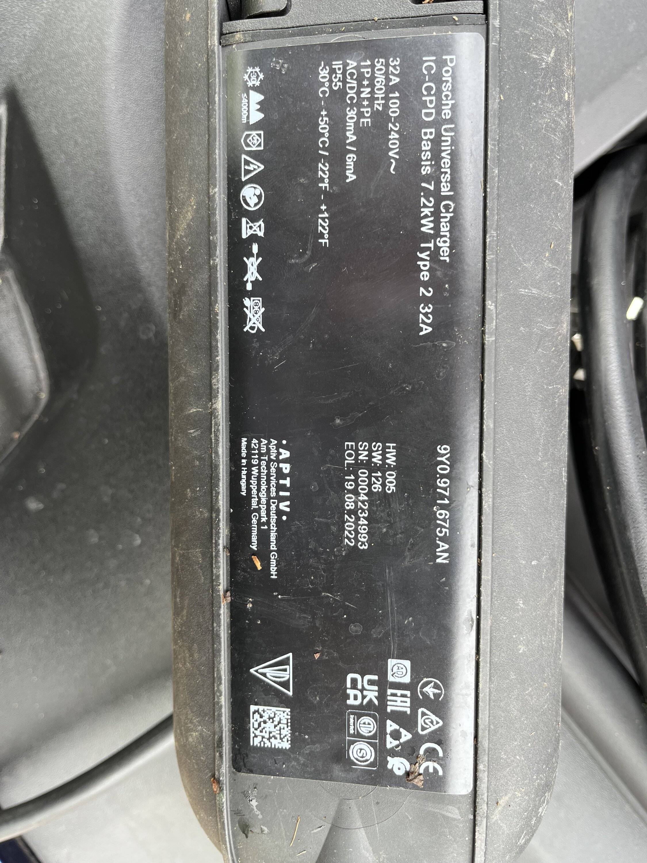

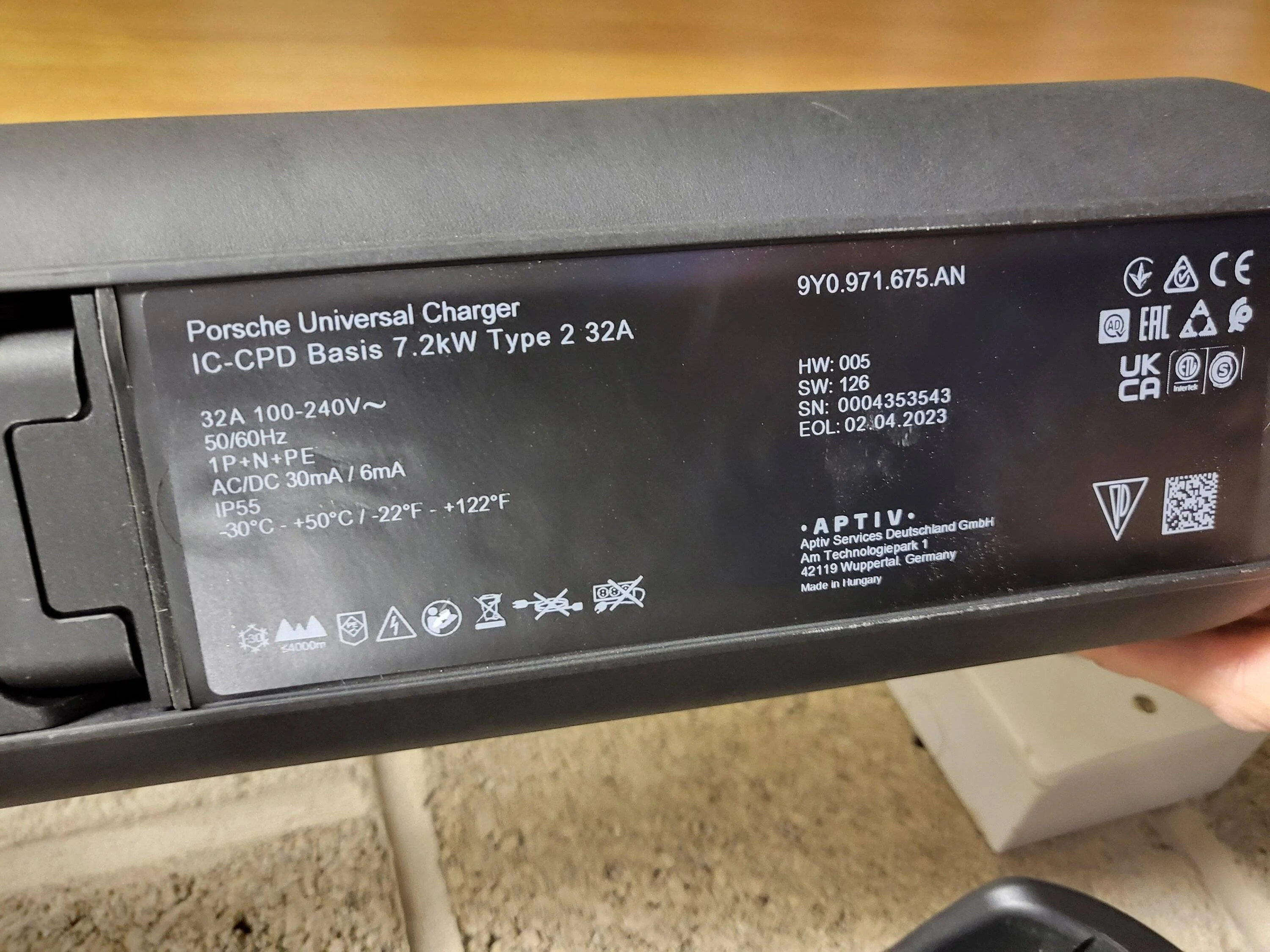

Thank you Simon, thats good to know, this is something that I have learned from this forum and after spoken with several electricians they all seems think that we would need a separate PEN protection unit for fault detection module and the load management to the device. How can you identity which of the new Porsche Mobile Charger has the inbuilt PEN protection - do you think mine is one of the newer unit that might have the inbuilt Pen, the charger came with the Taycan (M22) - see picture. Did you have to install a PEN unit for your setup?
Also, some of the electrician seems to think the Porsche Mobile Charger is not worth installing and keep trying to get me to buy one of their dedicated EV charger like a Zappi charger, Thanks

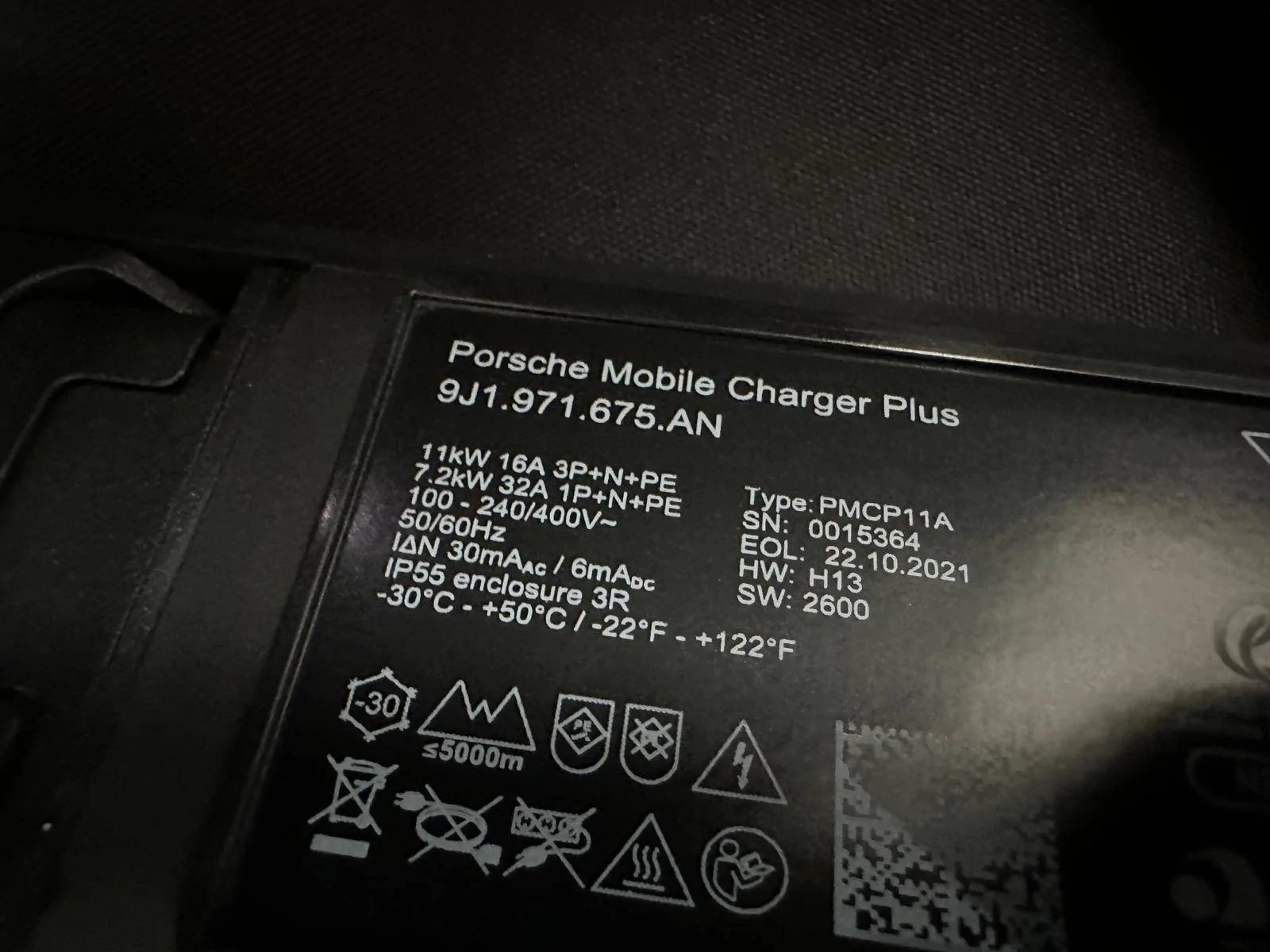

This is the older version. The newer version won’t do 11kW and says Universal charger on the back
Porsche Taycan Porsche Mobile Charger Plus - 7.2kw IMG_2391

I'm not sure if your unit has built in pen protection, I suspect not. Check with Porsche GB in Reading. But just install a garage distribution board which provides this.
I think the garo does but check with your electrician
https://www.electrical2go.co.uk/garo-g6ev40pme-consumer-unit-mcu-type-a-rcbo-pme-fault1.html
Or https://ecoharmony.co.uk/products/pen-fault-detection
I think both of these offer pme protection rather than true open pen protection but comply with the regs.

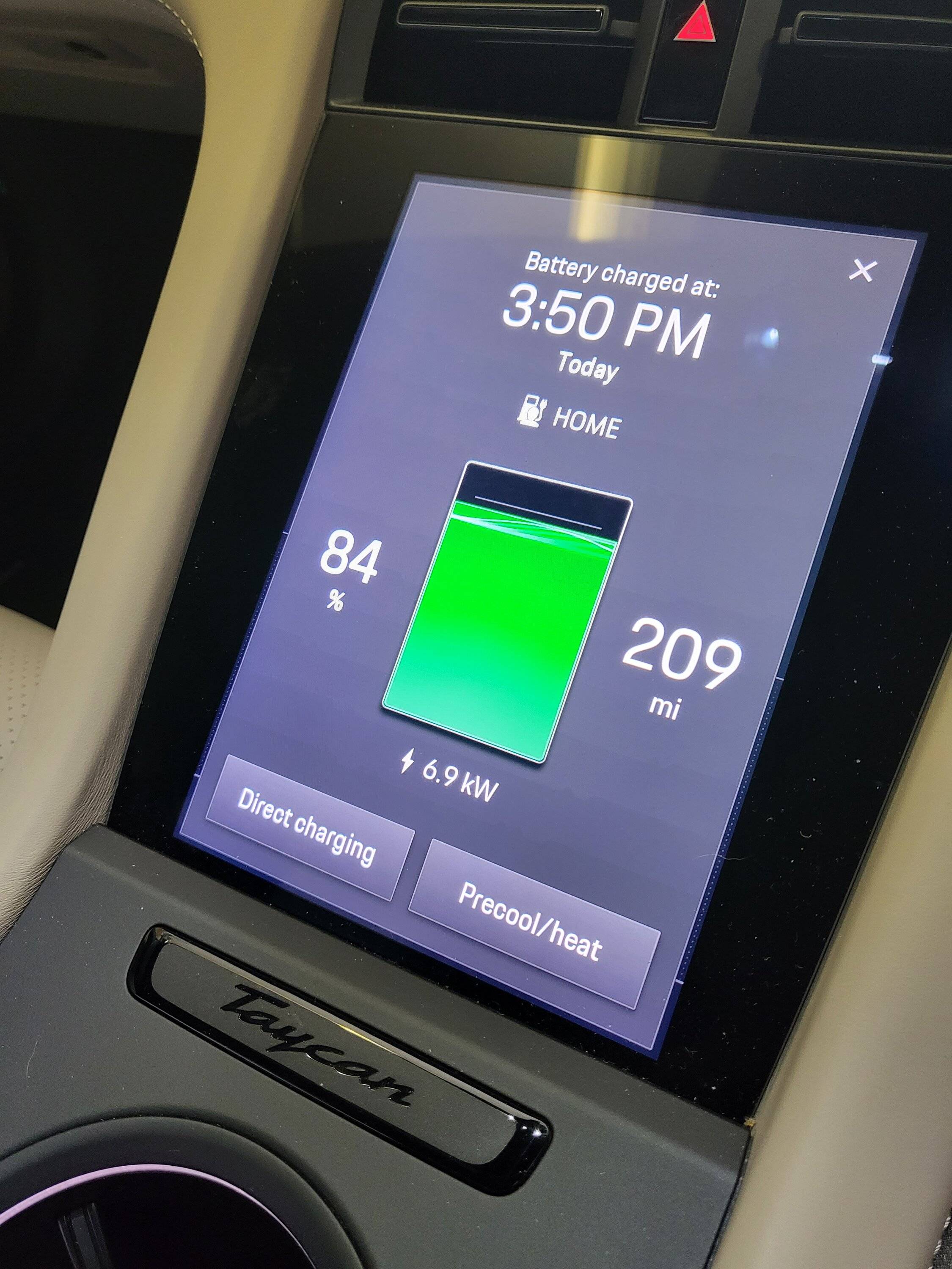

My car arrived in May, the supplied charger was the Mobile Charger (not plus) but it is also rated for 7.2kw at 32A.
It was fitted via the Porsche UK/Andersen EV arrangement. I asked the local guys first but they did not want to get involved with an unfamiliar charger.
There was also another (black) box they fitted to meet some regs or other as well as a mini consumer unit.
I can select 50% or 100%, with the latter I get 6.9kw at the car. At 100% the unit is only slightly warm to touch.

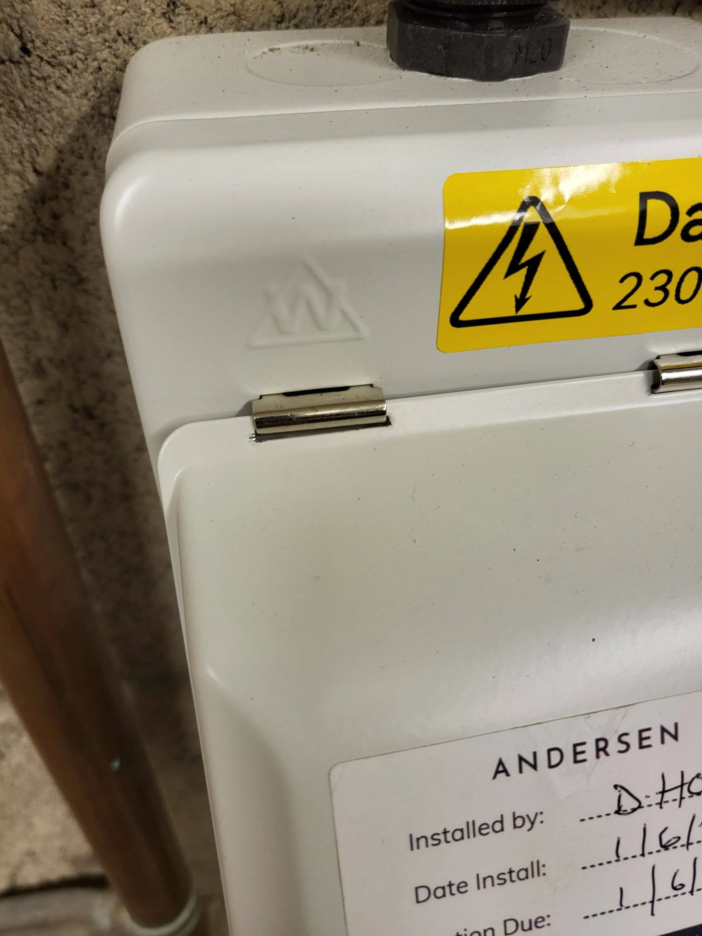

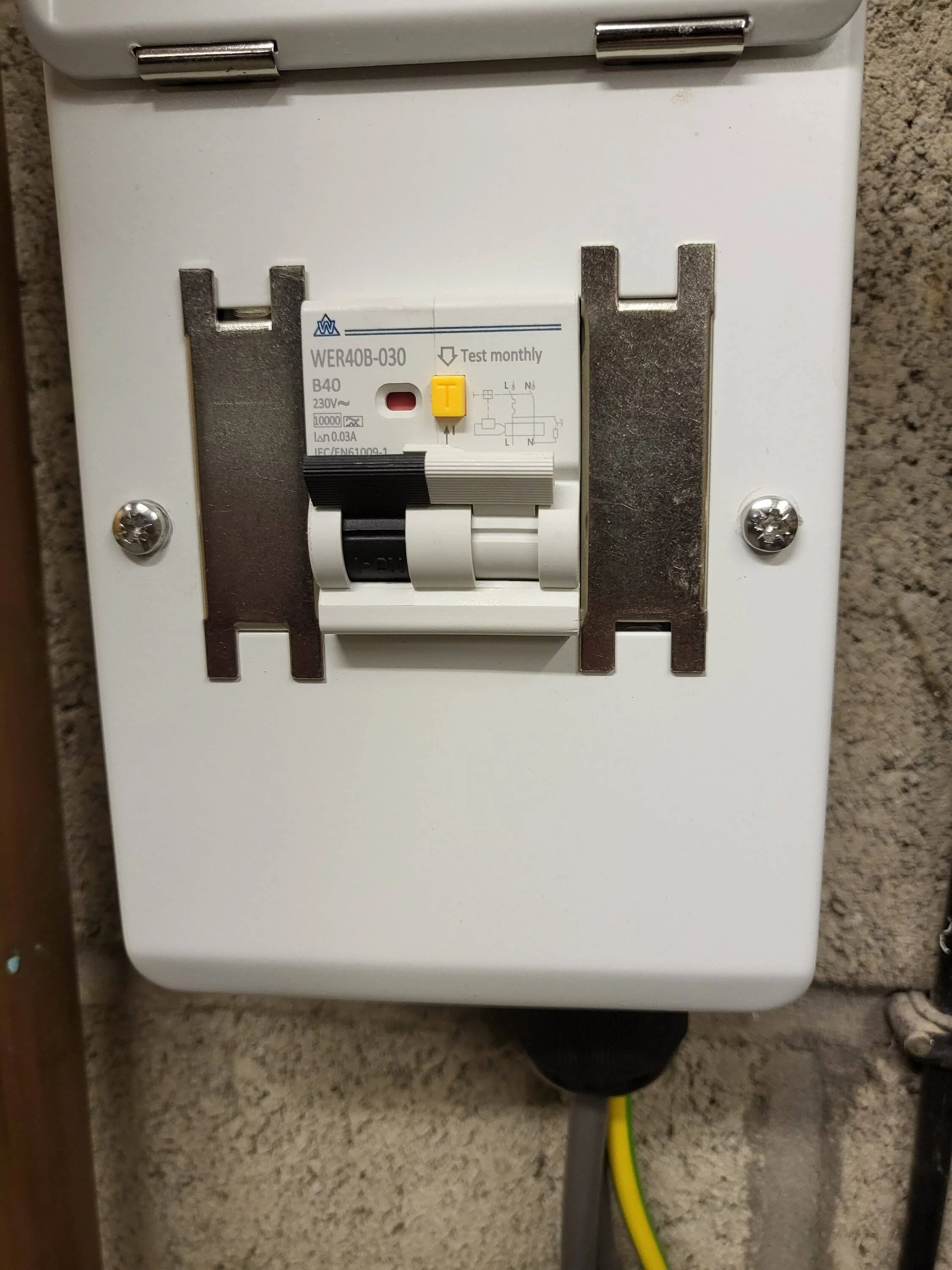

Hi James, can you please let me know what is the white box on the left hand side to the Black matt:e box that you got installed. I think you call this as a mini consumer unit, would you be kind enough to let me know exactly what this consumer unit is, make and model would be brilliant.
Cherryjock
James
May 28, 2023
56
Scotland
Taycan Cross Turismo 4
There is only a 'W' on the metal casing. From the rcd code it appears to be Whitecliffe electrical.

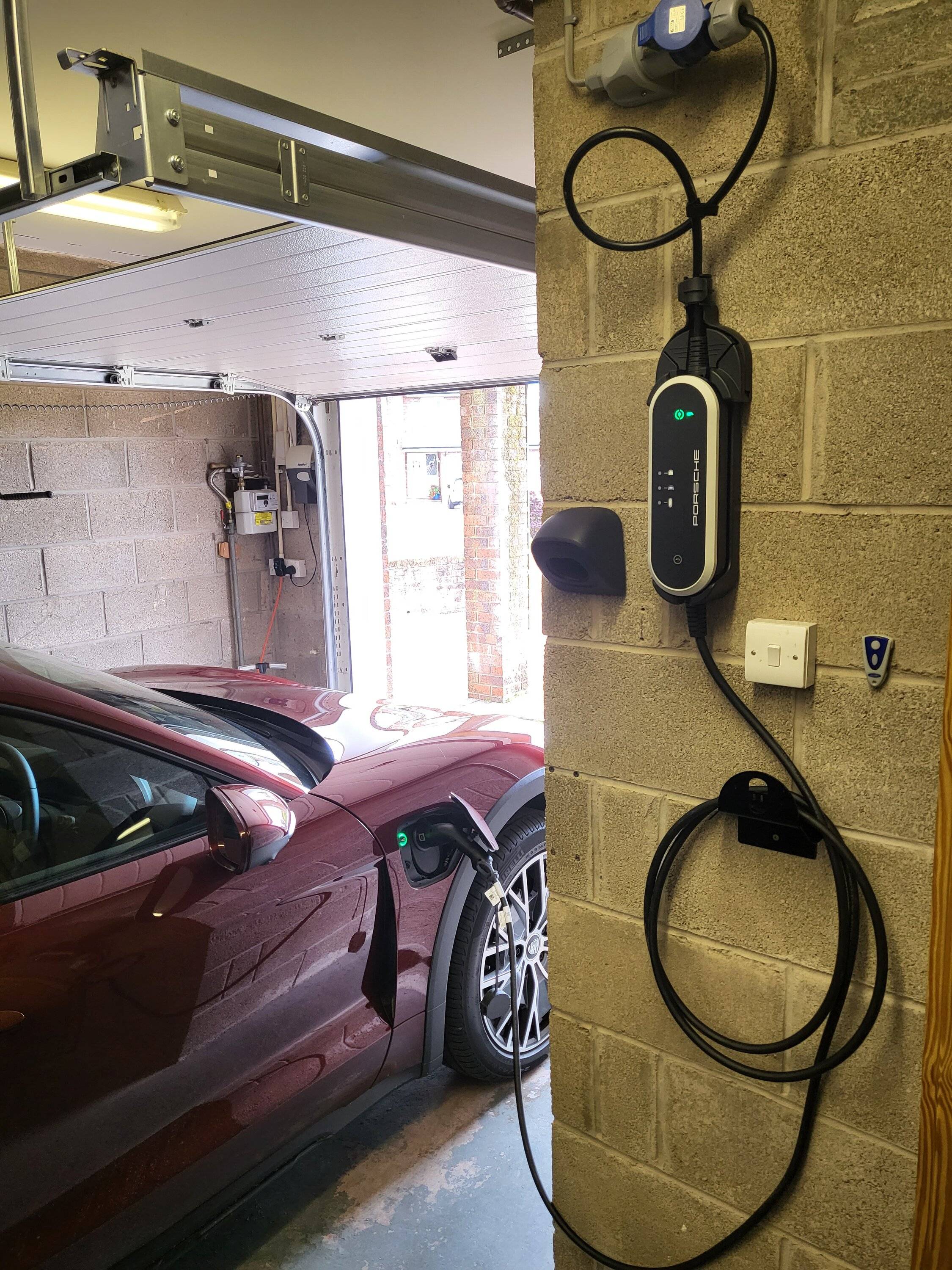

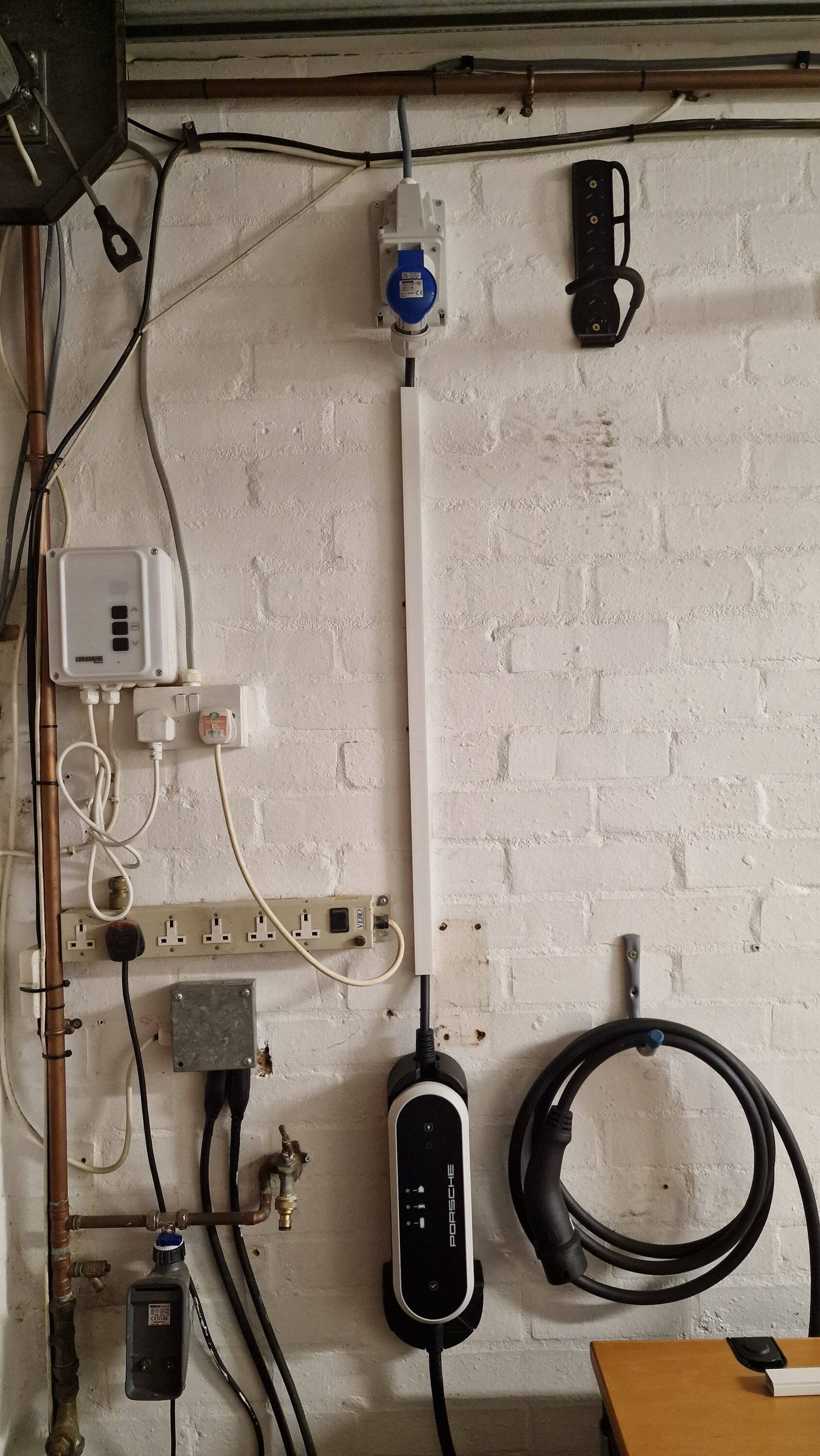

Hello UK members, after weeks of research and valued contributions from everyone here, I have now successfully managed to install my commando plug in order to charge at 7.1 kw - please see picture. After carefully following your guidance, I've managed to get it done at £450 which seems to be the going rate at the moment. Big thank you to Cherryjock , smoothound , Speuk , Midlifecrisis
