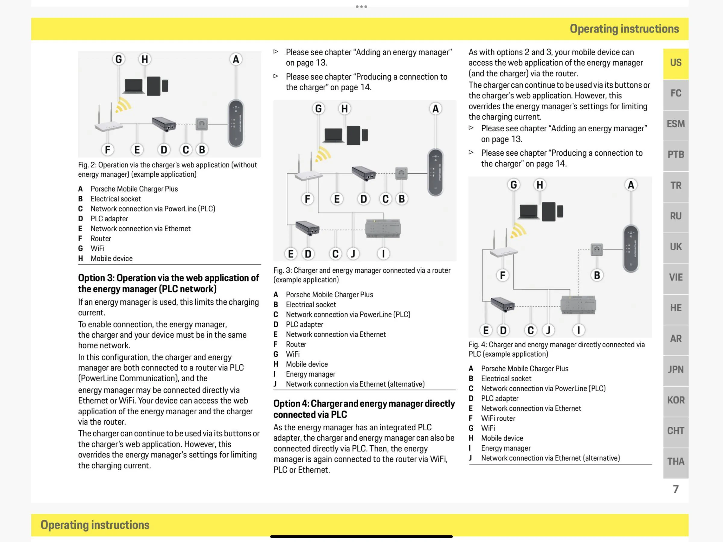

I'm confused with the Power line converter (PLC) setup. The PMC+ in my garage is sending PLC data so I need a receiver/transmitter somewhere in my house.
- I'm on a 240v line which has two 120v legs. Which 'leg' does the PLC data come on?
- the PLC receiver/transmitter I buy from Amazon needs to be plugged into the same leg as the PLC data is being transmitted. If this leg is not the same as the leg which my router is on, is there a PLC 'bridge' from leg to leg which I can put at my electrical panel?
- the PLC adapters on Amazon have ethernet ports. I assume that the PLC adapter I buy at Amazon needs to be collocated with the router?
Last, if I don't need a PLC bridge, it sounds like I need only one PLC adapter?

Thanks for the diagram but it still doesn’t answer the “which leg does the PMC+ transmit on” question. That said, since I don’t need the Energy Manager, I’ll just revert back to my old Juicebox since I’m having problems charging my Tesla with the PMC+. The Juicebox uses WiFi and sends charging data to my power company so I can get special night time pricing.

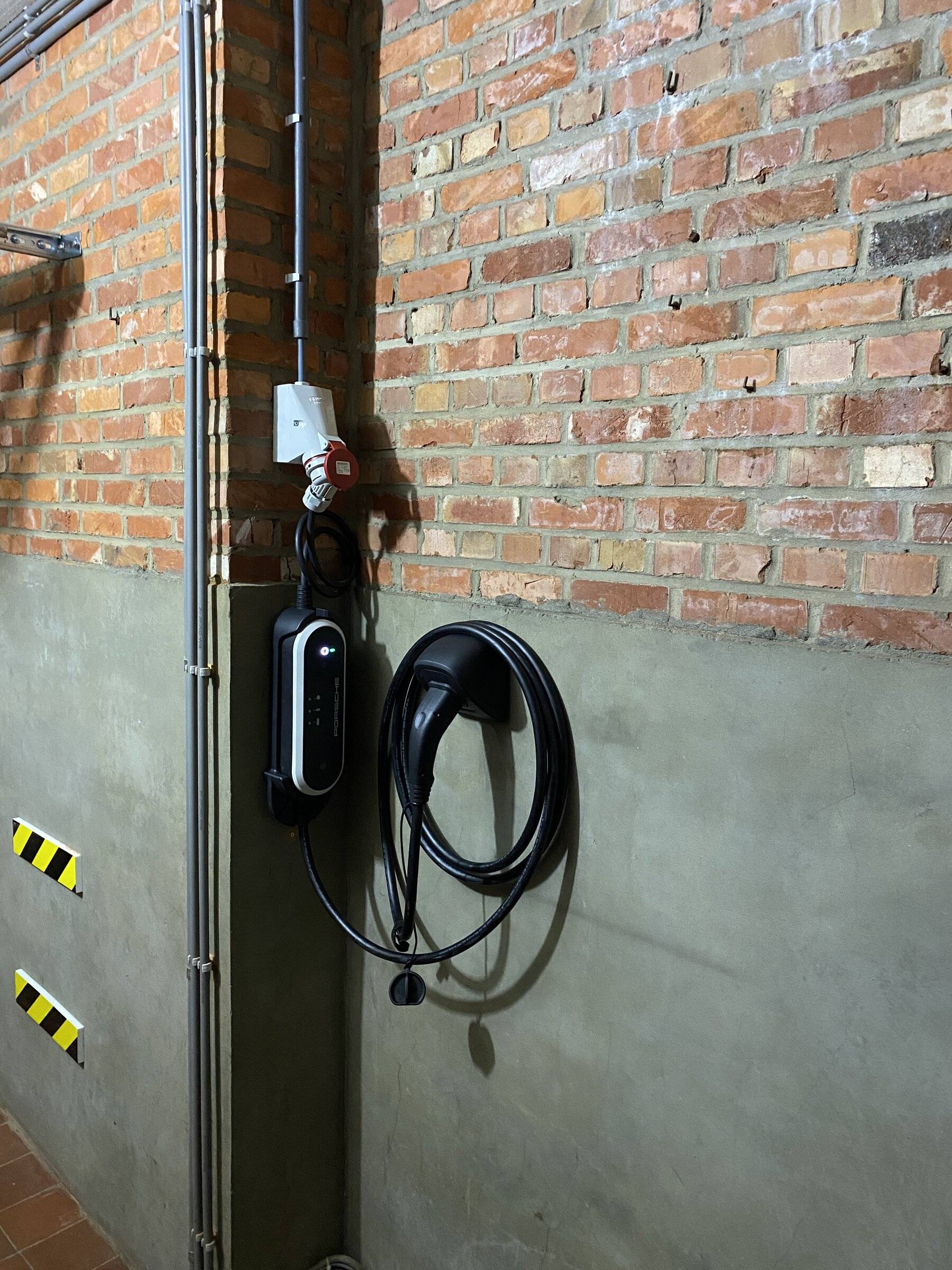

Let an electrician hook up the PMC+ today. Didn't expect the car to come with one since I didn't opt for the PMCC.
Connecting the PMC+ interface over PLC was unsuccessful in my case (not same circuit) also the electrician told me you can only use PLC over the 13A connector (which is useless unless you're willing to wait 72h on a charge, pulled 1.2kW before).
PLC will work over the industrial connector - ask your Electrician to check the PMC+ manual.
No real point in networking the PMC+ in any case - charging is managed by profiles and timers via the car, apps or My Porsche web site.
