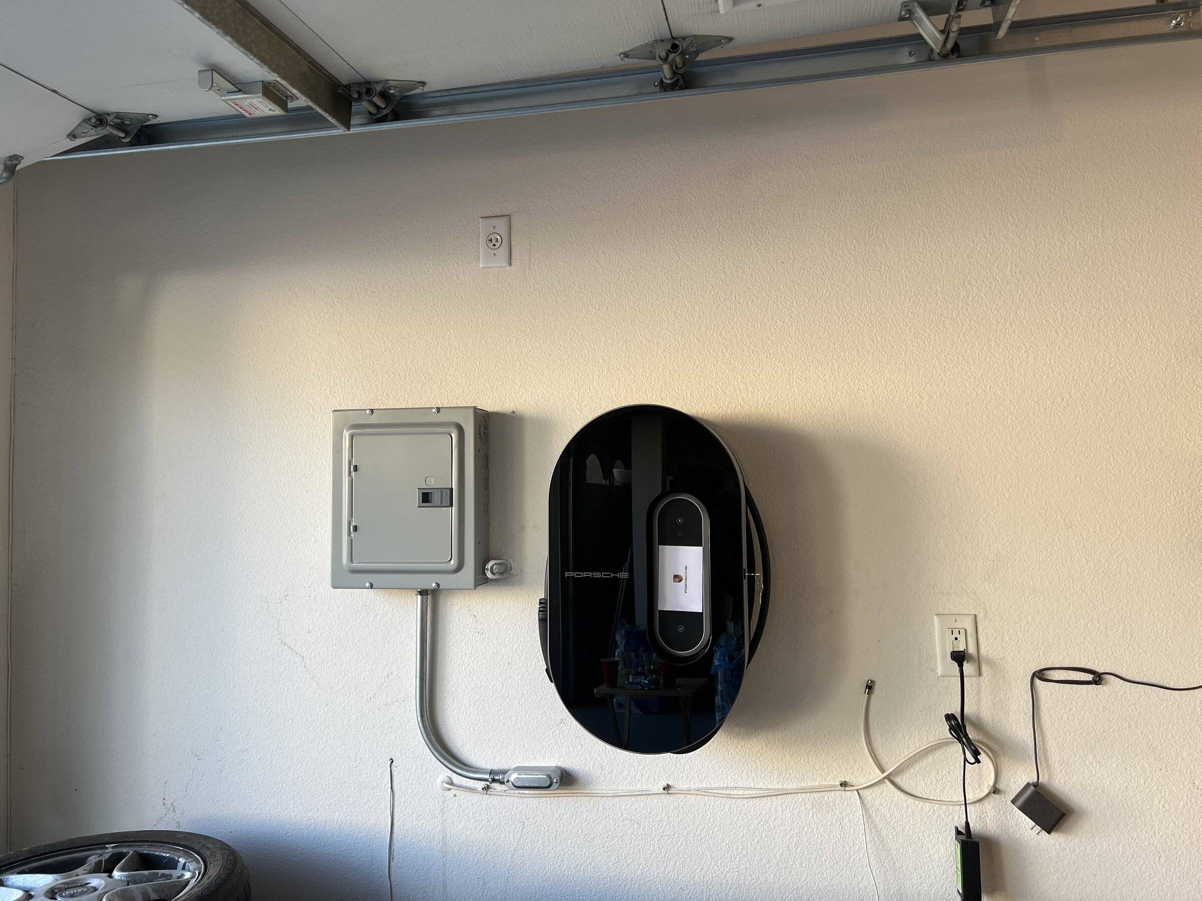

Unfortunately, I had to learn the hard way, that my brand new 2022 Taycan 4S came with a PMC+ that doesn’t have Wifi capability. And I spent extra money to get the wall mount for it as well. What a Joke! ?
That's annoying but your dealer should have discussed this with you and pointed out the differences between PMC+ and PMCC (including that the dock is specifically designed for the PMCC so that it sits flush).
I'm guessing you realise that you can add your PMC+ to your home wifi with a PLC (Powerline Communication) adapter?
Porsche Taycan Porsche Mobile Charger Plus 1643190471933
Once hooked up you can then use the PMC+ web interface (warning: be prepared to be underwhelmed). There is rarely a need to access either the PMC+ or PMCC so you aren't missing out here really.
