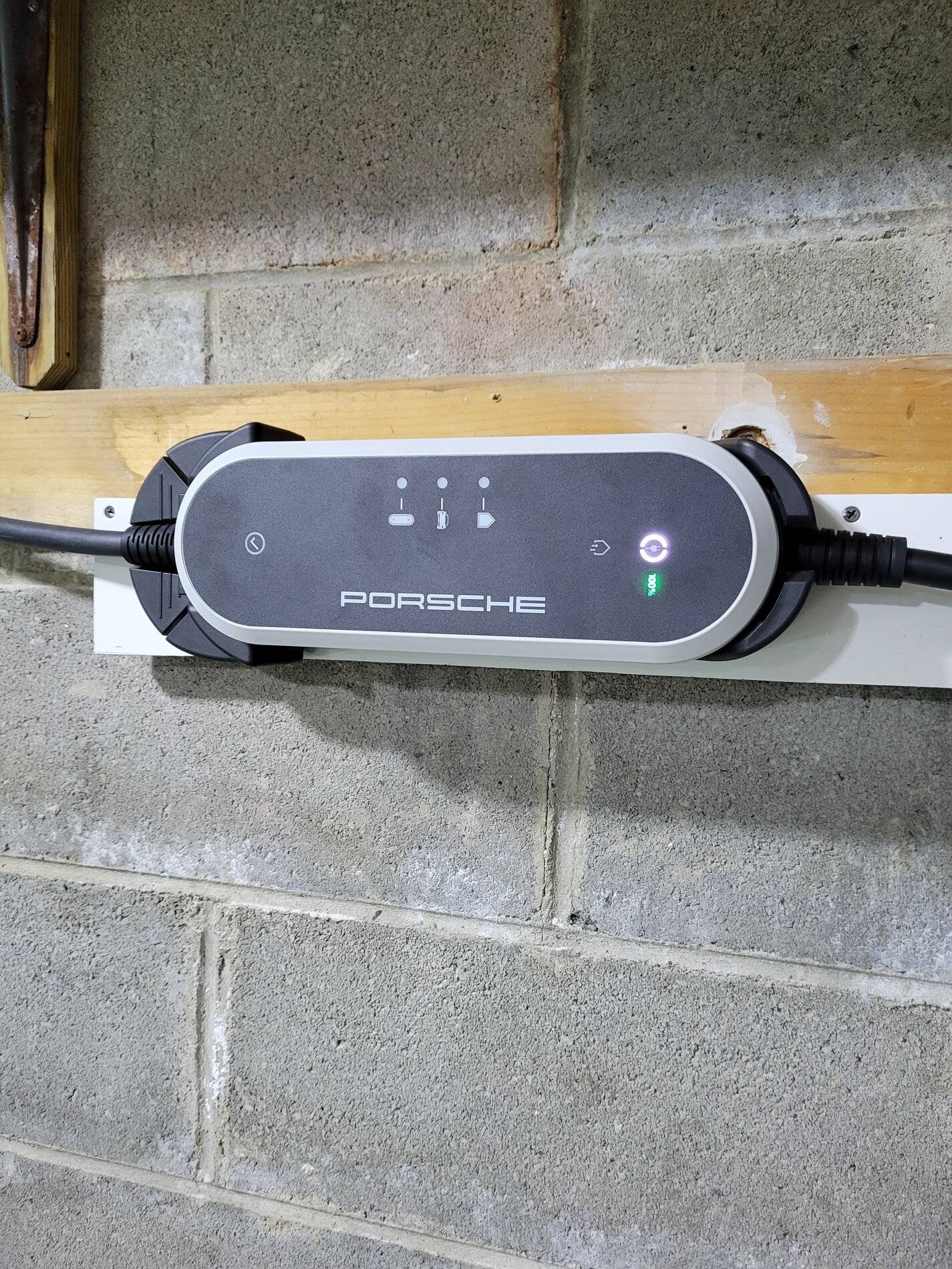

I bit the bullet and switched my house charging over to the Porsche Mobile Charger Plus. Does anyone have any idea how to manage it? It came with a paper with a password, but the instructions are otherwise not great. I plugged it in and pressed direct charge (I'm at 85% now), but it doesn't seem to be doing much.
I think the only settings on the device are whether it charges at 20A or 40A.
It looks like it can interface with some type of external energy monitor over PLC.
It also has a web app, which also requires a PLC connection to access, but I don’t think you can use it to manage anything. Just view data. This access is what the paperwork you reference is for.
Note, I don’t have one yet. I’m just going by the manual that’s available online. But I’m getting a PMC+ with my car (mid/late May...it’s at Emden!!!) and I plan on at least trying to get the PLC connection working, just to see it. If I do, I’ll make a write up for it for others to reference (unless someone already has one I can follow???).
I imagine it’s mostly worthless and not with the effort.

Yeah, that's the same info I got from the manual. Trying to figure out what this PLC interface is lol.
193
7,037
10,539
PLC = power line communication - so you’d need a “device” hooked up to the AC powerlines to then bridge onto your home network - I’d humbly suggest it isn’t worth it - just treat it like a 40 amp “dumb“ EVSE and be done with it.

Without that, is there any way know what kwh it's charging at? On the cheap travel charger I was using before, it would display the temp, amps and kwh at least.
Just that 100% light. It only has two modes. 50% and 100% (with a light for each).
Your 100% light is on which means 100%. So it’s at 40 amps at 240VAC, 9.6kW.
for “dumb” EV chargers like the PMC+ or ClipperCreek you can use the “in car” charging display (0.3 mpm) to see kilowatts
if you tap on the (0.3 mpm) number while it’s charging it will “toggle” to kW
9.6 kW “raw” 240 volt @ 40 amps will show about 8.6x kW “in vehicle”
240 volts @ 20 amps “raw” is 4.8 kW - so I would expect like 3.92 kW “in vehicle” on the center lower console if you tapped on the “0.1 mpm” display during charging.
