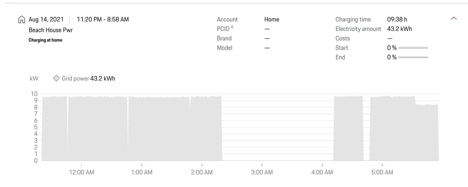

you can note in this screen shot that I have a MY’20 Taycan
Porsche Taycan Porsche Mobile Charger Connect vs Mobile Charger Plus 6C5D56FA-68F9-41E1-8576-53805B8E578A
the PCID/Brand/Model is “blank”
NOTE: my wife’s MY’21 Cayenne also does not provide battery SOC information
this information is only supported in newer Taycan’s…and my model-year 2020 Taycan does _NOT_ display battery SOC or VIN or offer “control” over the charging session - this is also true across the VW fleet to date no VW or Audi EV that has plugged into my PMCC has displayed any of this information on my PMCC
now I see where porsche is going with this, and I applaud the “vision“ - more data is better than no-data - but providing this information to a J-1772 EVSE requires every other EV vendor to “upgrade/enhance/adopt” these extra bits of information - so no Chevy/GM EV will ever do this, Polestart, Rivian, LucidAir, Tesla, BMW, Mercedes, Toyota, Honda etc….
so to date - even other Porsche products don’t support this J-1772 extension and even if they did it’s purely informational
the only mildly interesting and curious feature of the PMCC that slighlty intrigues me is that it can work with the Porsche Home Energy Manager to managed load and documentation hints, but does not confirm or describe, than multiple PMCC’s could be configured to ”share” a load so that you can load balance charging multiple EV’s and no overload a single breaker simliar to other EVSE load sharing feature sets (ClipperCreek share2, Tesla Gen2 wall chargers, Puslar+) - however the home energy manager hardware is not available in North American, and installation procedures and exact feature set are very very vauge.
so far this “feature” seems to only be supported in MY’21 Taycan’s or later - and hasn’t even been implemented across the VW line of EV’s

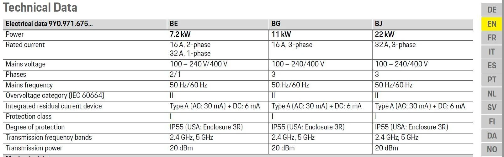

I have the 9Y0.971.675BJ model (by fluke) but don't have 3 phase nor do I have the onboard 22kW AC charger.

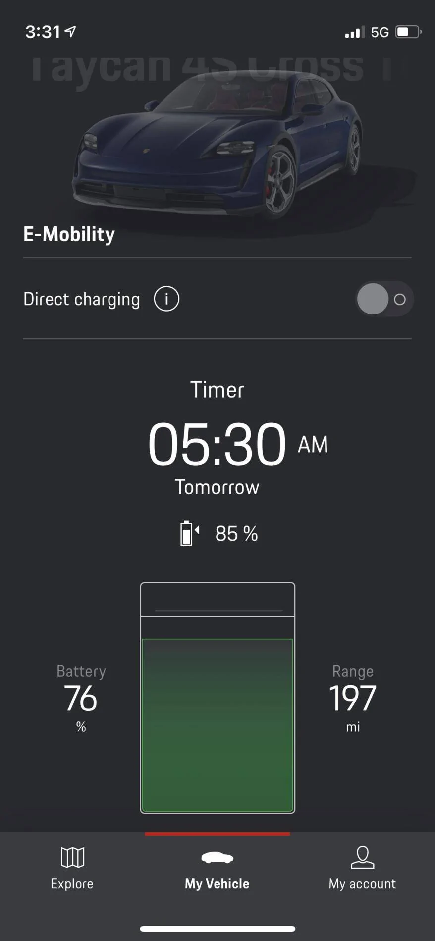

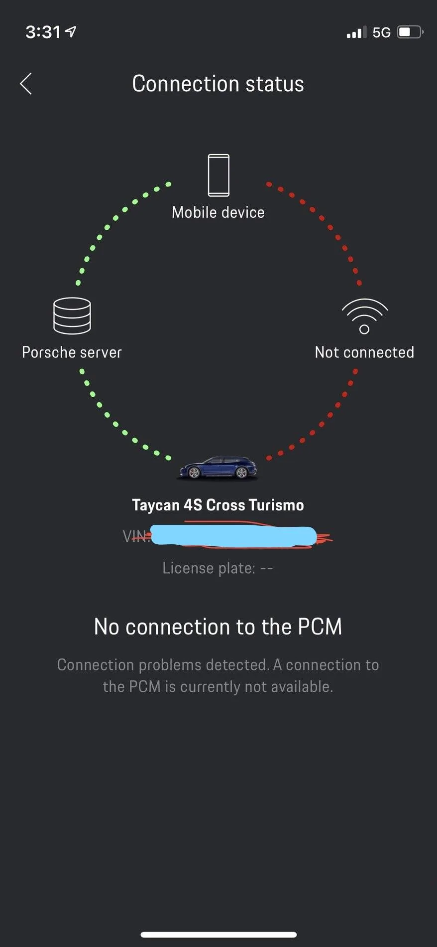

Please correct me if I'm wrong but it seems as though the one feature the PMCC offers, besides the LCD screen, is the ability to check your SOC from the Porsche Connect app even if you are not in close proximity to your car. This because the PMCC will connect to Wi-Fi and ultimately received as data in your cell phone. I'm not so sure I need to see my SOC while I'm on my couch.
Klepper
Mar 24, 2021
414
480
Porsche
I can check my SOC from the connect app even if I am not near the car. The car itself reports the SOC to the App.
Porsche Taycan Porsche Mobile Charger Connect vs Mobile Charger Plus pcm connection_LI
Porsche Taycan Porsche Mobile Charger Connect vs Mobile Charger Plus 1EB05CBF-EFE3-4E65-A9AD-14795CDCB773
193
7,031
10,517
this isn’t the way it works - and you can check the SOC of the car even when not using a porsche charger.
