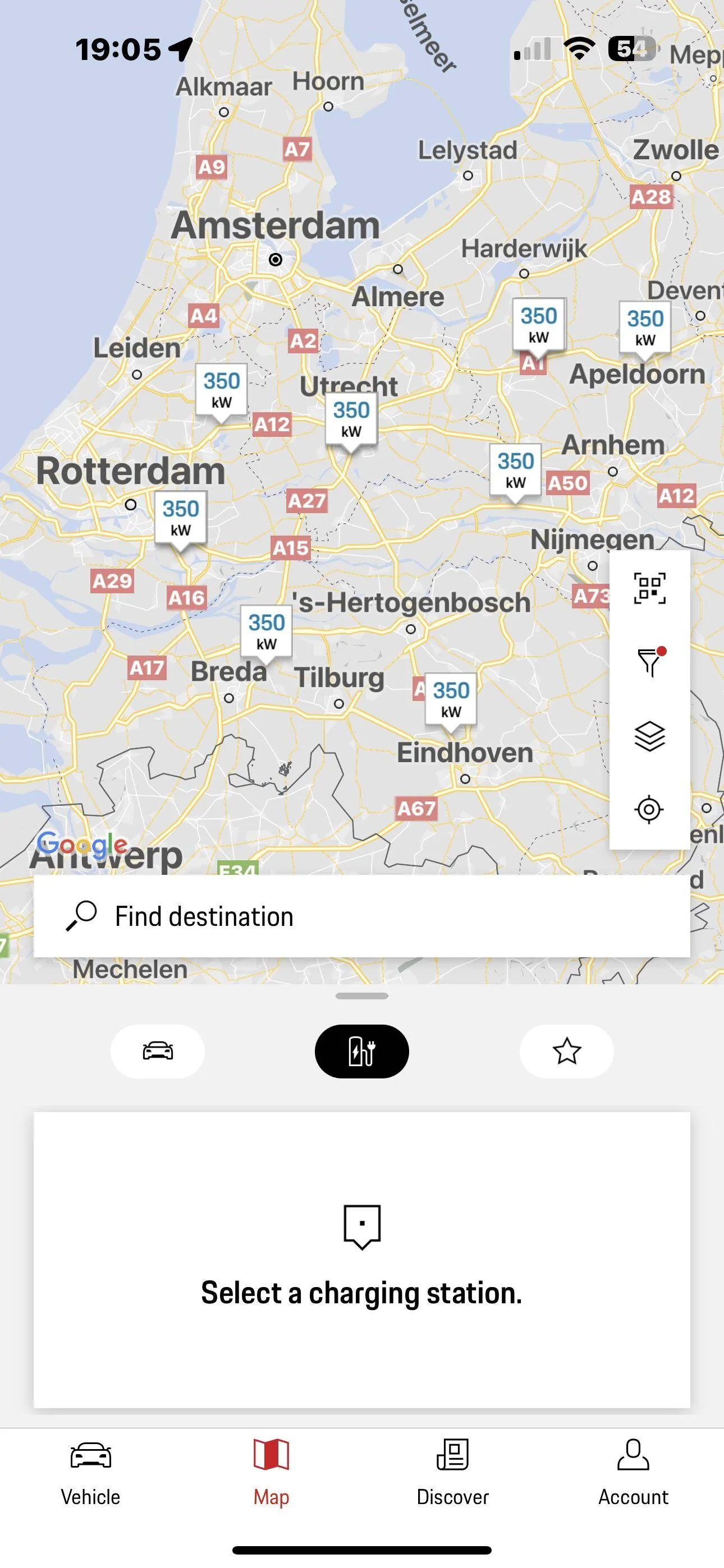

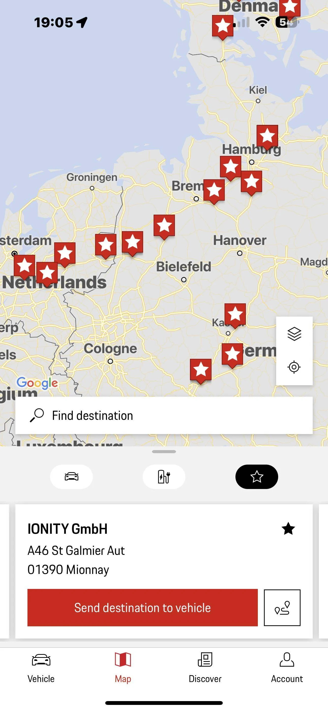

Here is my trip from Hook van Holland towards Denmark!

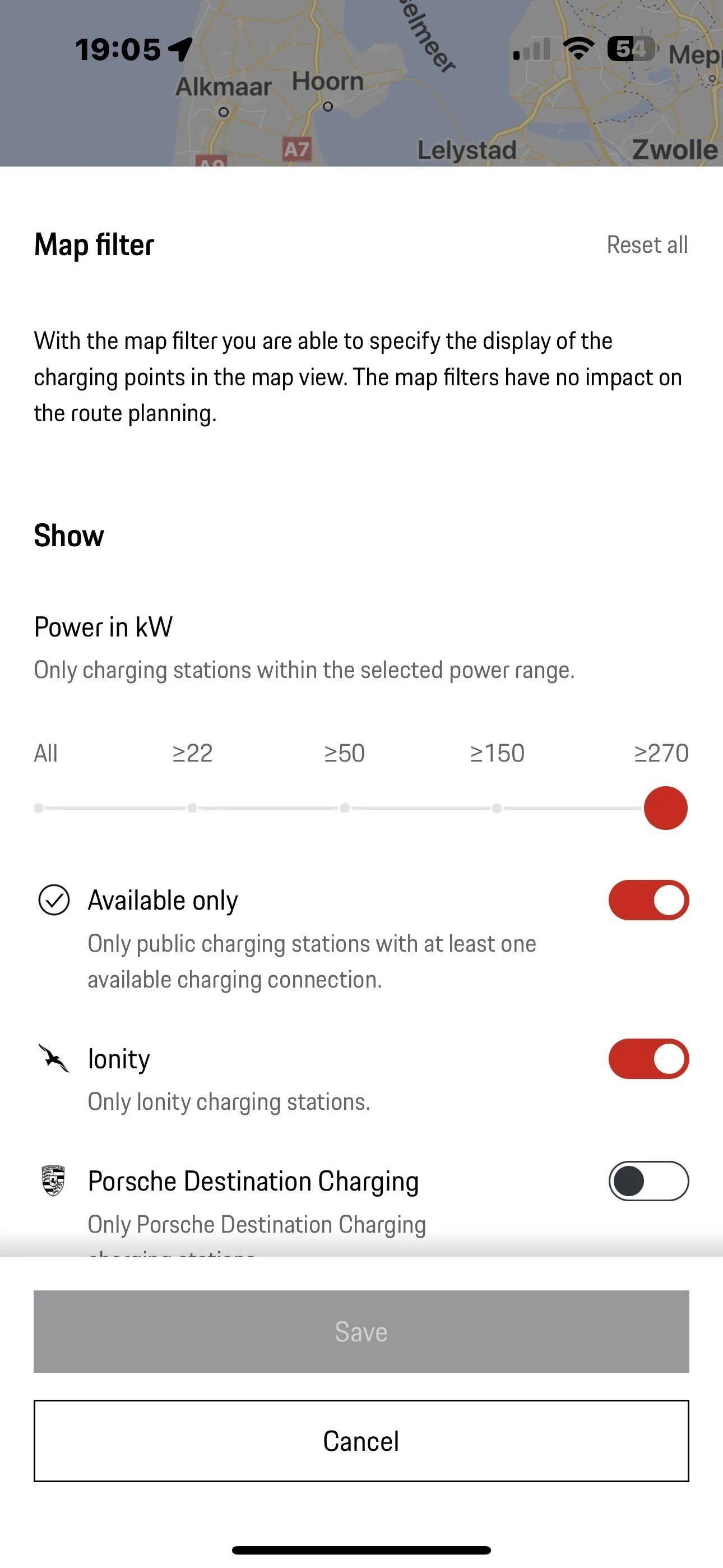

So that’s filtering when looking up charge points, the charge “planner” still doesn’t take the filtered only results into account when planning a route. I want what you did here to be stored as a default for charge planning, not only for looking up nearby stations manually.

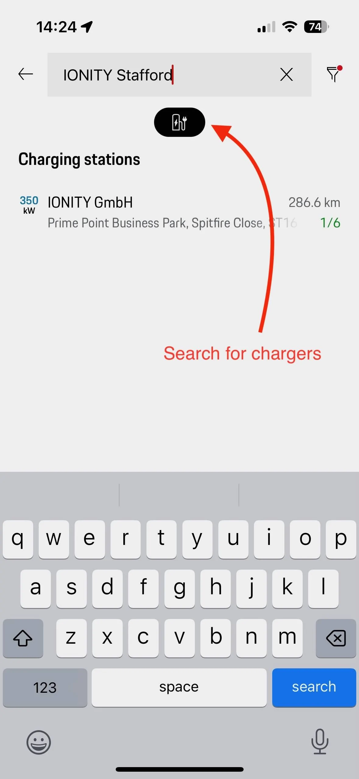

https://www.taycanforum.com/forum/threads/2500-km-to-finland-and-back.17239/post-265251
The way I do it today, is plan out the route on ABRP and then transcribe that route into My Porsche, making sure to search (using the charging filter) for the IONITY stops I want to use and then send them to the car.
It's vital that when searching and selecting the chargers in My Porsche that you do so with the "charging station filter selected" – so they get sent to the PCM as charging stops and not just waypoints.
Then PCM will plan the route with those charging stops in mind and will "do the right thing". All this could be removed if we could just filter from within the PCM itself.
