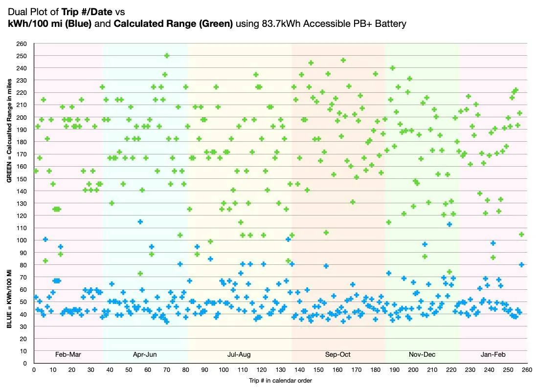

Porsche Taycan Charge Range and Efficiency - One year's data Screenshot 2023-02-17 at 2.03.16 PM
This chart uses reported kWh/100mi or energy used (Eu) in blue to calculate a predicted 100% battery charge (from actaul 83.7 kWh) range (Rk) in green i.e. of course this assumes constant level of efficient/inefficient energy draw from the battery:
So Rk = (83.7/Eu) x 100
e.g. 37.7kWh (my latest Eu number) would give a calculated range of 222 mile range. This is 23.6 kWh per 100 km.
A 60 kWh draw would give a range of 139 miles or in metric 37.5 kWh per 100 km.
This method of calculating the range is of course impacted by my very inefficient short trip data (based both on driving style and on my trip length-duration data). The predicted range data (green) calculated from the recorded per trip consumptive kWh’s used (blue) go from as low as 70 to a high of 250 miles with the bulk of the data between 160-220 miles. The longer range predictions here (esp. from 230-250 miles) are clearly tied to the 10 or so longer (over 75 miles), more efficient trips and the chart just re-emphasizes that trip length and driving style have a fundamental control on any ‘predicted’ ranges whether based on the PCM post-charging calculation or, as in this case, derived from consumed kWh per trip data and remaining capacity of the available 83.7 kWh battery.
The bulk of the ‘predicted’ ranges here are very low but these data must again be regarded as a more pessimistic use scenario i.e. they are based on scenarios which assume I would continue to drive very short distance/duration trips at low average speeds in Normal Mode with full AC for a full 83.7 kWh usage. The key point here being that you should not imo consider short trip derived range predictions as any useful metric of your car’s ability to do far better mileages during long range driving.

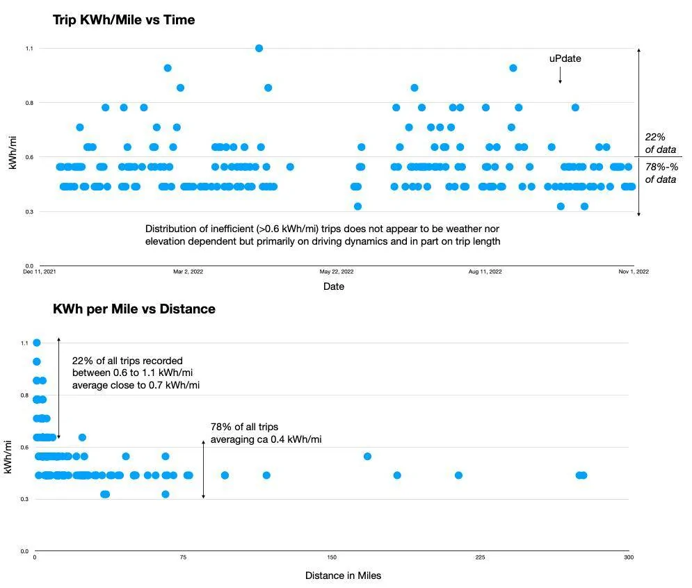

I can fairly confidently state that in my usage case that the combination of trip length and driving style are the principle variables controlling my range predictions vs say impact of weather, terrain, load etc., as I have driven the car near 100% of the time with these other parameters essentially fixed - they being:
AC on full,
21” wheels with summer performance tires
Texas low relief terrain (minimal elevation gains)
40:60 time between 1 vs 2 person load
Full seasonal cycle data
etc.
Overall my driving stlye can be described as ‘inefficient’ as I drive very ‘purposefully’ (not slow!), 90% in Normal/10% in Sport mode never using Range mode, always quick from a standstill, always with AC on, trip history dominated by short trips etc.

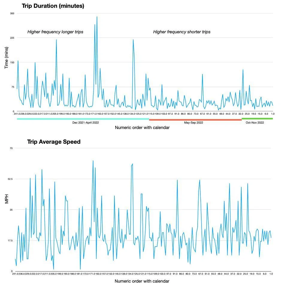

The next few charts will be updated to present date but currently showing data to Oct 2022. Whilst I have not focused on speed it of course plays a huge role on range prediction, esp. once you go consistently above 70 mph.

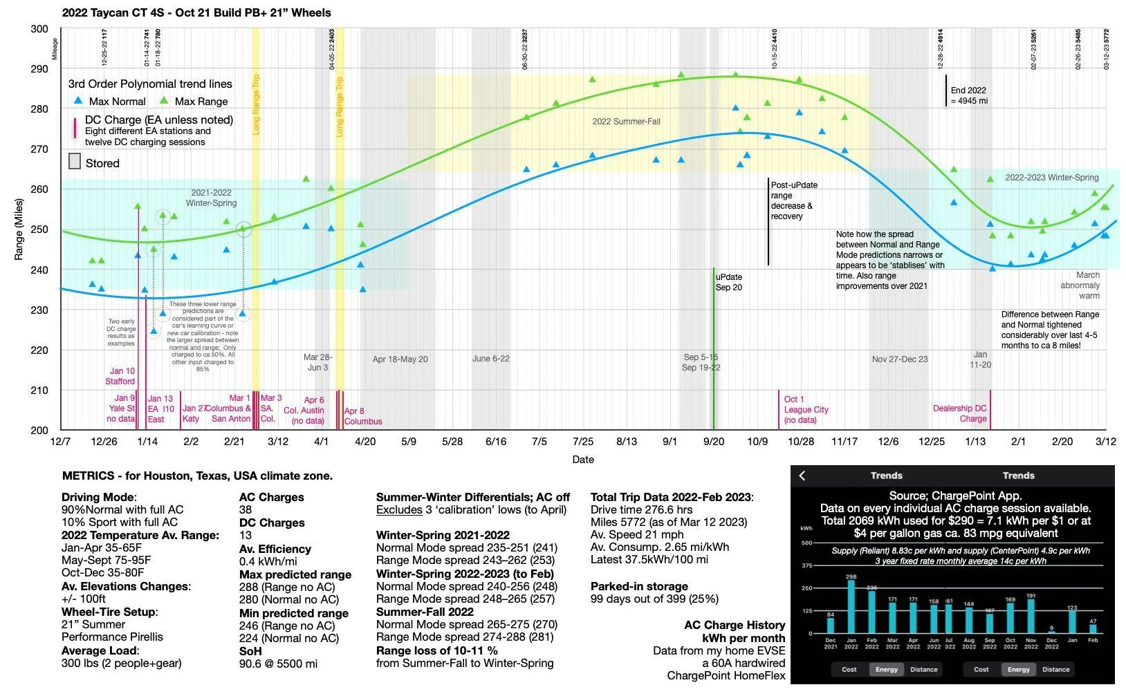

Porsche Taycan Charge Range and Efficiency - One year's data Screenshot 2023-02-17 at 2.03.56 PM
Porsche Taycan Charge Range and Efficiency - One year's data Screenshot 2023-02-17 at 2.04.09 PM
Porsche Taycan Charge Range and Efficiency - One year's data Screenshot 2023-02-17 at 2.04.18 PM
Here is a chart showing the charging history of my car and the PCM's calculated 100% range (83.7 kWh) in both Normal and Range Modes with AC off in both cases (and this despite my typical short trip lengths through the year).

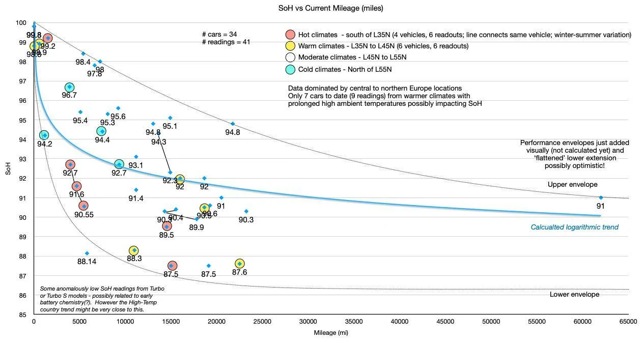

Thought I'd add this in too but a bit off topic - does potentially highlight hot weather climate impact on Soh (being more negative) - from a separate thread here:
https://www.taycanforum.com/forum/threads/baseline-for-hv-battery-soh-on-delivery.12815/
Porsche Taycan Charge Range and Efficiency - One year's data Screenshot 2023-02-21 at 11.48.48 AM

Updated the charge history chart just to emphasize the tightening gap between the Range and Normal mode range prediction curves in my second year Spring cycle.
Quite noticeable and in fact the difference in 'predicted' ranges is now only ca 8 miles - something many pointed out post-uPdate and based on other Porsche updates to the behaviour of the electric motors in these separate modes. I do suspect in 'real-world consumptive' driving that Range might ad a few more actual miles than this but have not tested that a as yet.

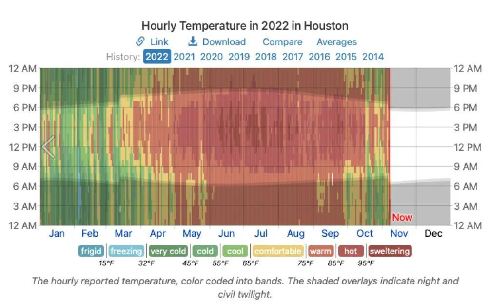

TDinDC
Jun 25, 2022
1,066
1,277
Washington, DC, USA
Thanks. Interesting. While a matter of perspective, Houston is comparatively warm all year round. What are the temp swings? Might be too much work but that would be a great addition to date axis of chart.
