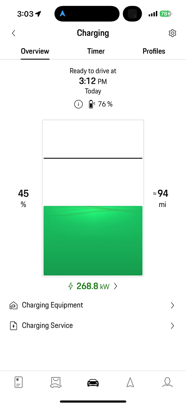

I haven't seen 265kW charging in a while... possibly since the 3885 PCM update.
I've reached 200kW for a short while last weekend at a Porsche charger; but not a bit more. Despite the battery being at 35°C and <40% charge. Which should be ideal for fast charging.
chun
Feb 4, 2024
2,341
2,102
Taycan Turbo 2020, Cayman GT4
You need to be around 10% to see anyhing above 240kw.
8-12% from my experience will give you 270kw or even over that, until about 30-35%.
If you don't start around 8-12%, it won't give you that. Even starting at 20%, it will only take 240kw max. Starting below 8% will also not give you max charging speed for some reason.
I got last weekend on my way back from basel at a gofast charger 276kw
I assume you already checked if you have the battery saving turned on? It might be worthwhile to turn it on and off again, as some settings forget their state once in a while
