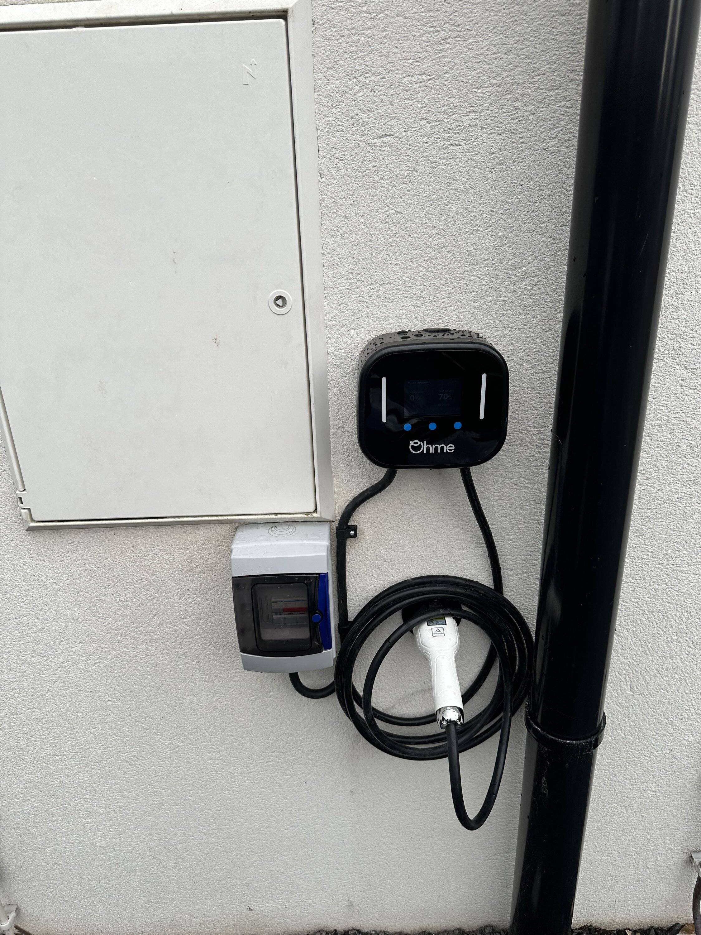

Thanks so much…. Yes I’m a moron when it comes to this kind of stuff… changing a plug was about the height of my prowess and that’s not even needed anymore lol…. They have the Ohme charger straight off my meter box outside I’ll post a pic so not sure I can even do what you advised !

No problem.
Not sure what's behind the box but if it comes off you should see the socket but again an Electrician might be useful.
I'm hoping it's not hardwired.

It is hard wired to a breaker located in the junction box, the Ohme Home Pro has the option of 5m or 8m tethered cable. So no option to use another charging device unless you get an electrical to remove the Ohme and install a commando socket which means you just removed a £1k Ohme install.
