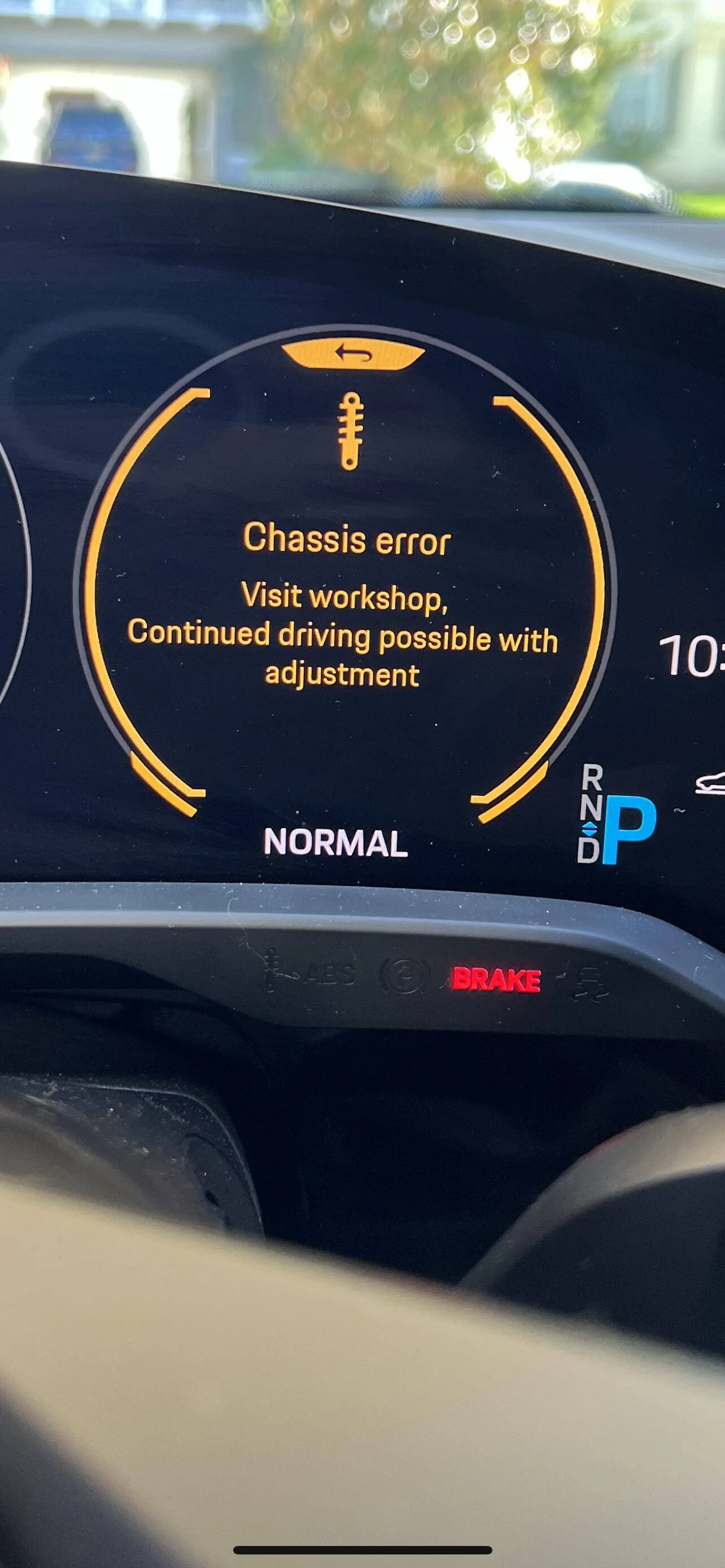

Got the same warning just now driving home from the gym…2024 CT4S

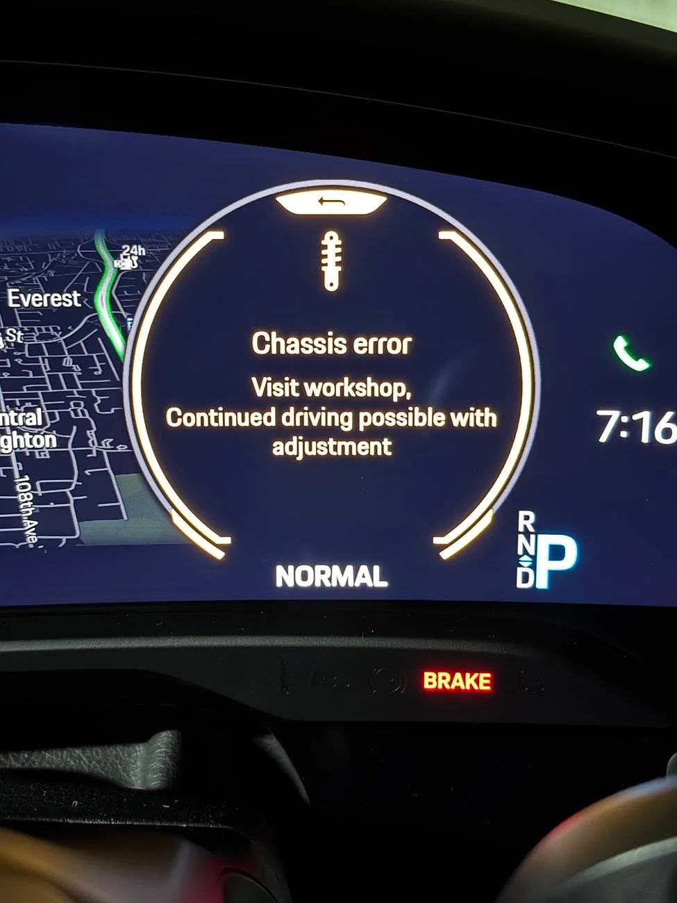

My turn on this one. First real non-recall issue I’ve had on my MY23 GTS. Stuck in normal mode but drive feel is notably soft now. Nose dives on a hard stop. Going into the shop tomorrow morning.

Failed PASM possibly

Knock on wood, but my warning
went away after restarting the car a few hours later and hasn’t shown up again since Oct

Mine has been consistent after a few restarts I’m afraid. Active wood knocking apparently not helpful in my case.

Suspension bellows on one side of the rear suspension has failed. Part ordered, optimistically work will be done this week.
