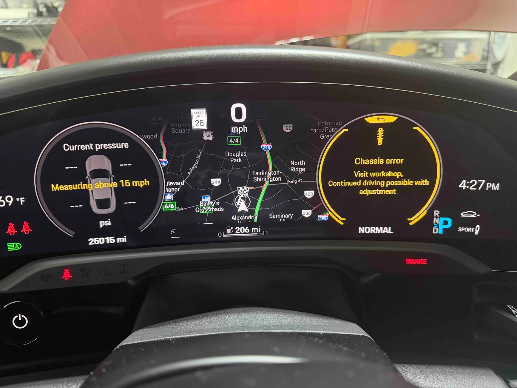

I received the Yellow Chassis Error during my round trip from VA to MA. My Taycan will be in the shop later this week.
The Taycan is still level and is not slanting to one side. I did notice a difference when traveling over bumps on the highway right after the chassis error was displayed. In Sport mode, instead of a vertical up-and-down motion, I felt more of a left-to-right motion, and it did not bottom out. It did not adversely affect the handling.
Porsche Taycan Some odd bugs lately, chassis and electrical error. ChassieError
Update: Root Cause: Front wheel speed sensor cable. The faulty driver's front wheel speed sensor cable was replaced, and the issue is resolved.
