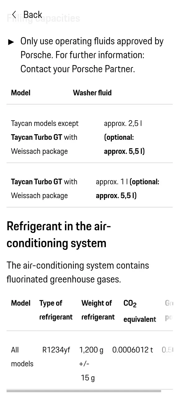

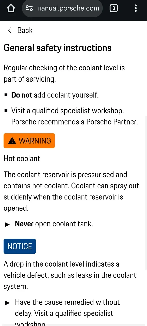

Owner's manual....you should not tamper with the coolant (only for the batteries and must be dealer serviced). Do you really mean "coolant"?
Porsche Taycan Coolant capacity Screenshot_20251113_161609_Chrome Beta
Porsche Taycan Coolant capacity Screenshot_20251113_161808_Chrome Beta

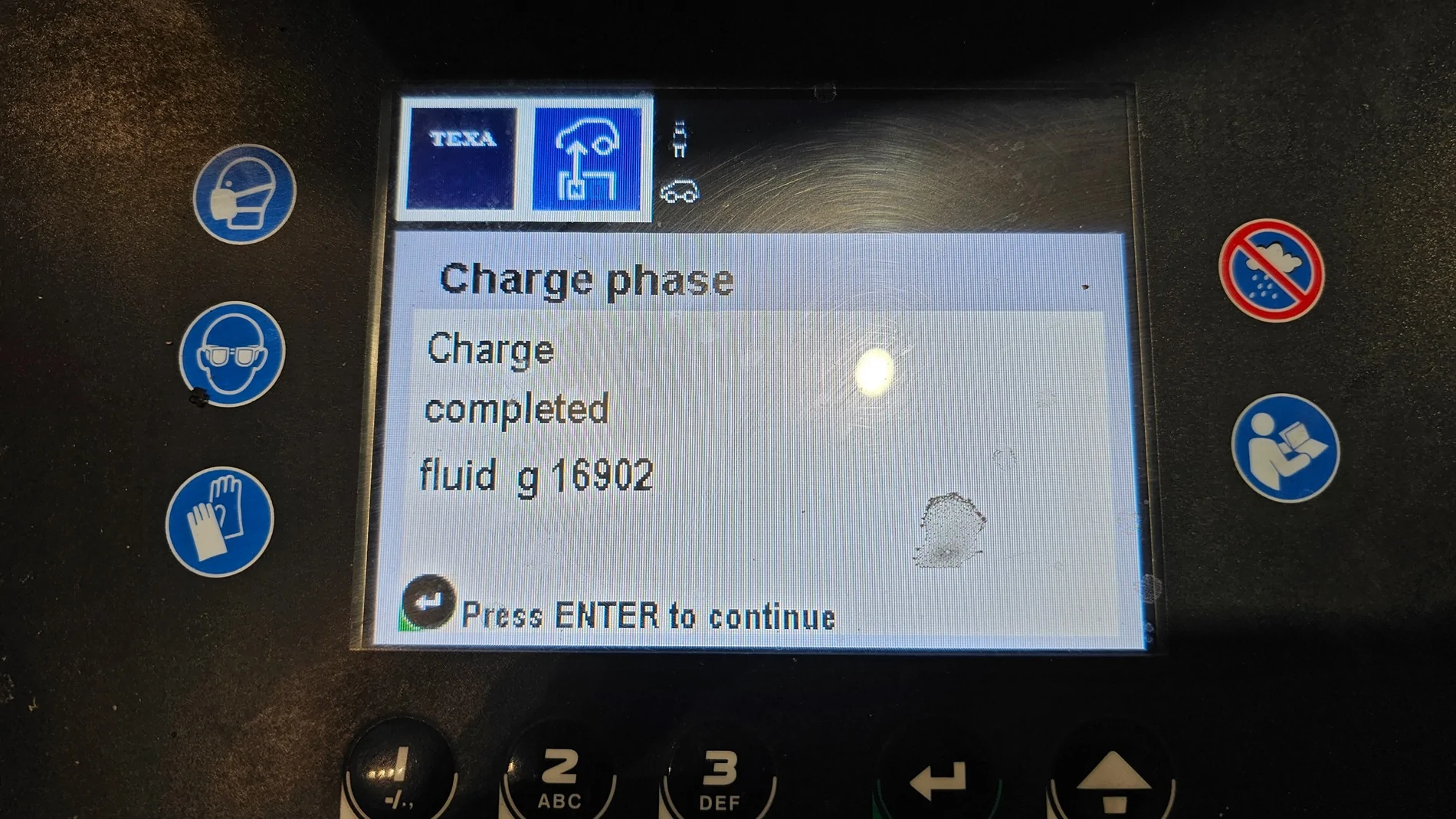

Biggest issue is bleed procedure - a full vacuum of the systen to get any air out and then fully fill the system is imperative. You had PIWIS so the bleed procedure - opening all the valves and circulating the coolant - is great; but it's done with 2 bar overpressure to ensure it bleeds fully.
Full drain (under pressure) and vacuum fill (the only way to do it properly) then 2 bar over-pressure bleed I get around 17 litres in.
Porsche Taycan Coolant capacity 20250726_120817
