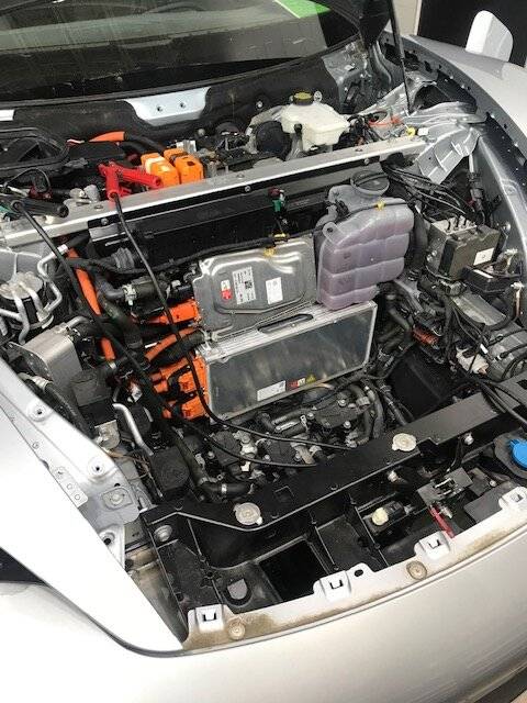

The cooling system is in the bottom of the frunk. Here is a picture of my car when I was getting the 22KW charger upgrade. My experience with independent shops have been they won't work on a Taycan because they don't have an up to date PIWIS tester. Good luck.
