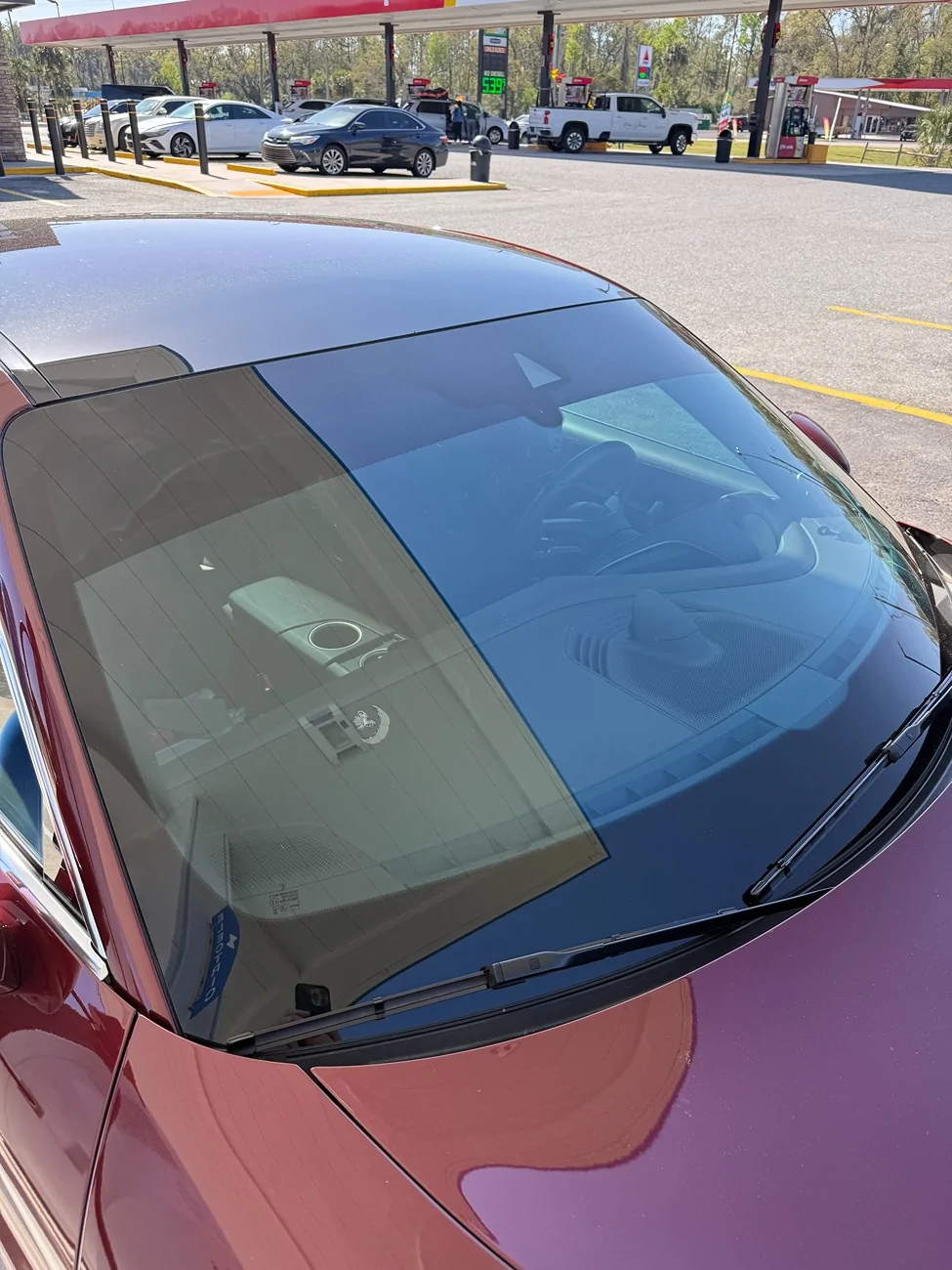

My rear winshield was done 2 weeks ago. Total 4k between parts and labor (insulated glass so a bit more expensive). Insurance covered all but $500 deductible.
