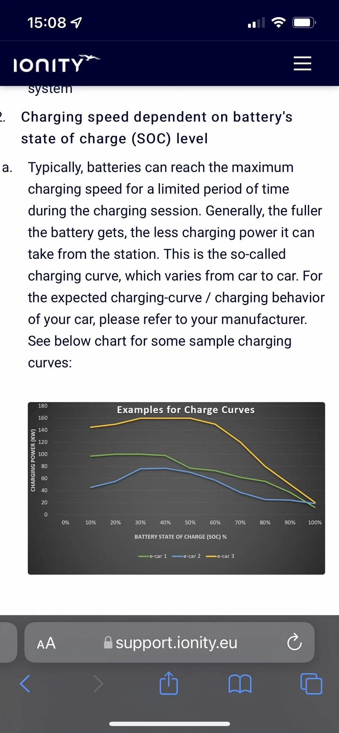

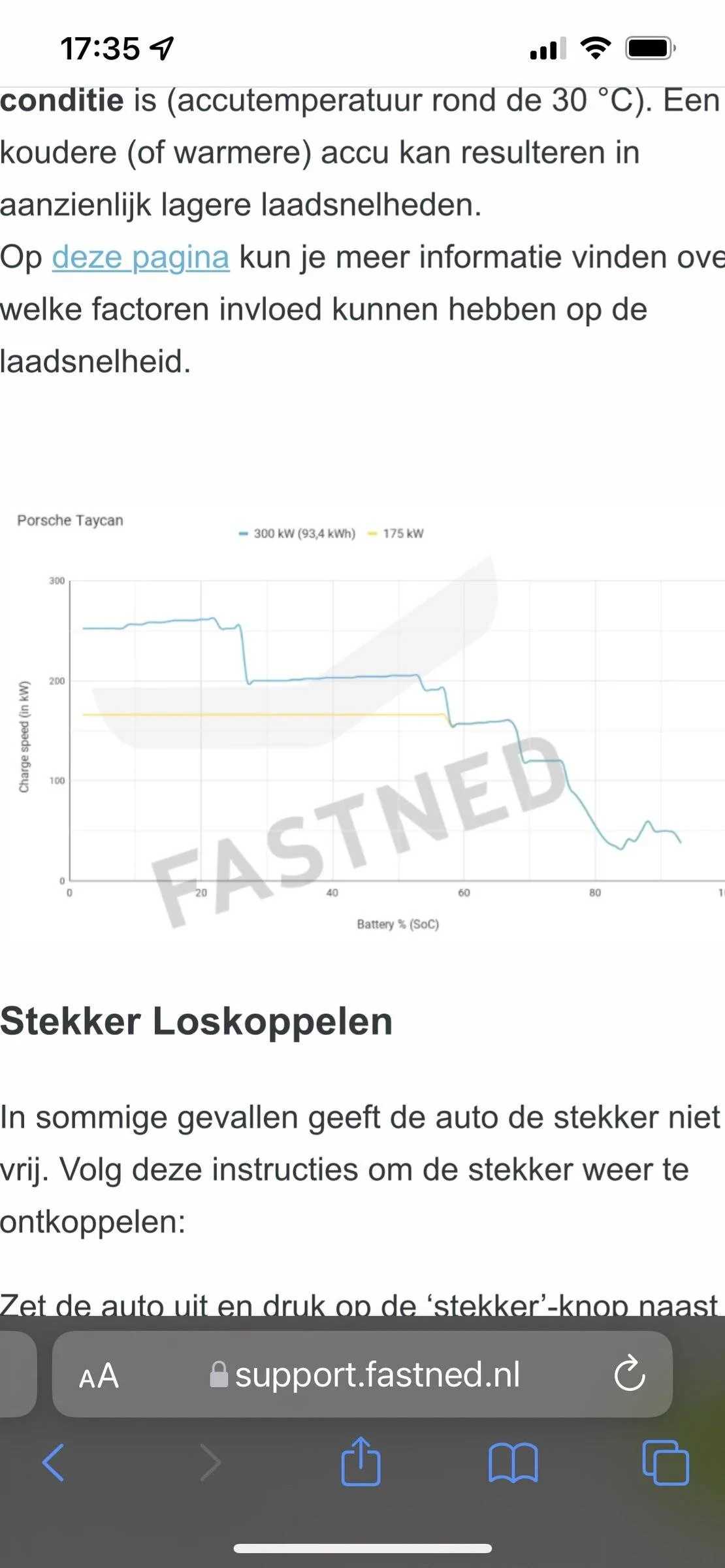

Did you try pre conditioning the battery by navigating to the charger? Driving the car doesn’t warm the battery enough. And highest charging speed is with low SoC. Did you try it at 10%. There is another thread on this subject
Porsche Taycan Cross-Turismo after 3000 KM 169DF256-CC24-470B-9217-2C4CB99971E3
Porsche Taycan Cross-Turismo after 3000 KM 8AD81CC9-1F1D-4237-8E44-93A584F21CDF
Reactions: B61
