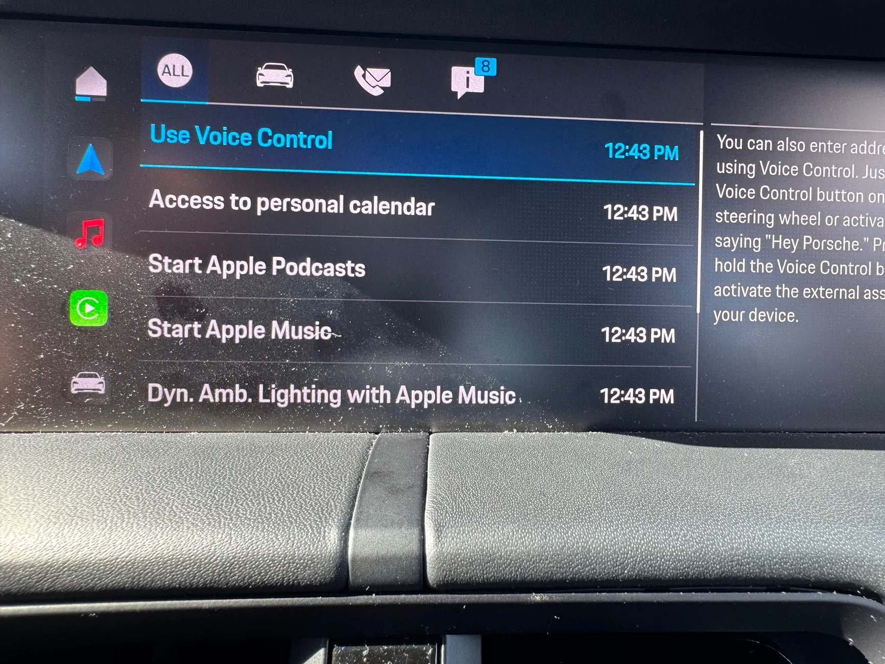

Have had my 2022 CT for a little over 3 months and for the most part really enjoying the car.
Tried to search this in the forum but not getting the right terms to see any answers, so apologies if this is “old hat” and can someone point me in the right direction.
For the past 10 days, every morning about 15 minutes into my commute I get a series of “dings” and notifications of all the wonderful features that I can read about/hear about/try/reject.
Porsche Taycan Daily “notifications” IMG_3384
I had thought this was done when the car was delivered, but I dutifully went through it all 10 days ago, but same notifications pop up regardless of if I acknowledge or not.
Just an annoyance but what is going on?

I vaguely remember something about this. I believe you can disable these suggesting somewhere in the PCM but I can't recall where that is. These notifications are annoying! If there are 3 dots in the lower right hand corner of that screen you should press them and see what options are available.
I’ve been having the same recently, literally every day. It’s bloody annoying!!
Easy fix. Hit the "Notifications" tile. 3 dots on the lower right get you into the "notification center" (or some label close to that). You can turn off notifications you don't want to receive. I think turning off "information notifications" did the trick. I haven't gotten a single idiotic message of the kind @Merlin9 showed.
Granted the owner's manual sucks, but it's in there.
