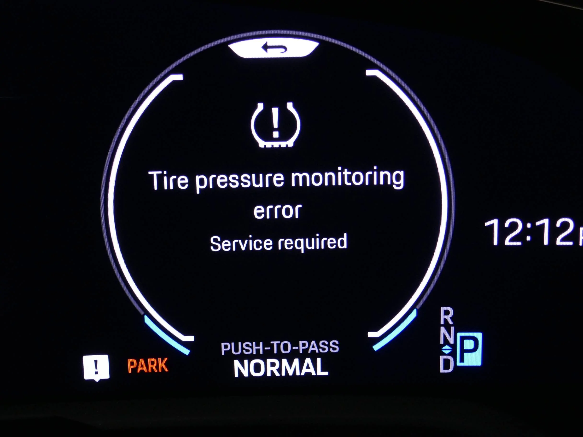

Took my 2025 4s to the local Discount Tire shop and replaced the stock 19" wheels with 20" forged aftermarket wheels. They installed new Tire Pressure Monitors. The new TPM's failed to communicate with the car, and after two attempts, changing wheel size and tire type each time, the car decided it had had enough and a "service required" message appeared on the dash display. The car no longer attempts communication with the TPM's. Back to Discount, where they agreed to order Porsche specific TPM's at no charge. They tell me it will be a few days.
Does anyone know how I can reset the car to eliminate the "service required" notice, or is my only option to visit the dealer?

My guess would be once the J1.2 TPMS are fitted and the car is switched off for 30 mins or so it will recognise the new sensors upon start up.

What brand TPMS did the tire shop use? Years ago I had difficulty getting aftermarket TPMS sensors to work with my 2007 Cayman.
