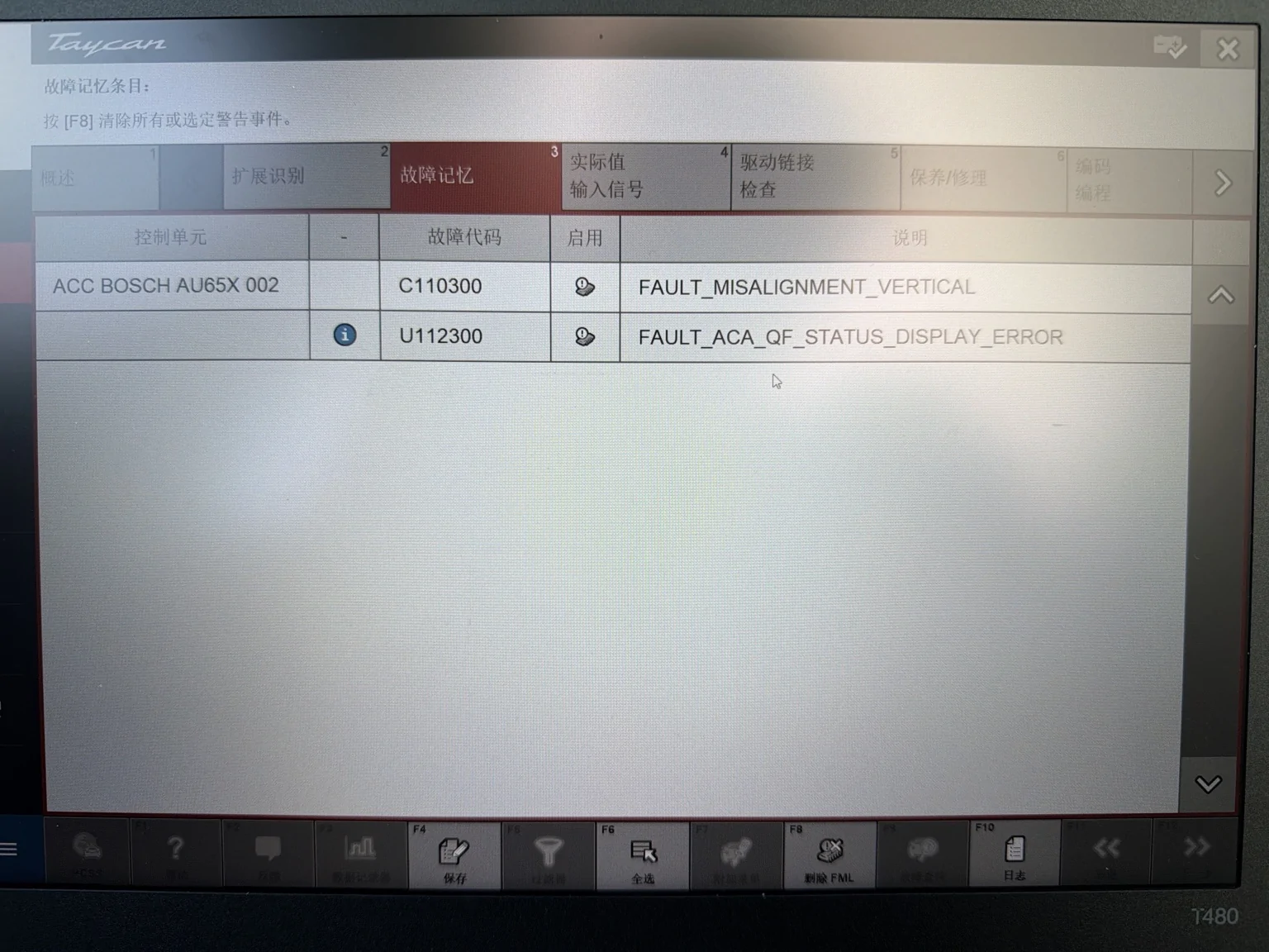

This morning I received a warning indicating that ACC cannot function properly because calibration is required.
I would like to know:
Is it possible to perform the calibration myself?
And how can I remove the front cover panel?
Because I forgot to raise the front bumper while parking to charge last night, it hit the curb — I suspect this is the cause.
I read the fault code using PIWIS, which indicates that the ACC requires vertical calibration.
