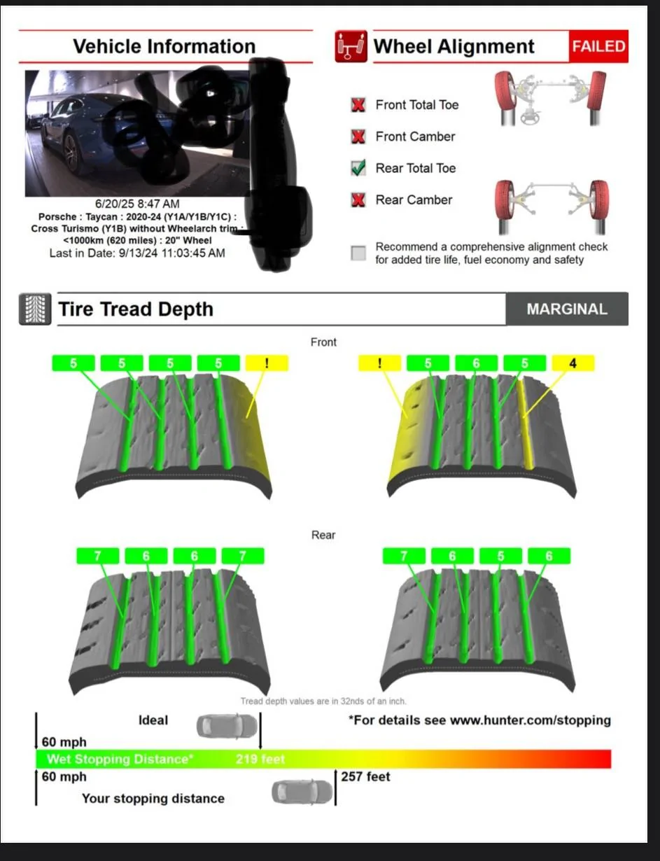

Getting new tires. Being told I need alignment. No noticeable pull when driving.
thoughts?

would it help to align it in range mode so that it would have less negative camber when ride height is normal?

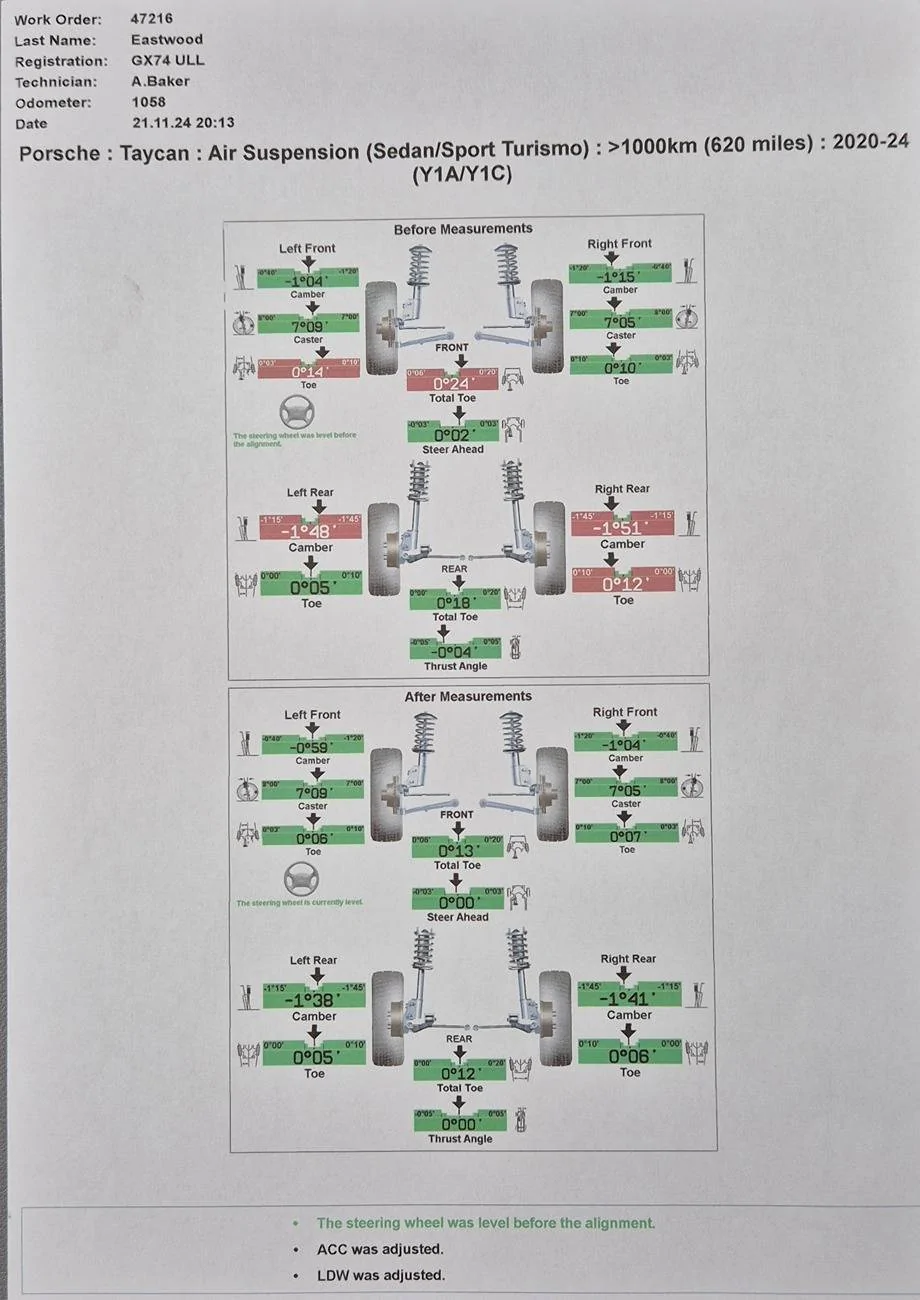

My 2020 Taycan went for it's yearly MOT at OPC yesterday and came back with this and the OPC never actually mentioned it...although there's small small icons under each tyre which I don't understand what they mean

That isn’t very helpful, you really need to know how far out the alignment is, particularly the front camber as that really needs the front bumper to be removed to adjust it. Ask for the actual values for each wheel. Camber will change slightly when toe is adjusted. See attached image, only adjustment was to toe but camber values changed too.

Our local dealer told us we needed new tires…three weeks after selling us the car as CPO. According to them, an alignment and recalibration is also required with tire replacement (all at Porsche Service rates, of course). I took the car to Discount Tire and they said, A) at 6/32, you don’t really need new tires yet, and B) there is no indication of uneven tire wear, so alignment isn’t necessary. One more reason to not trust most of what Porsche Service says (this one, at least).
Some further internet research says that recalibration is in fact necessary on the Taycan after you do an alignment. However, it also confirmed that there’s no need to do an alignment unless you see a reason to do an alignment (uneven tire wear).
If they sold you the car as CPO only 3 wks ago, I would demand that they cover the cost of new tires and alignment as those things should of been addressed during the CPO process.
