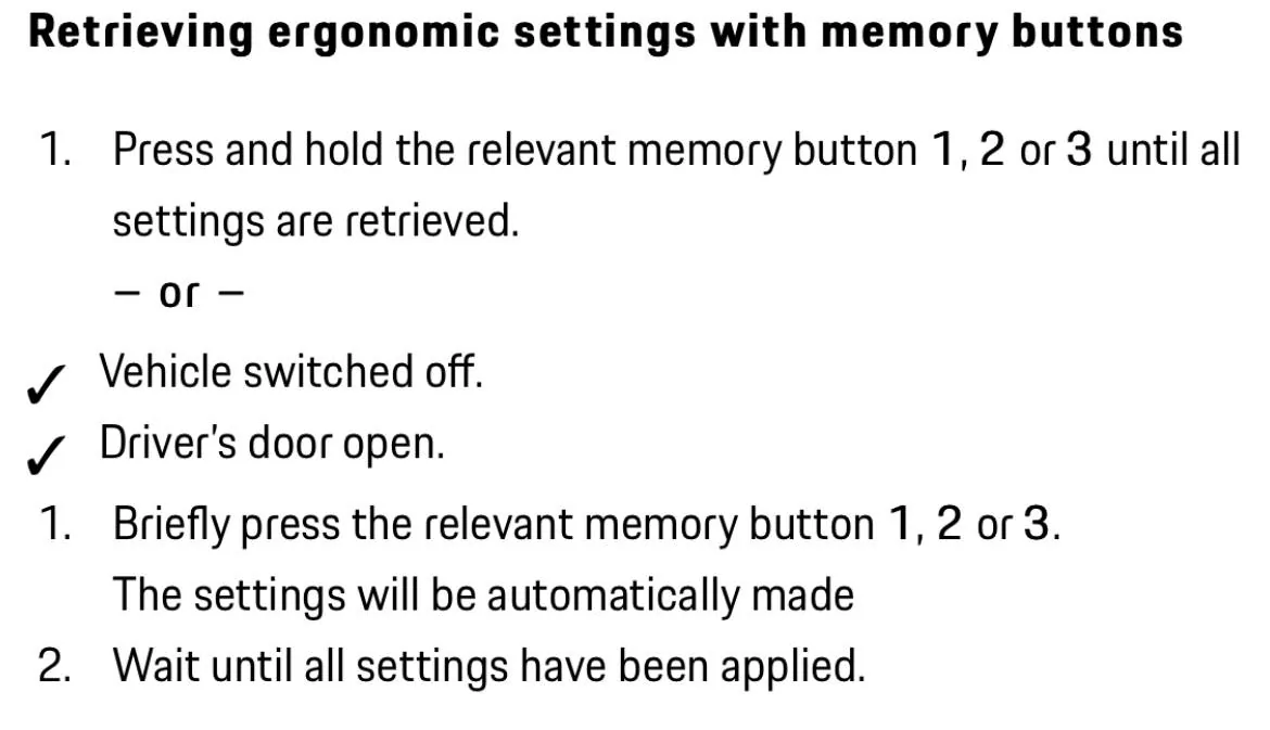

If I try to use the "1/2/3" button to set my seats to a certain memory location, I have to hold the button. If I don't hold the button until the seat reaches the "end", it will stop wherever it is at. Is this normal? Every other car I've had you just hit the memory button and the seat moves into position without having to hold the button.

If I press the button before I get in, it goes on its own.
If I wait until I get in and close the door, I have to hold it.

Try a quick press. Works this way on my 992 (pretty sure it was the same on my Taycan).
Check the manual too .
