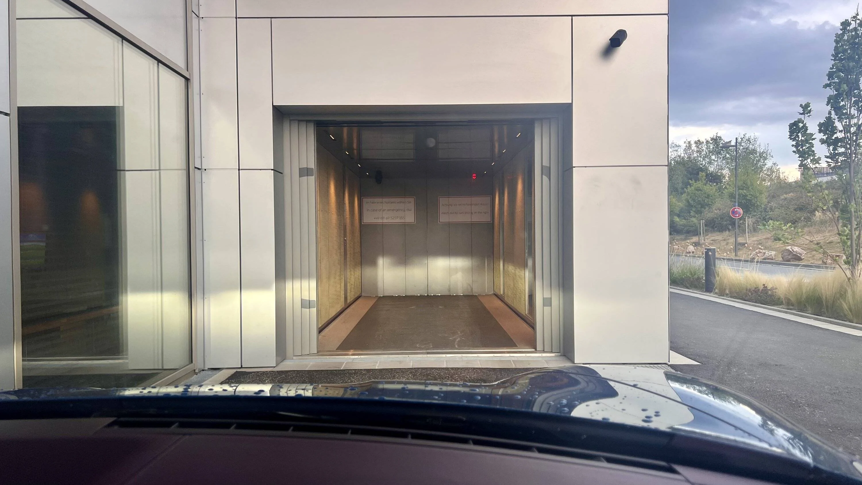

Only usable image will be from the front and rear camera.
With mirrors folded 1966mm width.
Line up with the side view to see the gap ahead on either side. Easy after that.

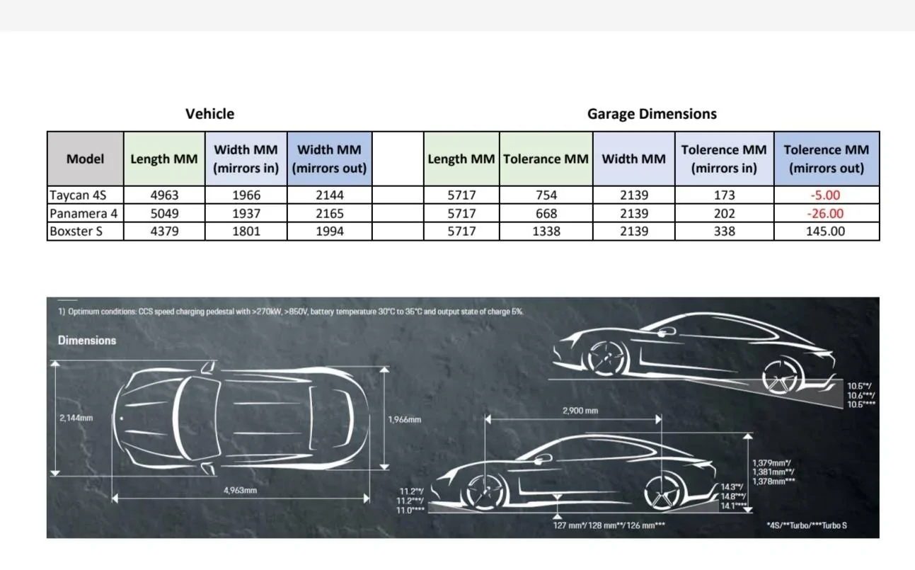

Some discussion of using garages with door frame widths of 217 & 218 cm-
https://www.taycanforum.com/forum/threads/minimum-sized-garage-for-a-taycan.9591/
Is your lift wide enough for you to exit the car?
In this lift you don't exit. You drive in, it takes you down, and then you drive straight out. Into the garage, which has a very large amount of maneuvering space.
I think with a ~ 35 cm buffer, I should be OK, now the concern is turning into the lift (it's on a small, very busy pedestrianized road in Central, and I'm going to look like a proper Muppet 10 point turning to get it exactly lined up with the lift.)
Yep, the added distraction and pressure of having to consider pedestrians can't be fun. Though hopefully you'll find it doesn't take that much manoeuvring, even allowing for rear-steer making the reversing trajectory less predictable (at least for me, after 6 months it still doesn't feel intuitive when trying to get parallel in very tight situations).
