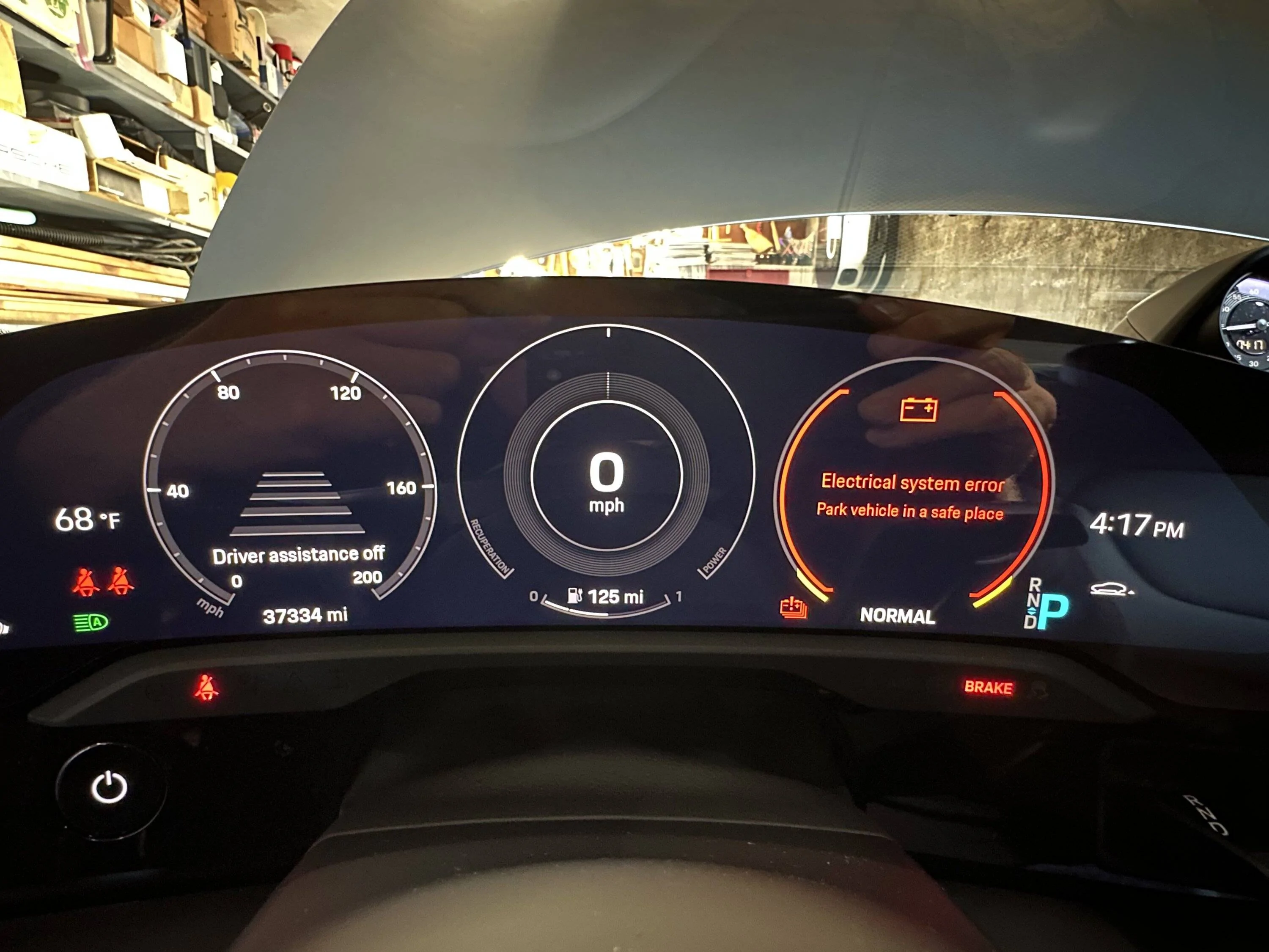

Dreaded Red Electrical System Error & Poll
