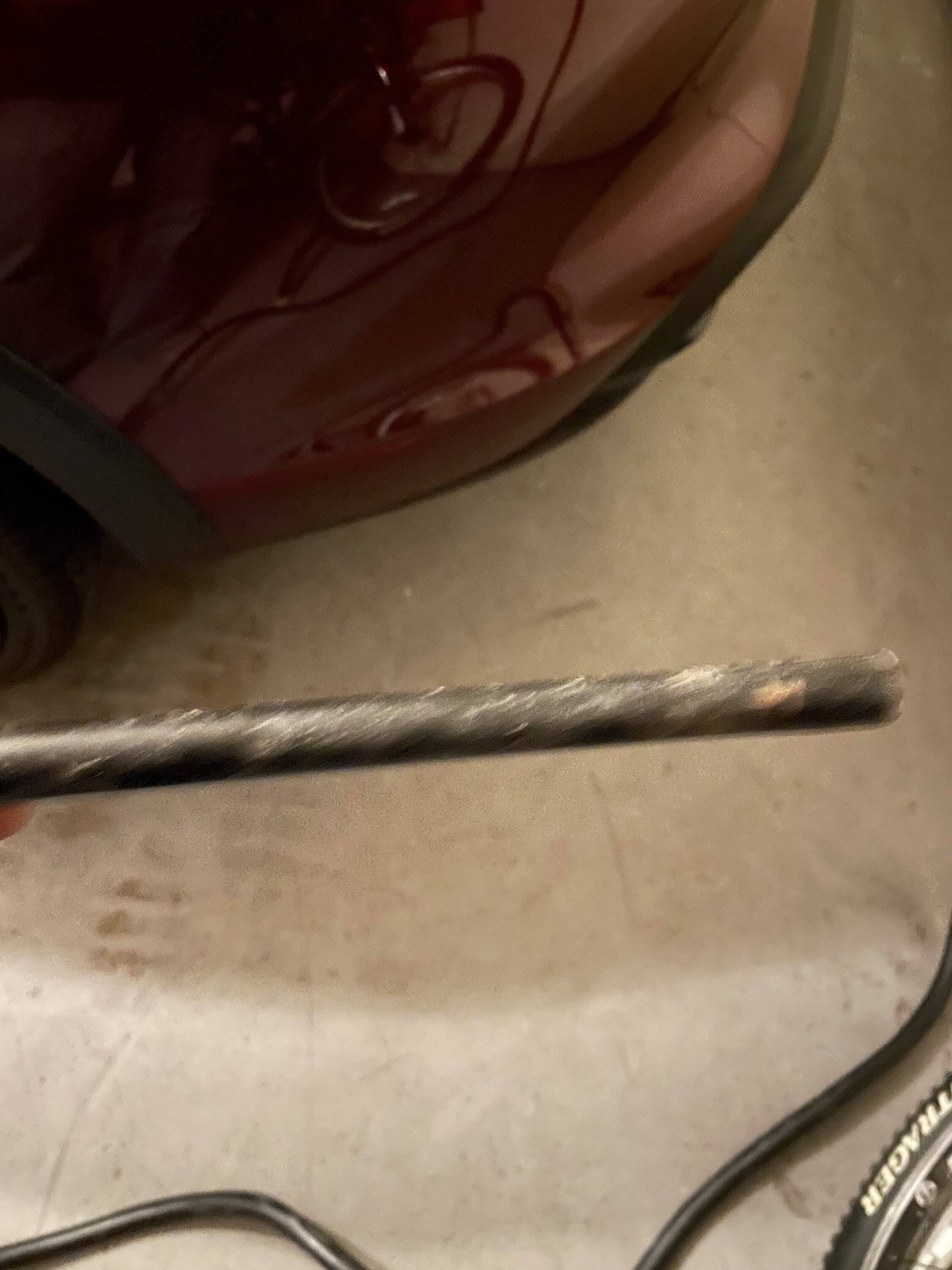

I specced power charge port to avoid this issue. That being said I found an iron rod in front vent. Glad it didn't hit front bumper or any other part of my car. During CA winter storm, I found all kind of debris there. It was pain to clean up.
I couldn't get the scale of that.
I thought it was lying on the floor at first ?
Then I just noticed your finger on the left!

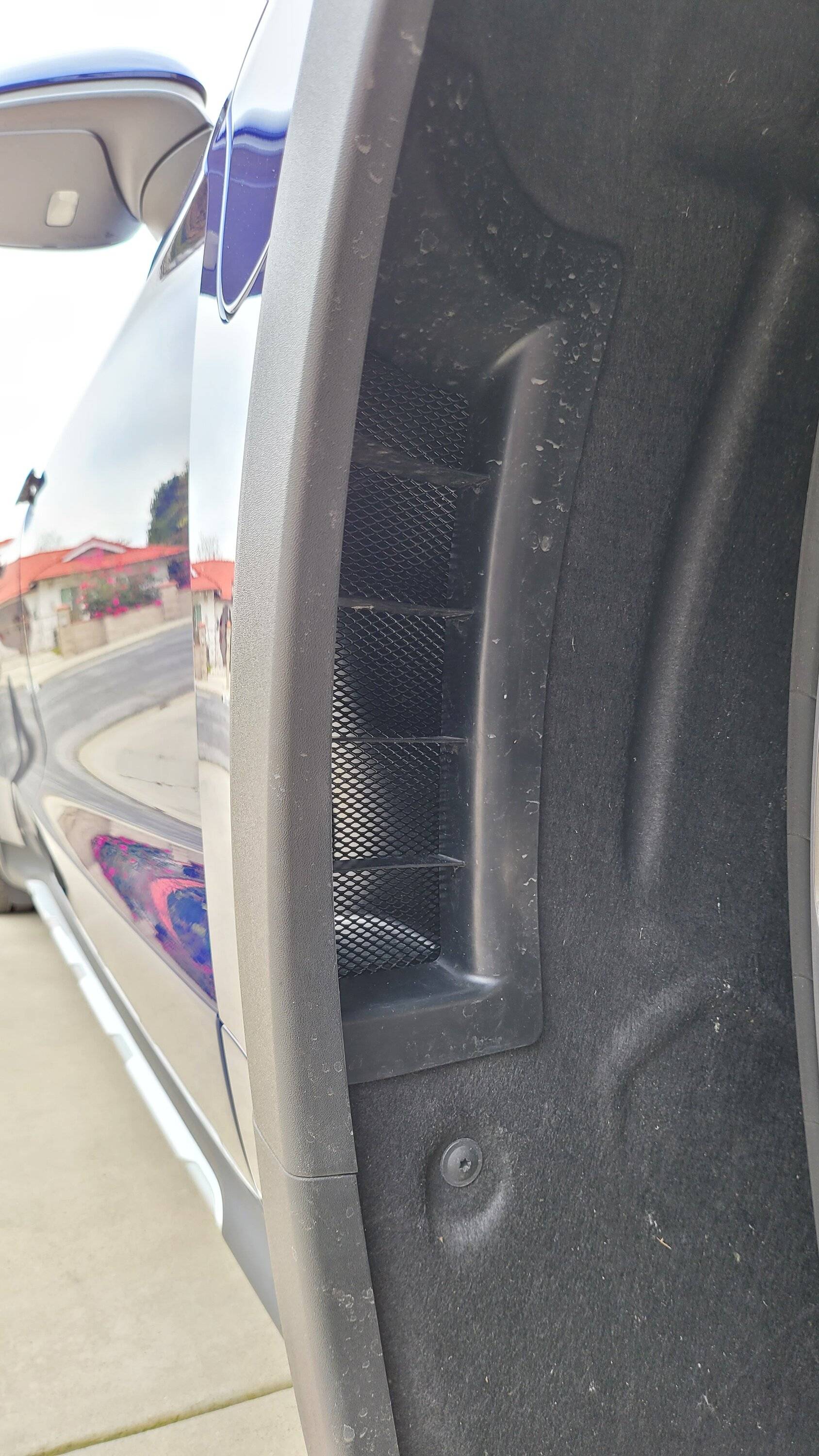

Great job. Any mesh will reduce aerodynamic efficiency, but not as much as the e-port's blocked off vent which Porsche think is acceptable. Have you noticed much clogging from debris build-up?
No clogging at all.
And range appears unaffected - but I think the concensus on here is that the vents would only have very marginal effect on range anyway.
Probably most at higher speed.
No idea if this shows that the vents do or don't let air through now??

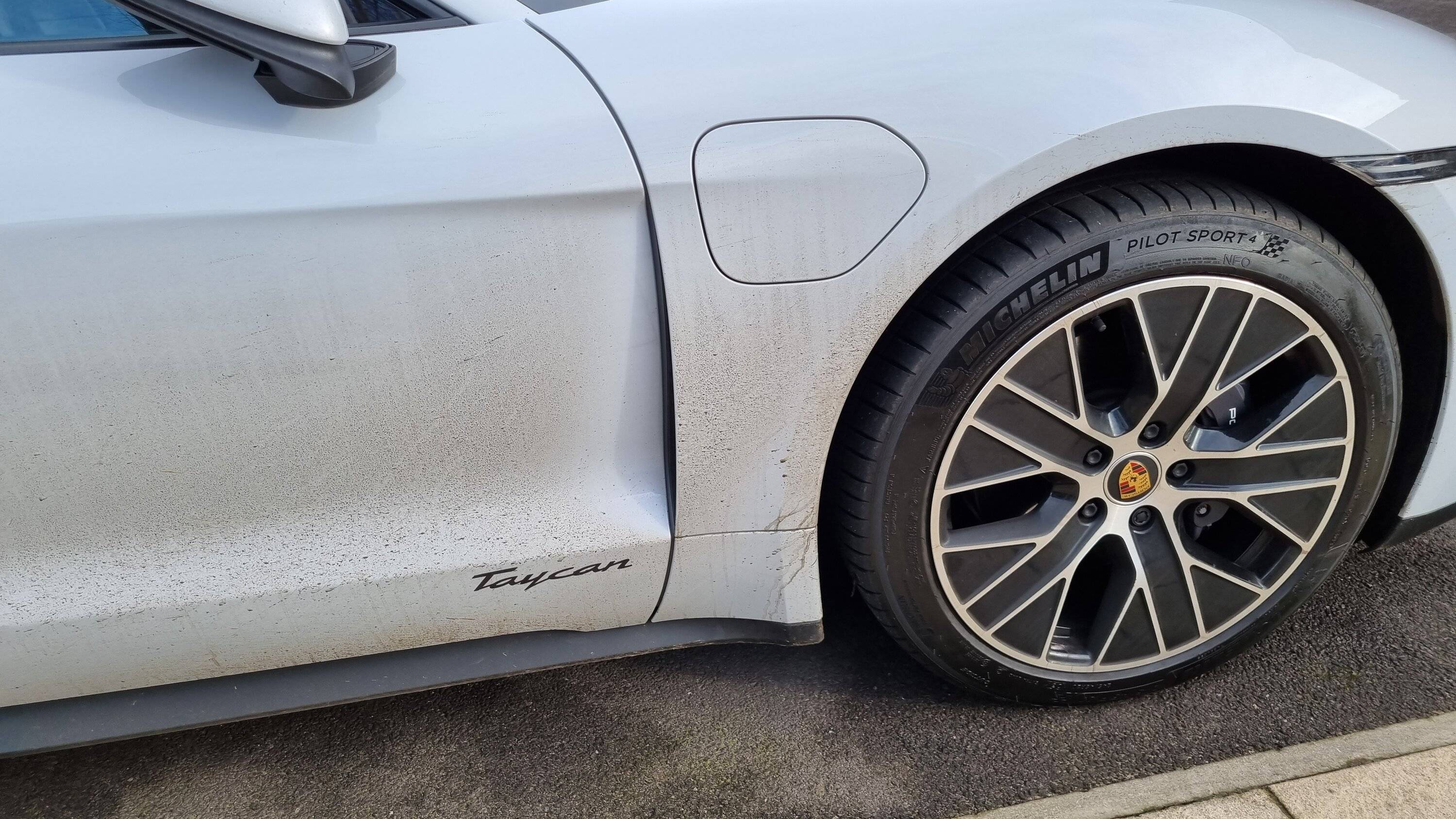

Interesting (idk but guess that does indicate flow through the vents)- you might have just started a new category of Taycan gallery. Pity I didn't photo mine the other day- it had dirty streaks running across most of the length of the front and rear doors- but I hate washing my cars so much I just wanted to get it over with asap.

When I looked into it I could see no direct line of flight from the tyre contact patch through the vent which could cause a thrown up stone to cause a scratch. In fact if you look down through the vent towards the contact patch the flight path would be blocked by the guide vanes in the vent.
I don't dispute a scratch, obviously, but can't see any way in which a stone could be travelling fast enough to scratch paint coming through the vent, certainly in my car. Certainly not thrown up by my own front wheel anyway.
I do get quite a bit of road grit carried by rainwater collecting in the bottom of the vent but no stones.
I am careful cleaning grit out of the vents not to scratch the paint myself.

The stone chip through the vent scenario is extremely unlikely if it’s even possible. I had a Panamera with the same vent geometry for years. While it was a stone chip collector for sure, it never damaged the paint…which is mostly likely why Porsche didnt add the mesh from factory.

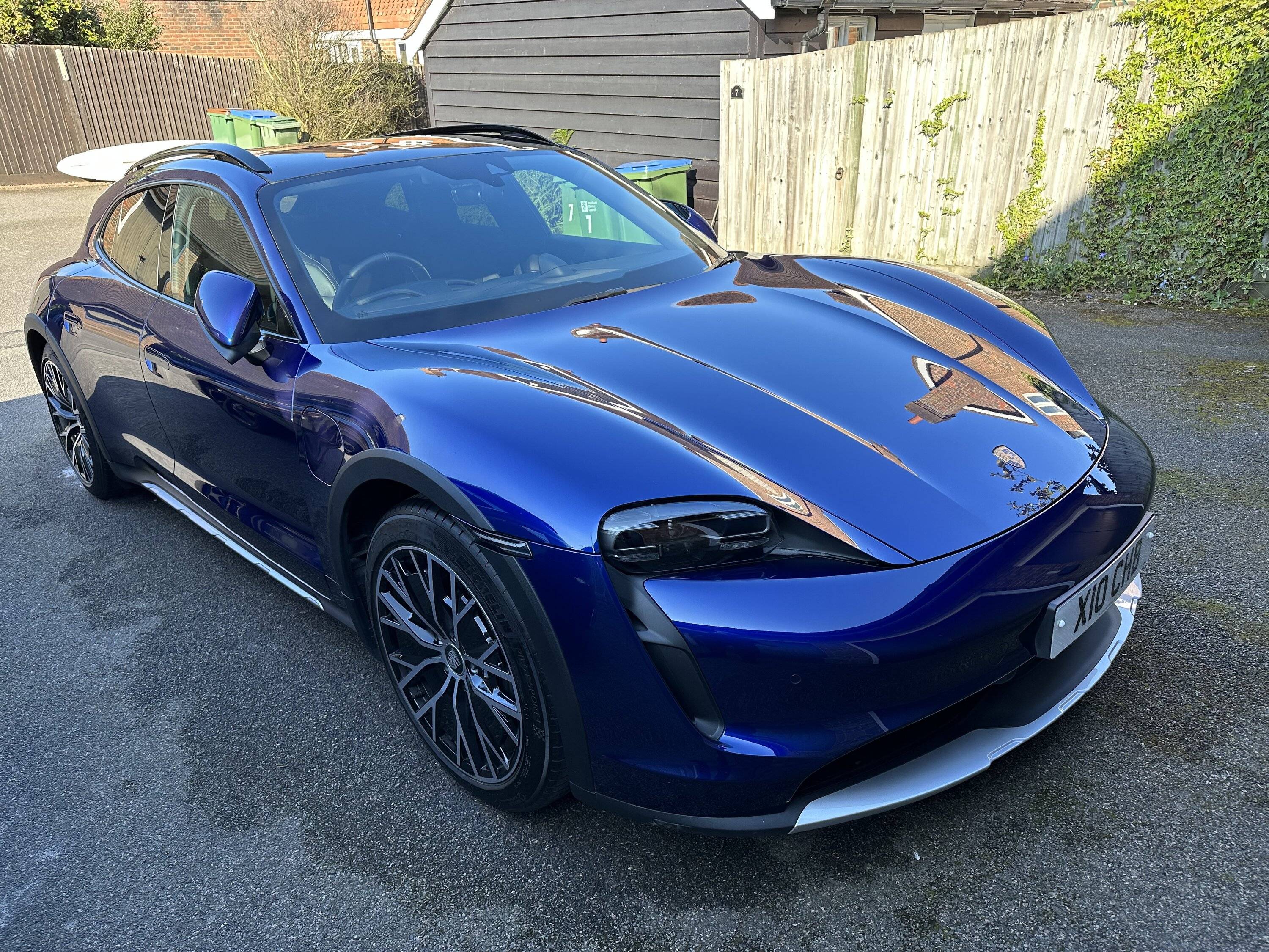

Well it happened - scratch on the drivers door courtesy of a stone from the front wheel vent. Luckily in this pic you can’t see it but I know it’s there

I don't think it will create additional drag to affect range but Porsche must have a reason to omit this from factory?
It will obviously produce some air resistance, but might be a compromise worth while for some.

I gave observed that cars with powered charging ports do not have vents in the wheel arch in order to protect the opening mechanism. Therefore any suggestion that blocking the vent will have a detrimental effect is simply untrue.
It is certainly aerodynamically worse by a small amount, putting a mesh in will be too.
The small aero loss is the price you pay for the (totally pointless IMHO) electric opening hatch gadget.
It is a choice, I went for aero efficiency since being an experienced vehicle aerodynamicist with 2 hands I am able to open the hatch and plug in the charger with zero inconvenience ;)

I saw a thread here on how to add a mesh behind the vent and I did that as soon as I got my CT. Did PPF on all 4 doors for good measure. I don't think it will create additional drag to affect range but Porsche must have a reason to omit this from factory?
I have tried to find the thread but I am unable to find it. I have found the mesh on Amazon and would like to know how to fit it. Can you remember where you found the original post?
