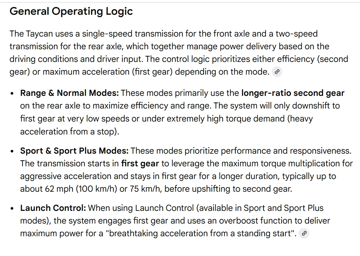

You can hear the "whine" if you accelerate in Sport/Sport Plus up to 75-85km/h (just before the upshift) and release the throttle (engine brake).
No, there is no whine whatsoever on cars without bearing issues.
You're probably talking about regen braking, that's a different sound.

If it changes / goes away when you go into 2nd then it's more than likely bearing noise.
That said, on my CT it was in first gear between 20-35 km/h and in 2nd gear between 50-70 km/h.
I think on the sedan there is a different speed - it depends on the wavelength and the distance between the front and rear glass in the car at which speed it's going to be most noticeable.

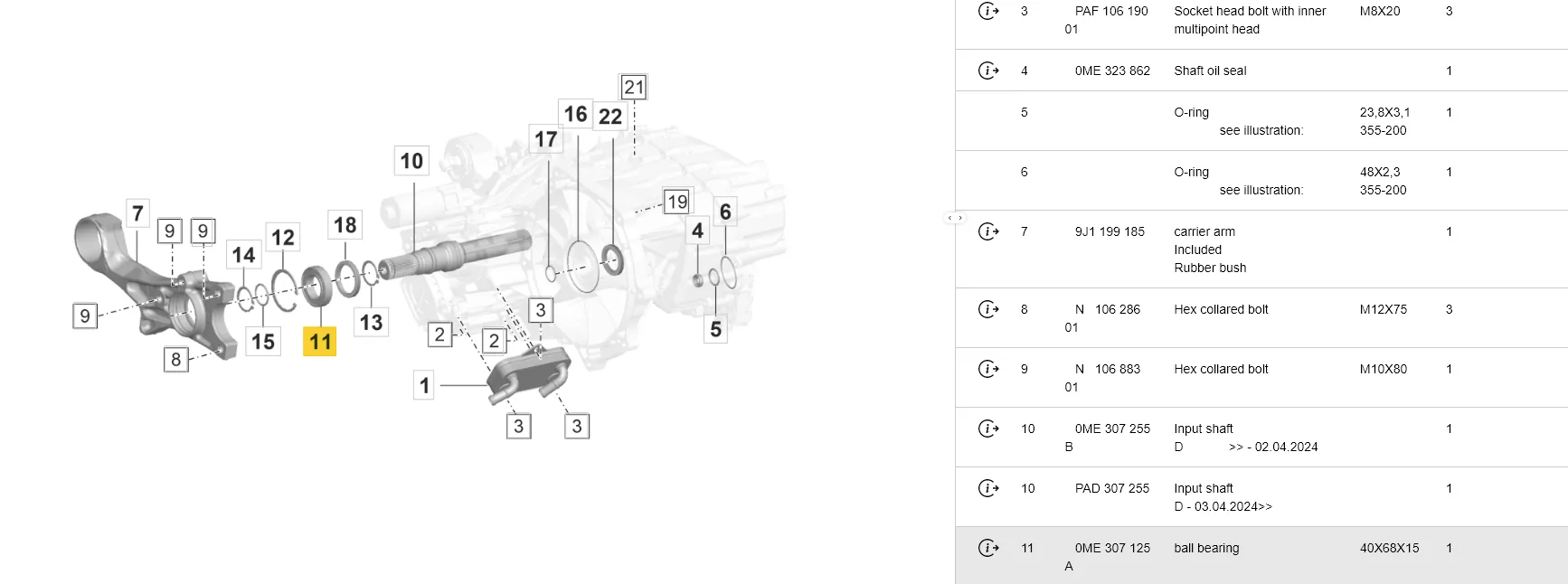

This fault for the gearbox is just the input shaft bearing. You can buy it from Porsche or also because they actually used a completely standard bearing you can buy it aftermarket.
Porsche's solution is to replace the gearbox because probably they just bill that to ZF. And it's not Porsche who made the mistake here but ZF. At least they didn't use a special custom made patented bearing, that nobody can produce or sell to drive the repair price to astronomical level like VAG did on the MEB platform and Kia/Hyundai did on the e-GMP.
But apart from dropping the rear axle being a big job the fix is actually quite simple. You just change the bearing, and that's it. So I would not say this is a huge problem. At least when the car is out of warranty then this can be fixed by almost any decent shop.
For the front on the older cars (pre-facelift) there was TSB, if you have a pre-facelift car then your dealer should already know what to do. On my CT they fixed the noise from front under Porsche Approved because it's a manufacturing defect and it affects almost all the Taycans. There is a fixed part.
