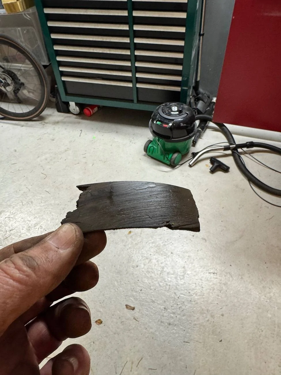

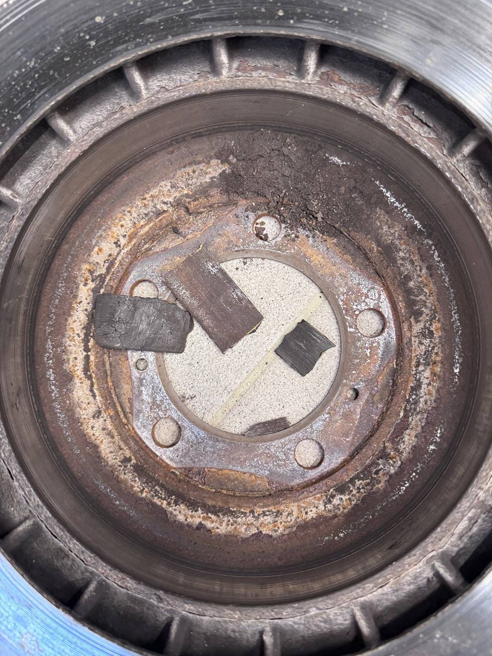

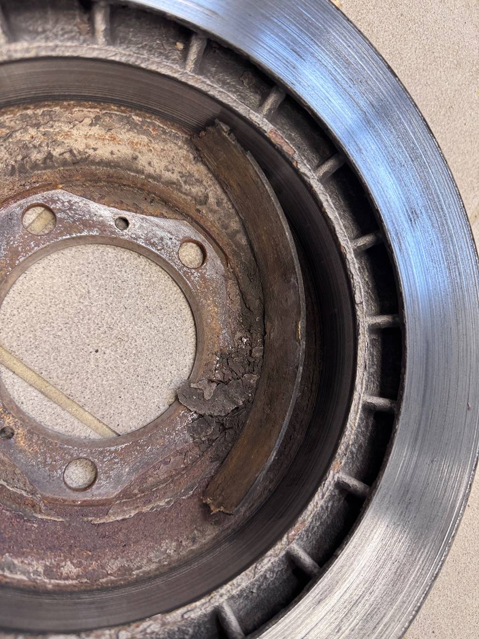

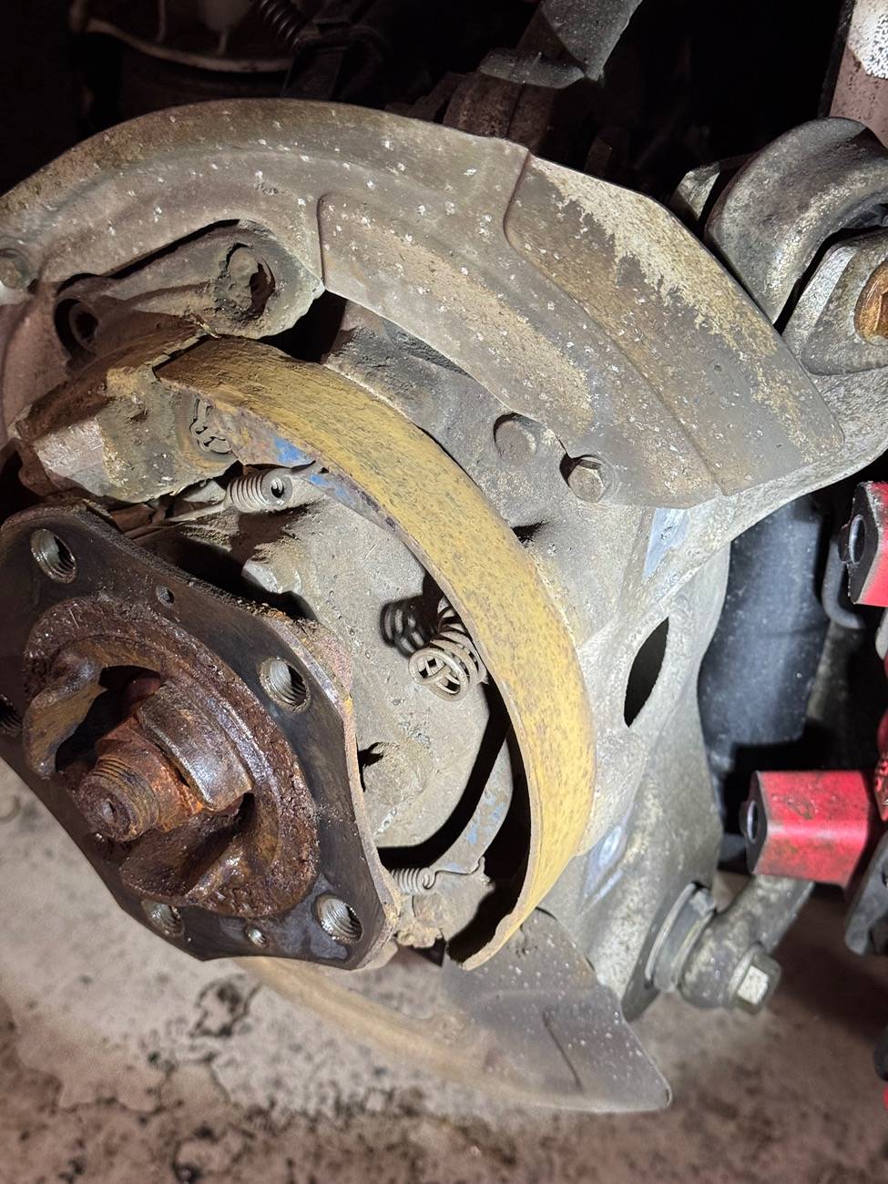

I started getting an error message for the E-brake on the dashboard. It suggested calibration but it did not work out so I decided to open the brakes to see what's going on.
This is what I found. One of the brake shoes had lost its friction material almost completely. I expect it had separated from the metal part due to corrosion.
Easy fix and not a costly one since the shoes are like 40EUR / set and 1,5hours of time. The drums are 210mm in diameter so the shoes for 180mm drums that some websites suggest won't work.

It could be that the pad holder(s) got stuck and rubbed against the drum (is there a drum?) and was worn out due to driving.
Did you check for smooth play of the system?
Yes, everything was smooth and nothing was stuck. Just bad quality parts and harsh weather conditions combined. I also had my front window lifter wires rusted away at 3 years old.

Almost like mine was ? In pieces inside the brake drum

I think eventually with enough rusting going on between the friction material and the brake shoe itself the structure gave up when the e-brake shoes got stuck due to minus degrees and moisture on the drum. That was the last straw and ripped the friction material off from the rusted shoe.

I just replaced the shoes and it was ok when the thickness was restored on the shoes with new friction material. Nothing else was needed than the 30EUR pair of brake shoes to repair this issue in my case.

The drum size (at least on steel brakes) is 210mm so when you are buying the brake shoes please take this into consideration. For example on Panamera 971 the size is 180mm and they WON´T fit.
