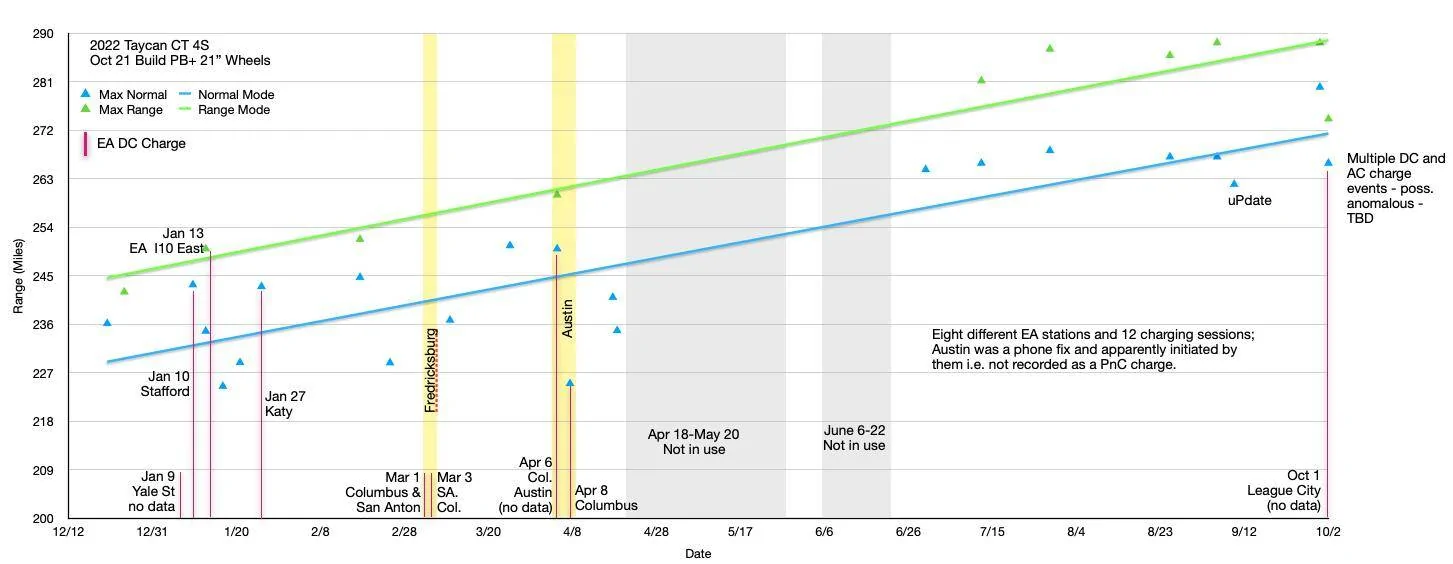

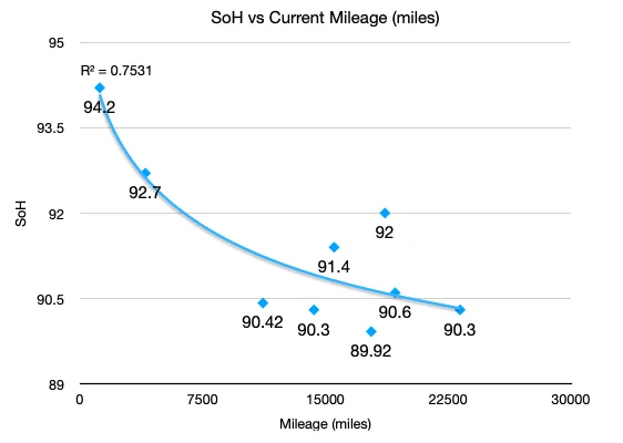

I was tracking my range SoH and mileages separately to SoH and kWh's.
Here is an example of my charging (DC and select AC) and PCM range estimates wherever I had recorded both max. predictions in Range and Normal mode - had not documented net battery add vs charging station input. If I had actually planned to be more rigorous I'd have a lot more pertinent data :)!!
The SoH data are from my and other users OBDII readouts (includes model year, model etc).
